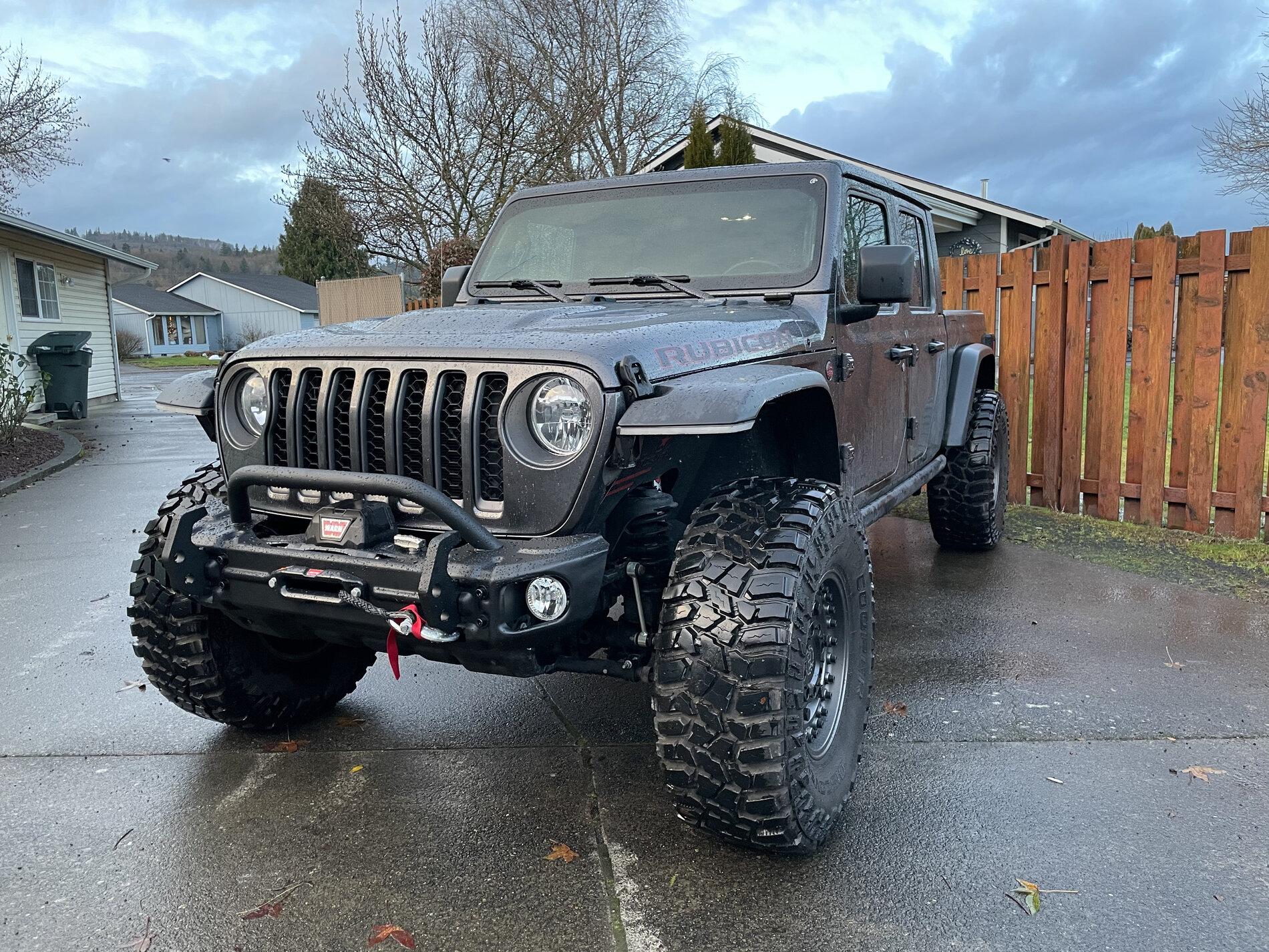

Curious where your mpgs ends up with 4.88s. I installed 37s on my JTR at 415 miles and my best mpg has been 16.5 at 70. My normal around town, back and forth to work seeing 13mpg. Ive long thought that with some minor performance enhancements this thing would be able to hold 8th longer and get much better mpgs. You proved it. I just ordered the Mopar CAI, AFE filter and the AWE Exhaust. Can’t wait to see what gains I get if any. Not sure yet on the Pulsar. I’ll post my results here to keep it in the appropriate thread.
