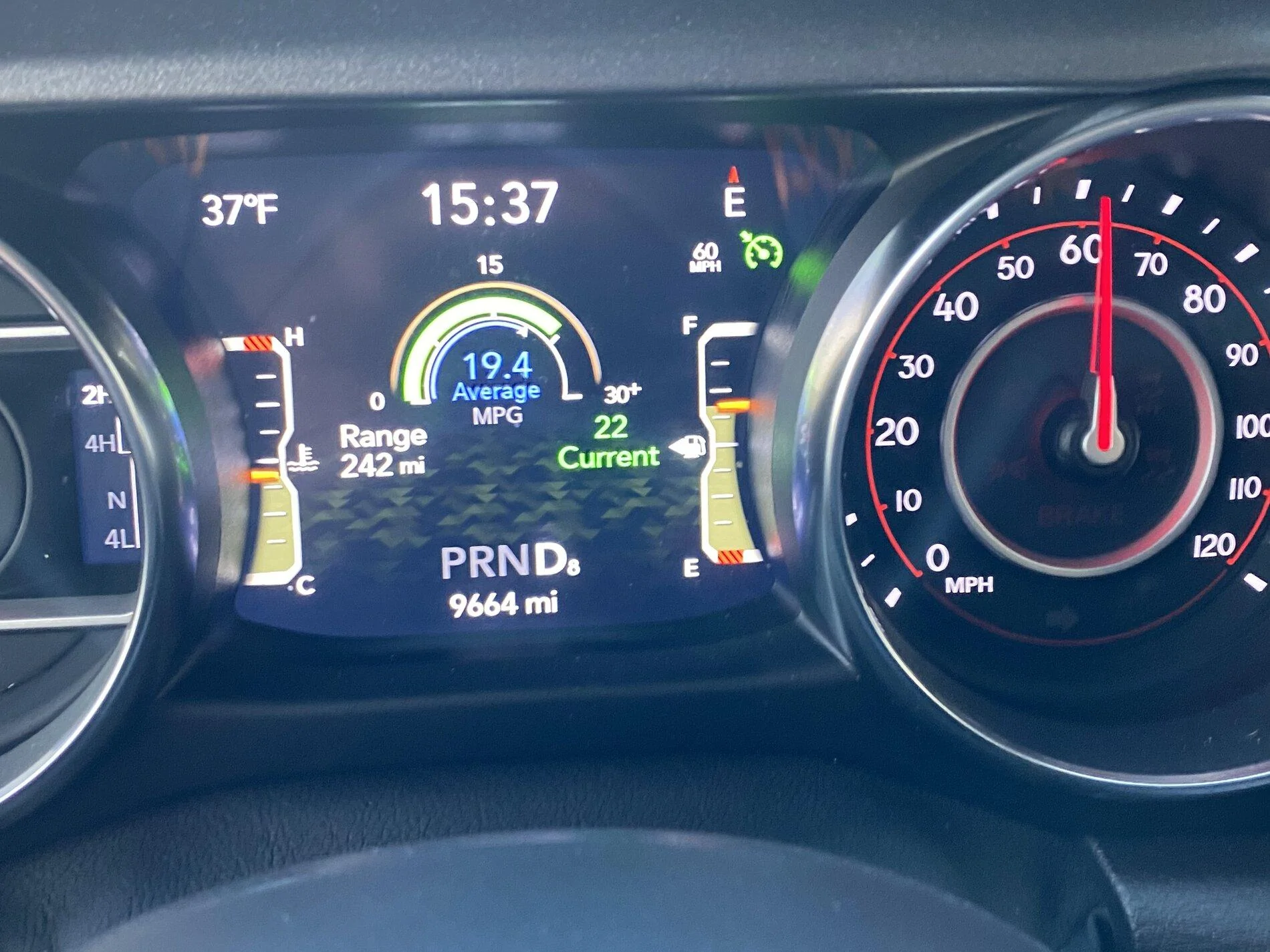

I think the extra air drag from the lift impacted more than i would have thought. Weather conditions today arent for a perfect run; but Id guess its a 1.5-2mpg drop. Also currently have 400lb of cargo and in rolling hills.
