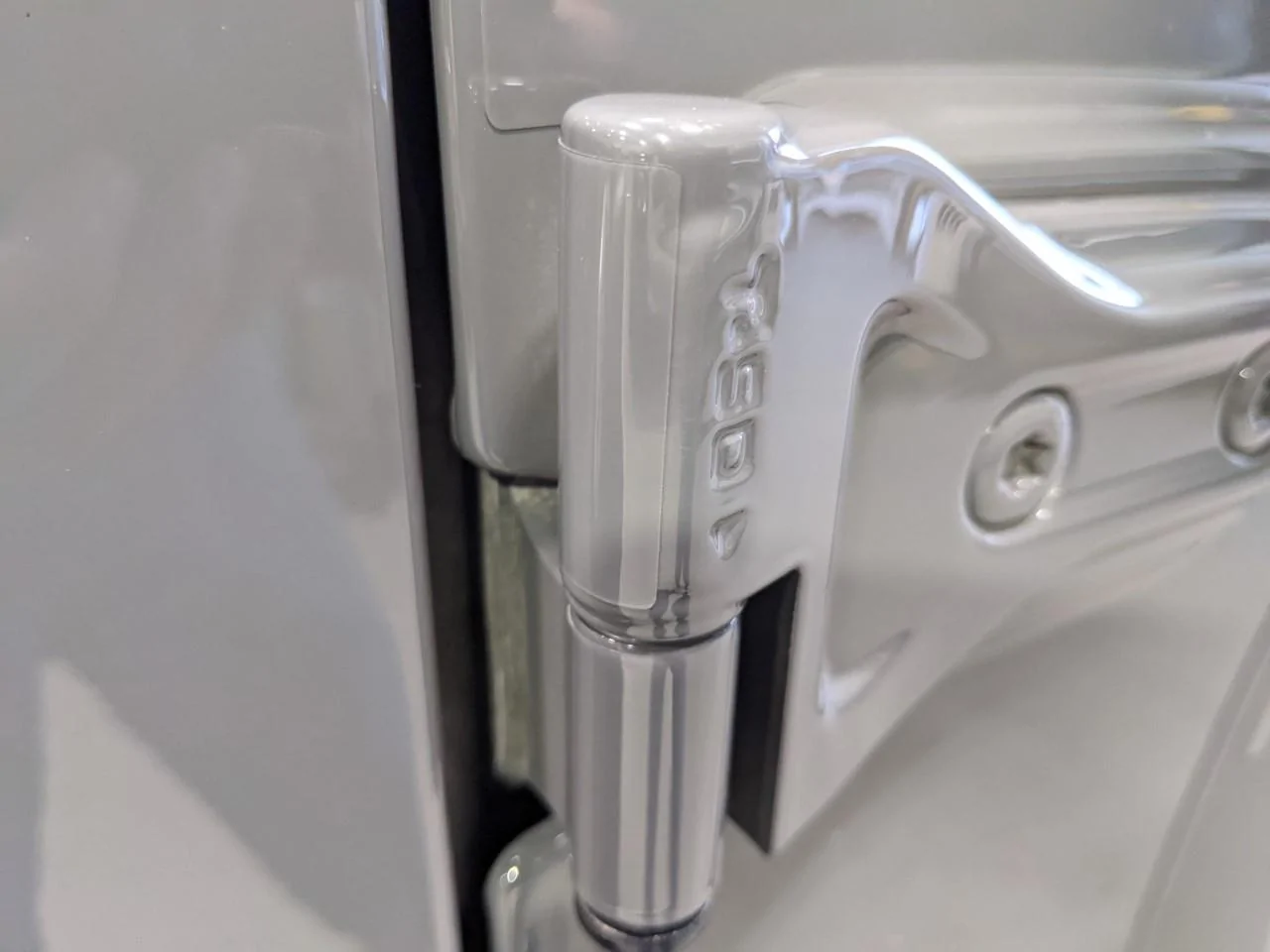

Ouch!! After seeing this, I made some PPF hinge protectors for mine. At least it will help some. I had already done the rest of the truck... overkill, I know, but that is what we do at my shop, lots of tint and PPF.
Is this the 3M film? If so whats the application process for pieces that small? I watched some videos on people using all sorts of solutions and squeegees but was hoping for a section this small it’s just clean area and stick.
That’s what I did. Nothing fancy, just cleaned the area (post touch up paint) and stuck it on. Made a crappy template so all would be at least similar shaped/sized. Haha. Works well, even though I have already beaten up one of them to hell. Need to re-do that one.
Thanks. It looks like you just did a small rectangle to protect the front of the hinge only? Seems to me this would be the only vulnerable area anyway. Rather than some that are covering the entire hinge.

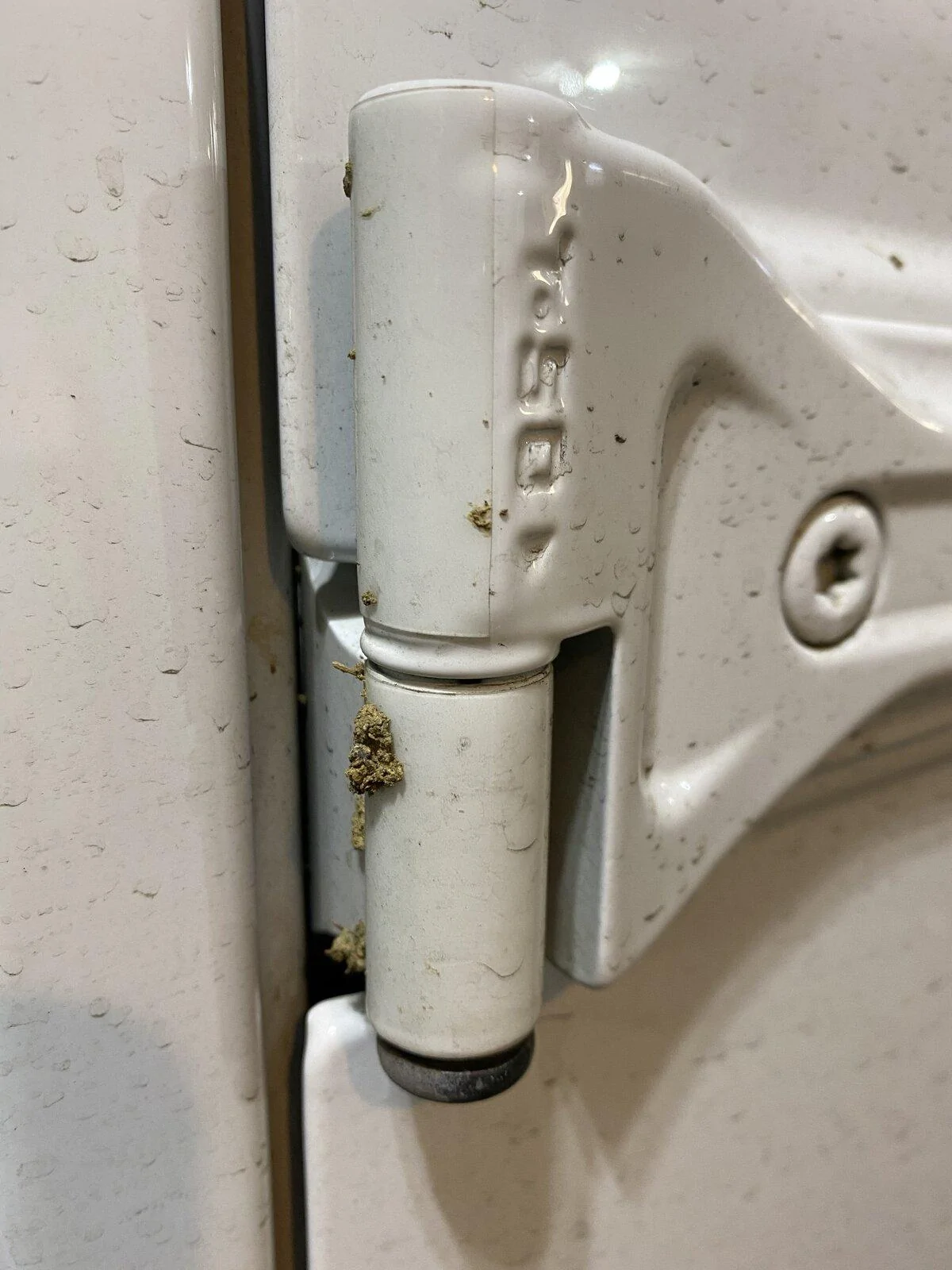

Yup! That is definitely the hot spot. Here’s a pic of mine:
Jeep Gladiator How to Protect Against Paint Chips on Door Hinges? A7F8F2B4-E1C3-48AE-A1E7-1FE419CB89C7
The bottom wraps most of the hinge and the top is just the front. Seems to do the job though.
Awesome. Thanks. Just ordered some.

I just did this tonight. Make templates and start cutting. I just use sharp scissors. No need to mess with soap and water for these pieces. Just don't touch the sticky side when applying or you'll see the fingerprints. Peel the backing back about halfway line the edge up where you want it. Stick and peel back the rest of the backing and stick. It's super easy. Most time consuming part is tracing and cutting. Have fun.
Mine are Xpel because that is what we install at my shop, but any good PPF will work fine. You already got some good advice on install... super easy. Misting a little water on the area will make it easier. I also did the RokBlok mud flaps on the front. They make a huge difference.
