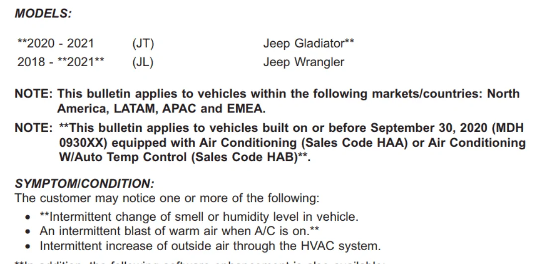

I know there has been discussions on this but mine seems unique. 2022 Mojave, I started using heat in the vehicle due to cold weather but the driver side stays cold until I crank it to max temp, then I bring it back down to say 70 and blows cold, passenger side works fine. Tried in either auto or manual, synched or not the issue remains. Worked fine last year. I could bring it to dealer but they can’t even put air in tires so there’s that. I could not find any info related to it searching TSB’s or any forums. ??

https://www.jeepgladiatorforum.com/forum/threads/hvac-tsb-update-issues.50241/
