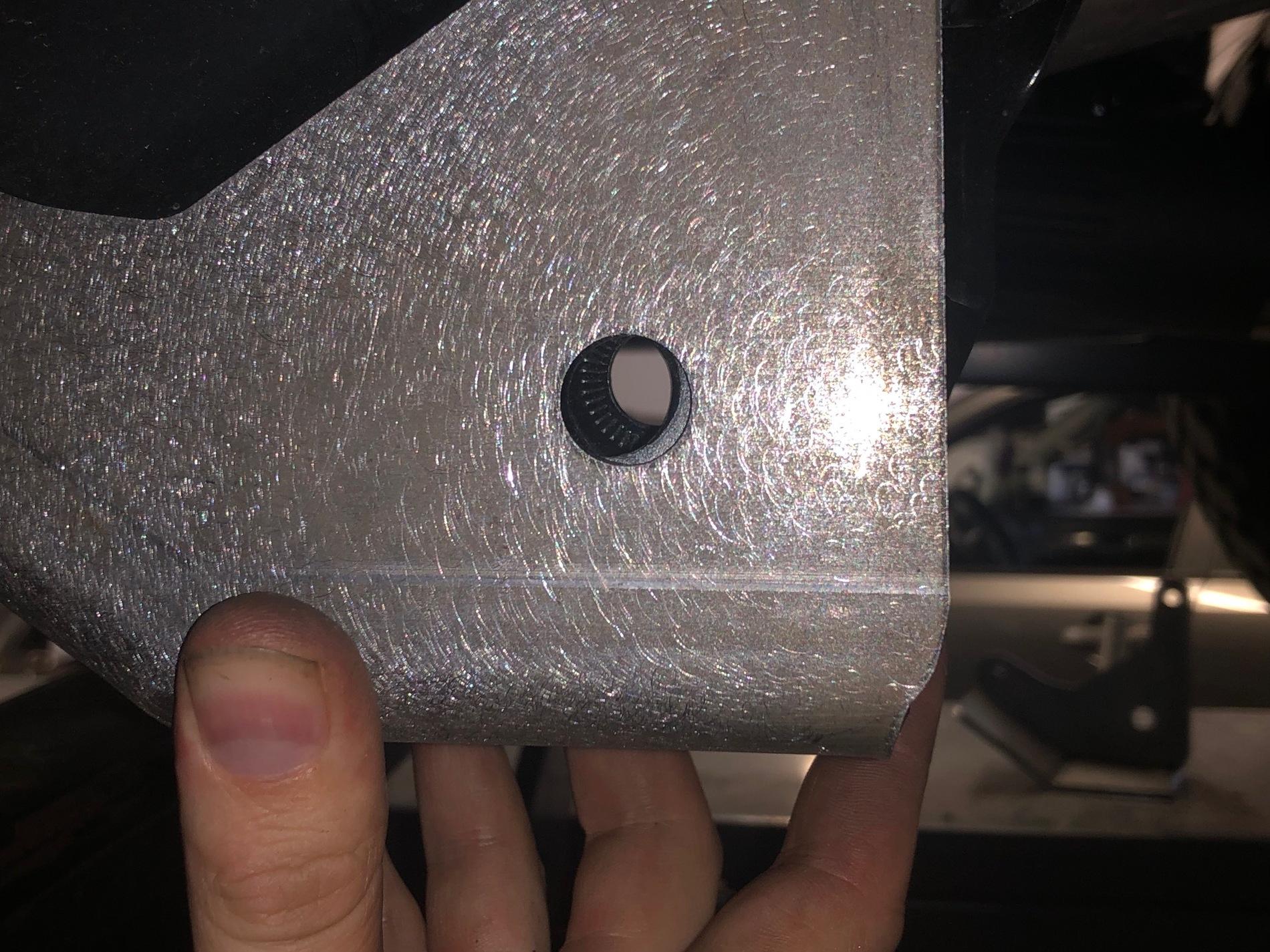

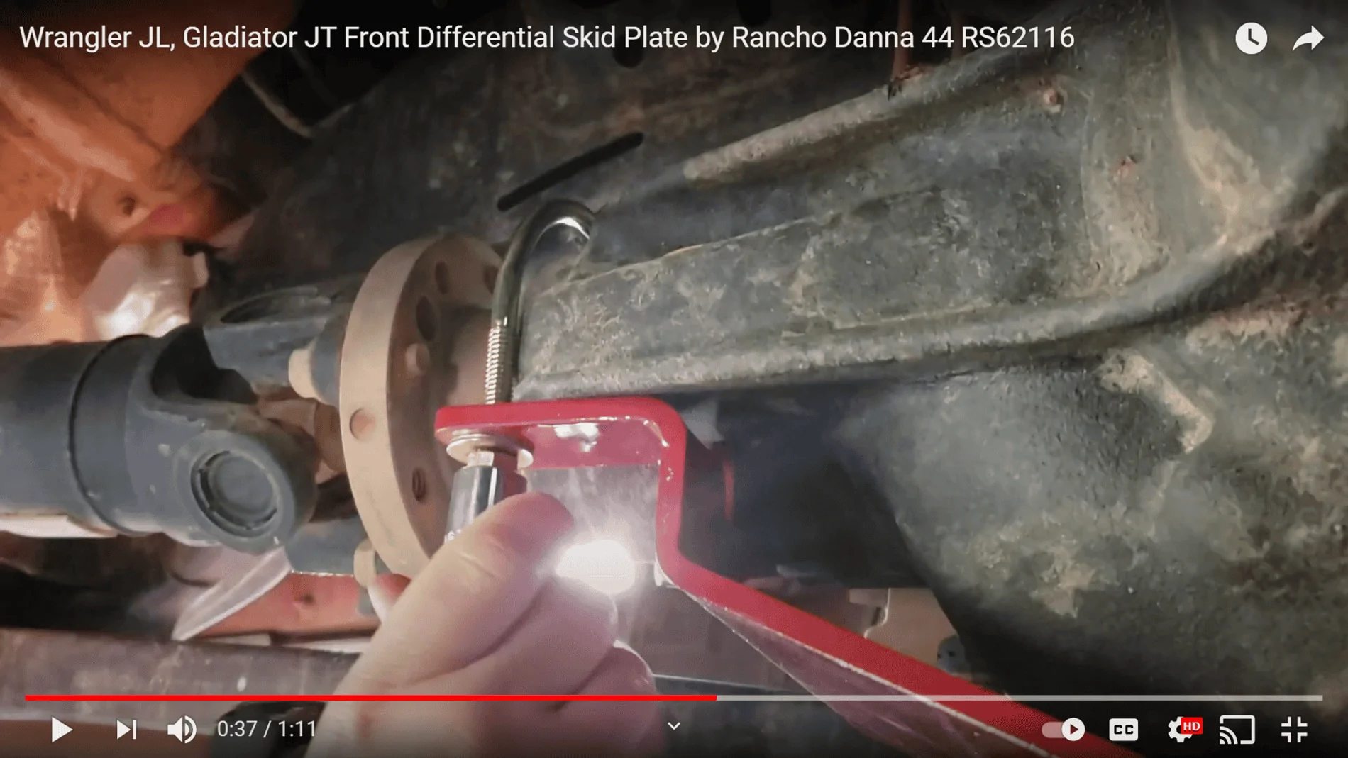

Sorry for the confusion with these pics. The rear looks like it will fit just fine. These are additional pics of the front glide plate. Either Jeep changed the front axle (my Rubicon is a 2019) or the radius of the Rancho glide plate that fits around the rear of the differential has been changed. After watching the Rancho install video and some other installs on YouTube, the glide plate radius fits nicely around the rear of the front differential, and the tabs that the u-bolt attaches to is up against the webs on either side of the differential.
