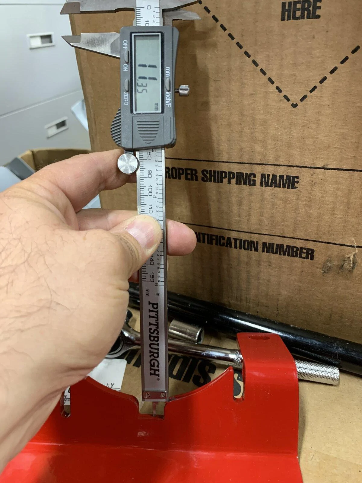

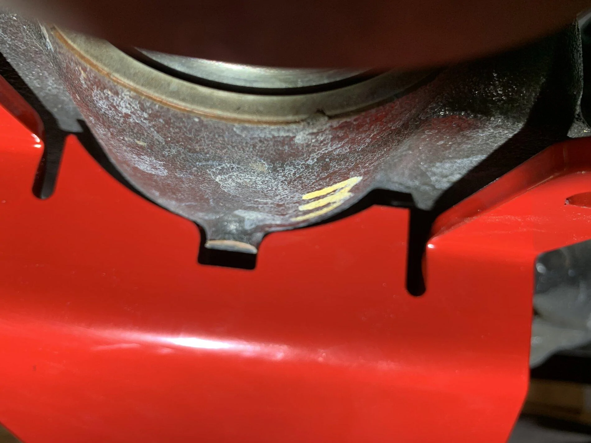

@RanchoShocks I wish I would have seen this post yesterday (Iā€™m on the Wrangler forum), maybe you could have helped resolve my issue. I bolted up the front glide plate and was about to install the u-bolt and found it to be way to short. Contacted Rancho tech support and they said they had no fix and to return it (returned yesterday). I think the problem with mine was the radius of the glide plate that fits around the back of the differentialā€¦ only 2 tiny points of contact next to the little skid notch not allowing the skid plate to be pushed up. Iā€™m sure I could have made it fit by grinding down the radius but didnā€™t want to ruin the powder coating. Do you know if there are differences in the radius cut in the front glide plate? I really like it and would get another if I knew it would fit better.
Post #19 looks like it has the same fitment.

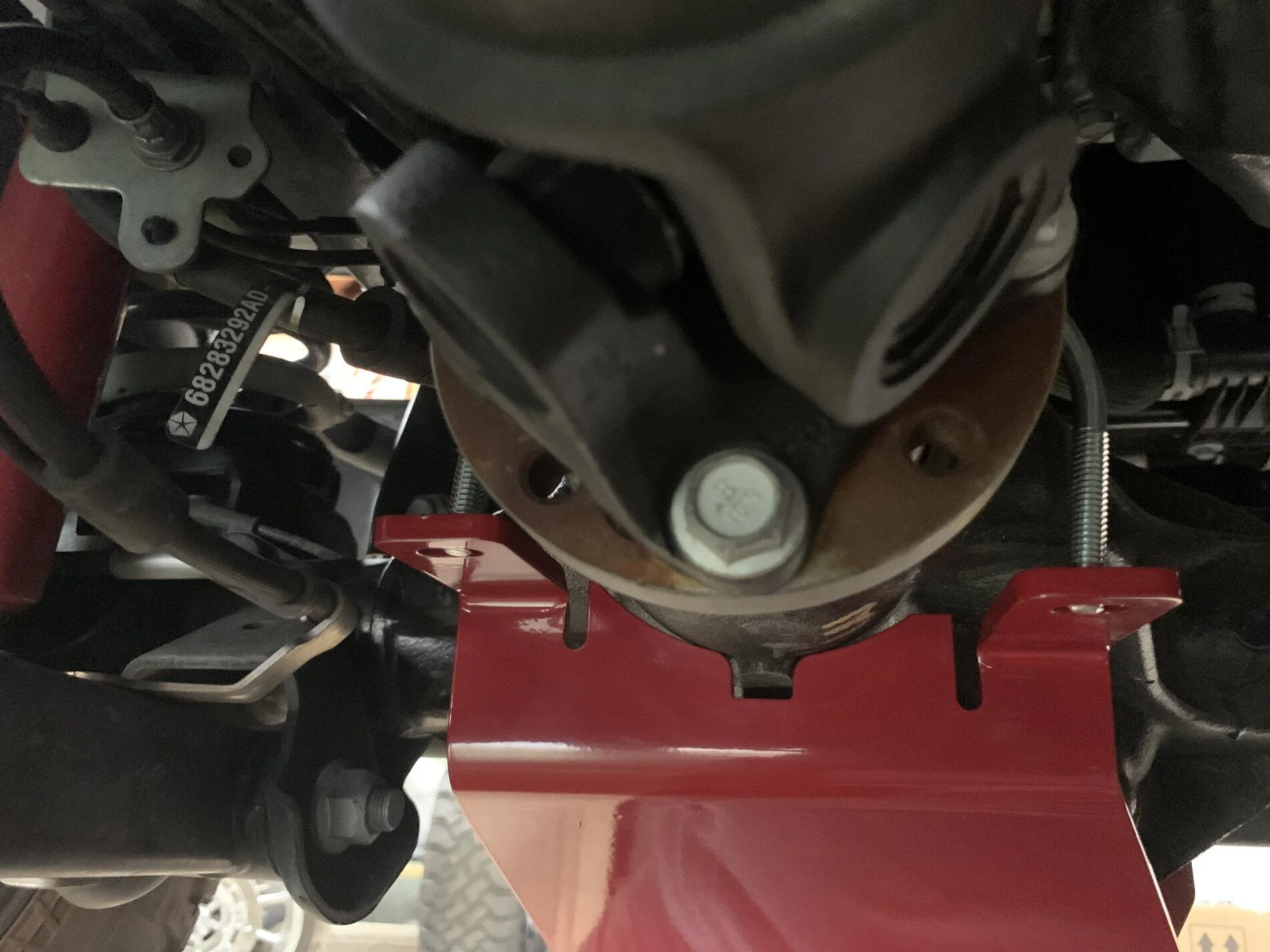

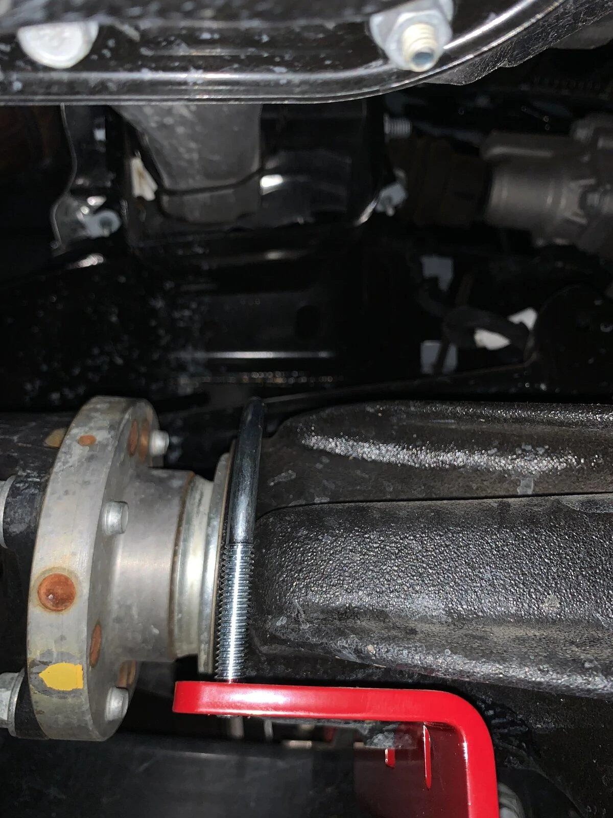

Jeep Gladiator I am 0 for 2 trying to install skid plates A3912725-E8B9-4F1A-8C9F-A96C98F264B9

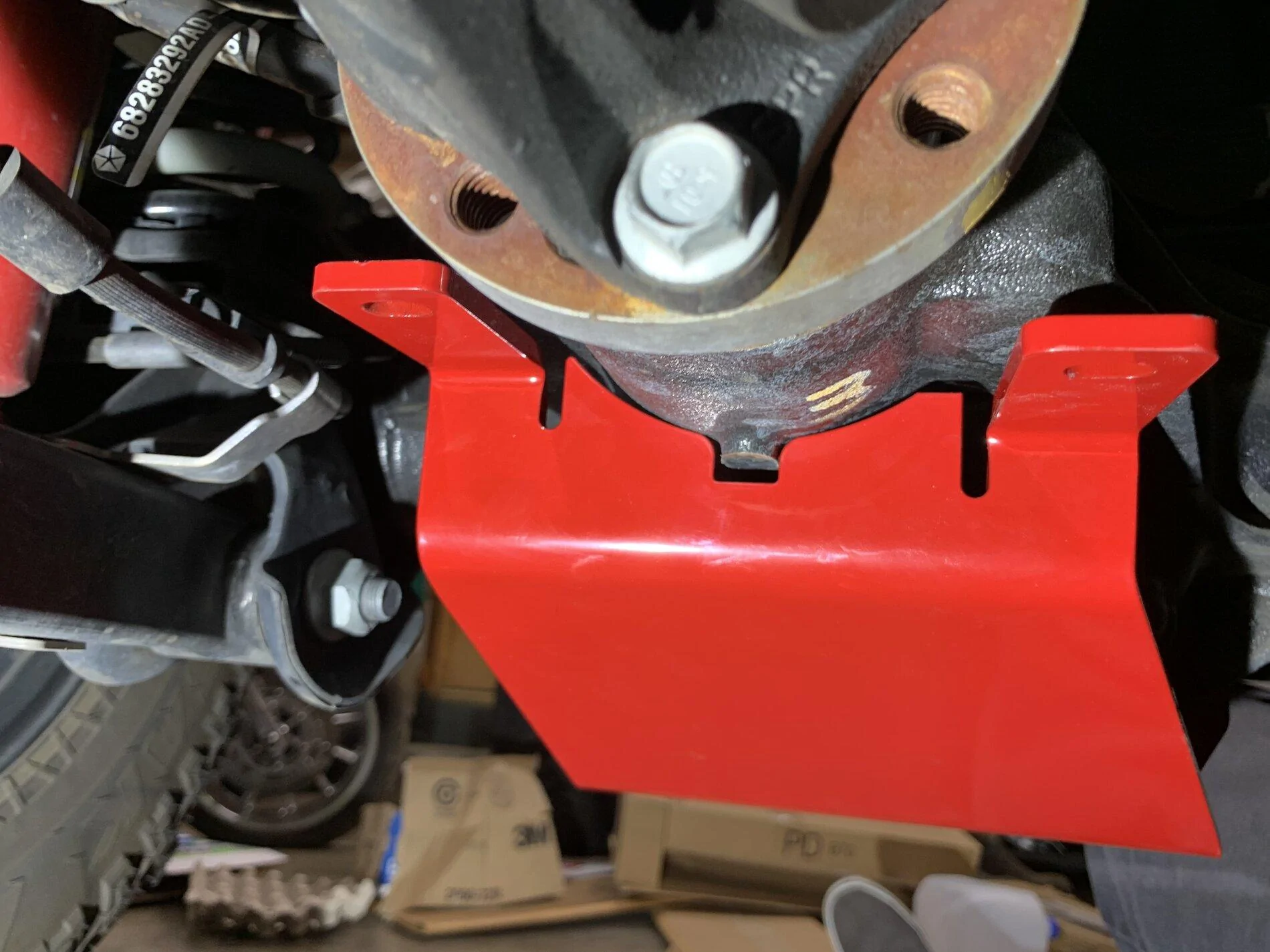

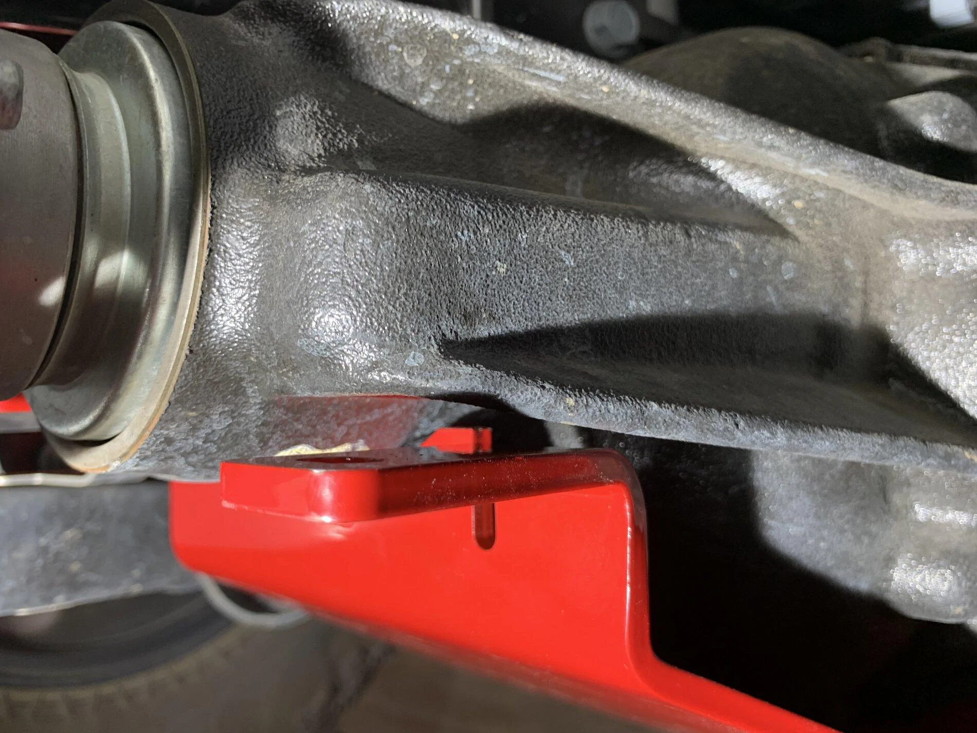

Cool ! Thanks. Just received my rear glide plate today and not sure if I should return that since I donā€™t have a matching front. Hereā€™s a couple more pics to share with Tech.

What is the part number on that rear by chance?
Front is good too.

Jeep Gladiator I am 0 for 2 trying to install skid plates A2459B18-BA1D-4F17-8FC8-A7BB08CF1F0E
