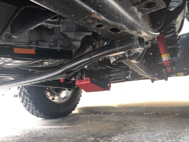

I’m having the same issue with the front Rancho skid. No way that clamp is going to work. I’ve e-mailed Rancho Tech Support and they have responded by telling me to start one side first and then the other. It doesn’t work LOL! It needs a longer U bolt. Still waiting for their response to the issue.

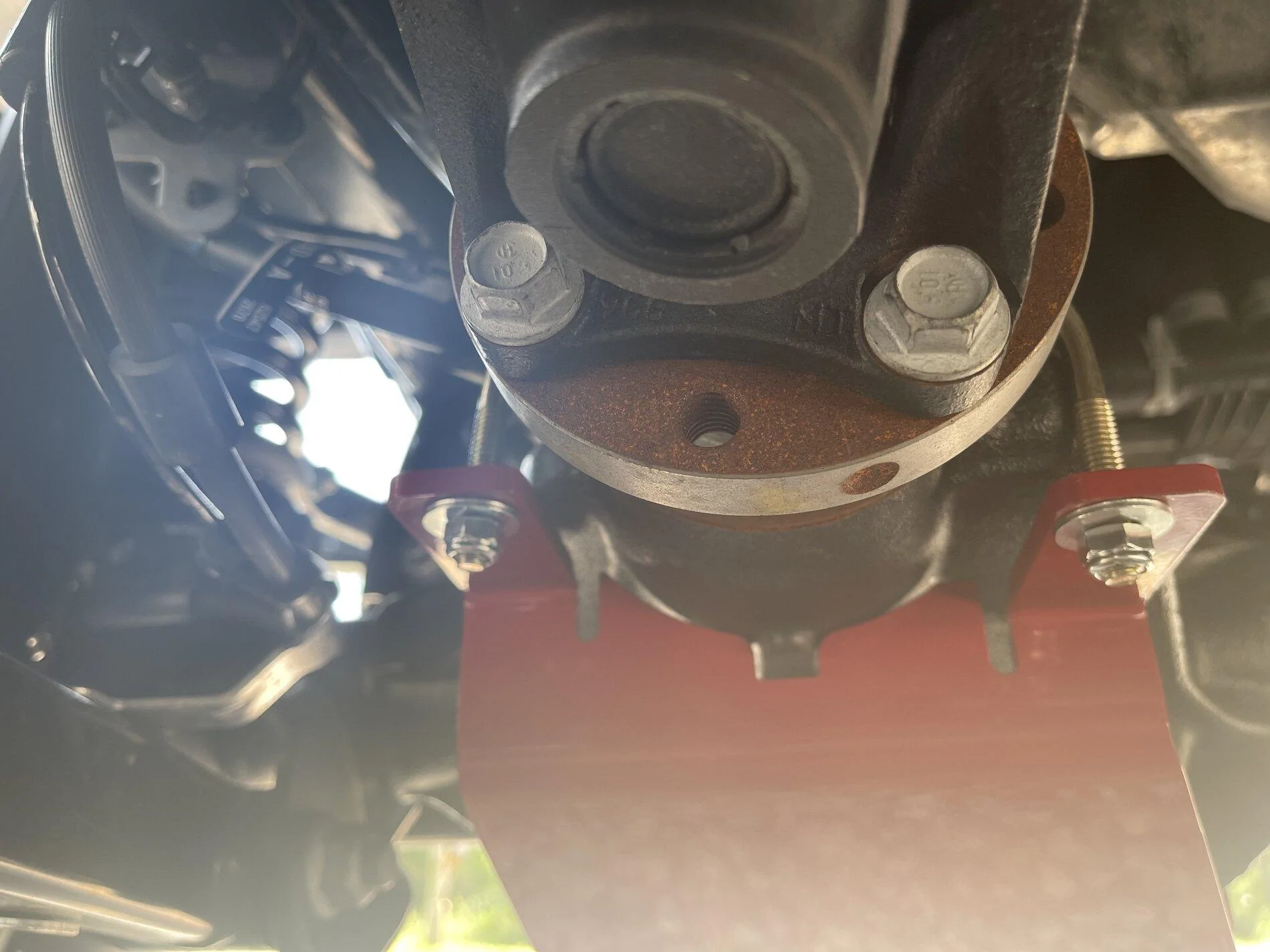

I received a longer U bolt via UPS. Thanks to Matt at Rancho. Everything is good to go.

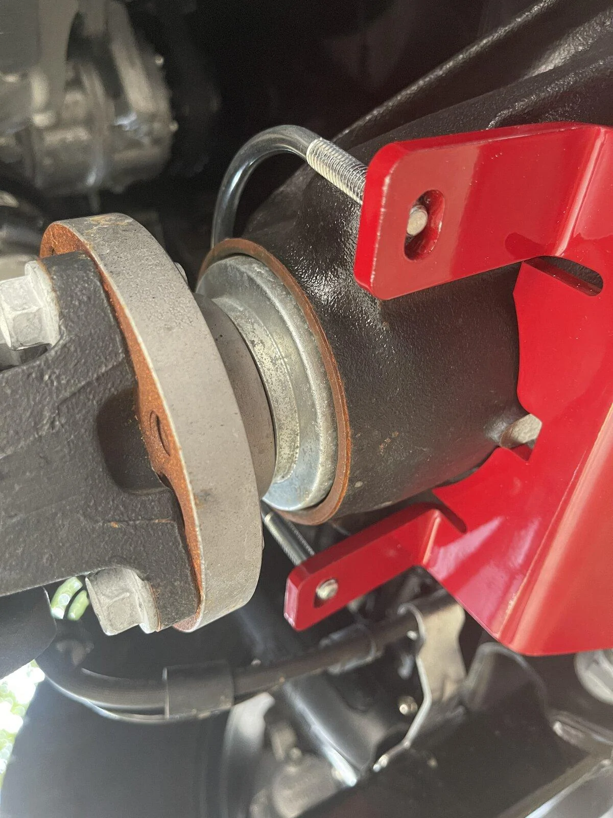

I also had the short silver u-bolt for the Rancho front diff skid that I recently purchased from Northridge 4x4. I contacted Rancho tech support via their website and they sent me a longer, goldish (zinc plated?) u-bolt. I was then able to install the front diff skid.

Suppose I should update that the new U bolt Matt sent me worked like a charm.
