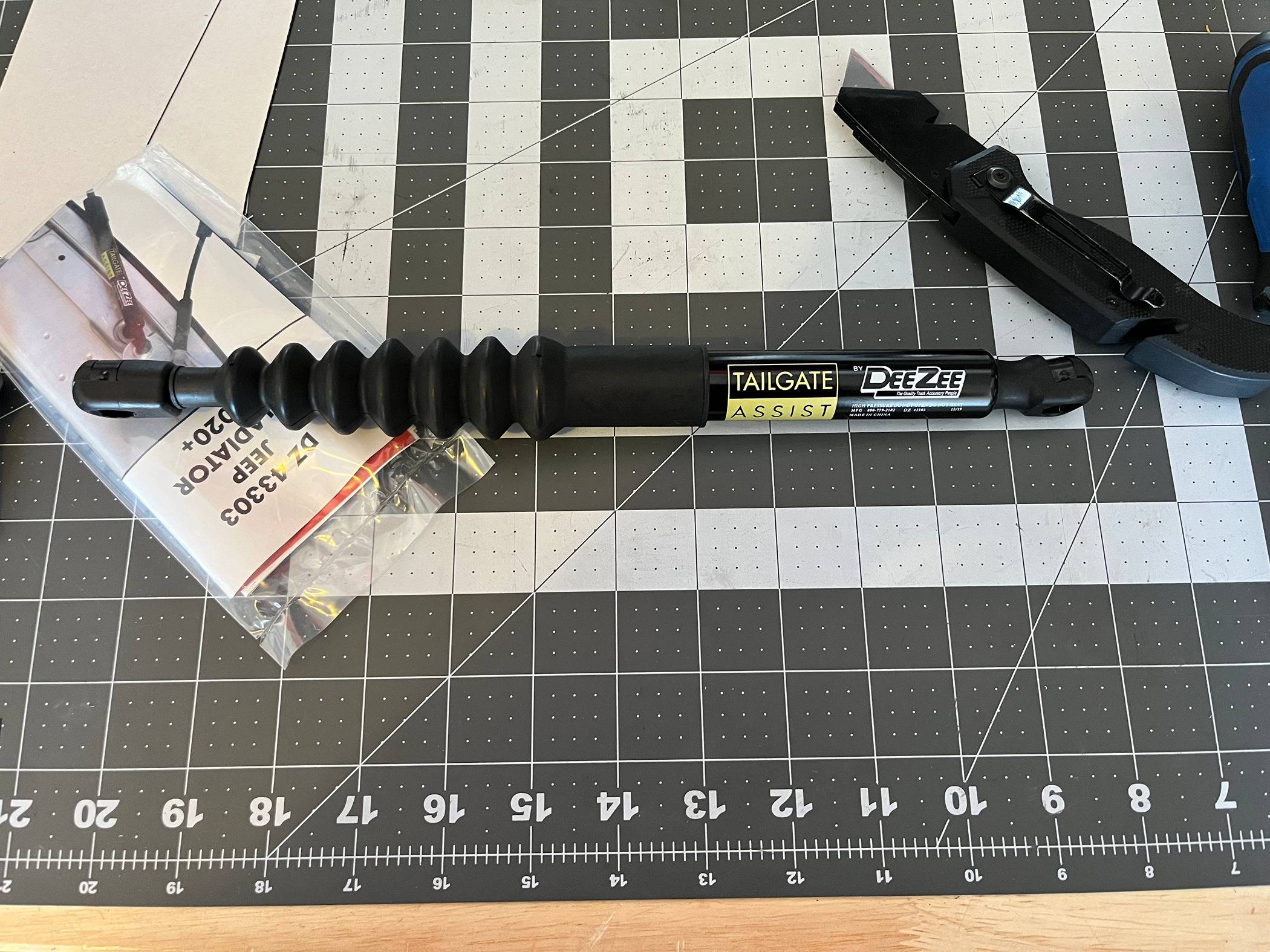

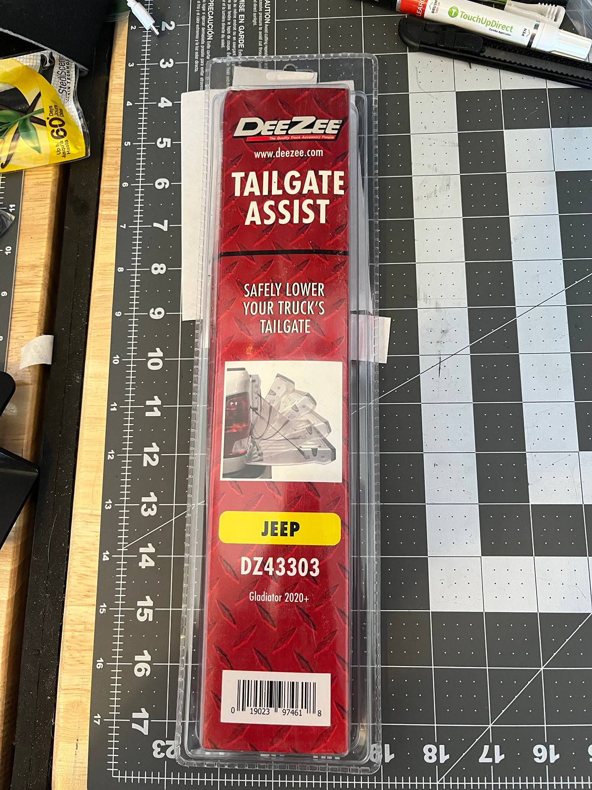

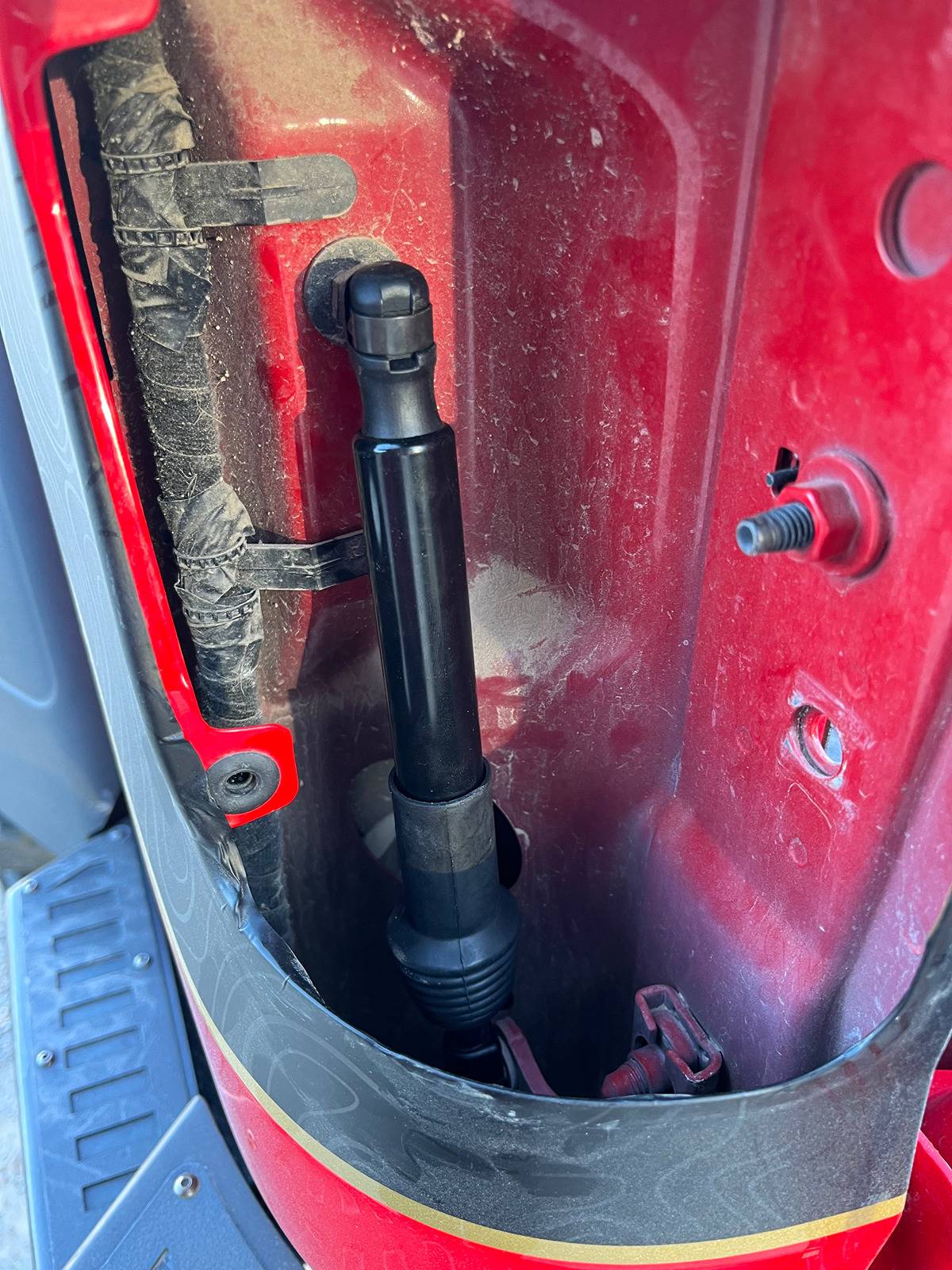

Update 3/15/2024.
Fixed the tailgate hard dropping issue. For once, it was actually easy. I decided to try my luck with a drop in replacement, a DeeZee replacement strut, on the bet that it would be stronger.
Jeep Gladiator I cut a giant hole in my tailgate! Reaper Off-Road Tailgate Box install and write-up. img_9379-
Jeep Gladiator I cut a giant hole in my tailgate! Reaper Off-Road Tailgate Box install and write-up. img_9381-
Took 5 minutes to install, and my flat working area is already being useful.
Jeep Gladiator I cut a giant hole in my tailgate! Reaper Off-Road Tailgate Box install and write-up. img_9383-
Jeep Gladiator I cut a giant hole in my tailgate! Reaper Off-Road Tailgate Box install and write-up. img_9385-
And well sure enough, the DeeZee strut is stronger, it can handle the increased weight. Keeping it. Not bad for $40.

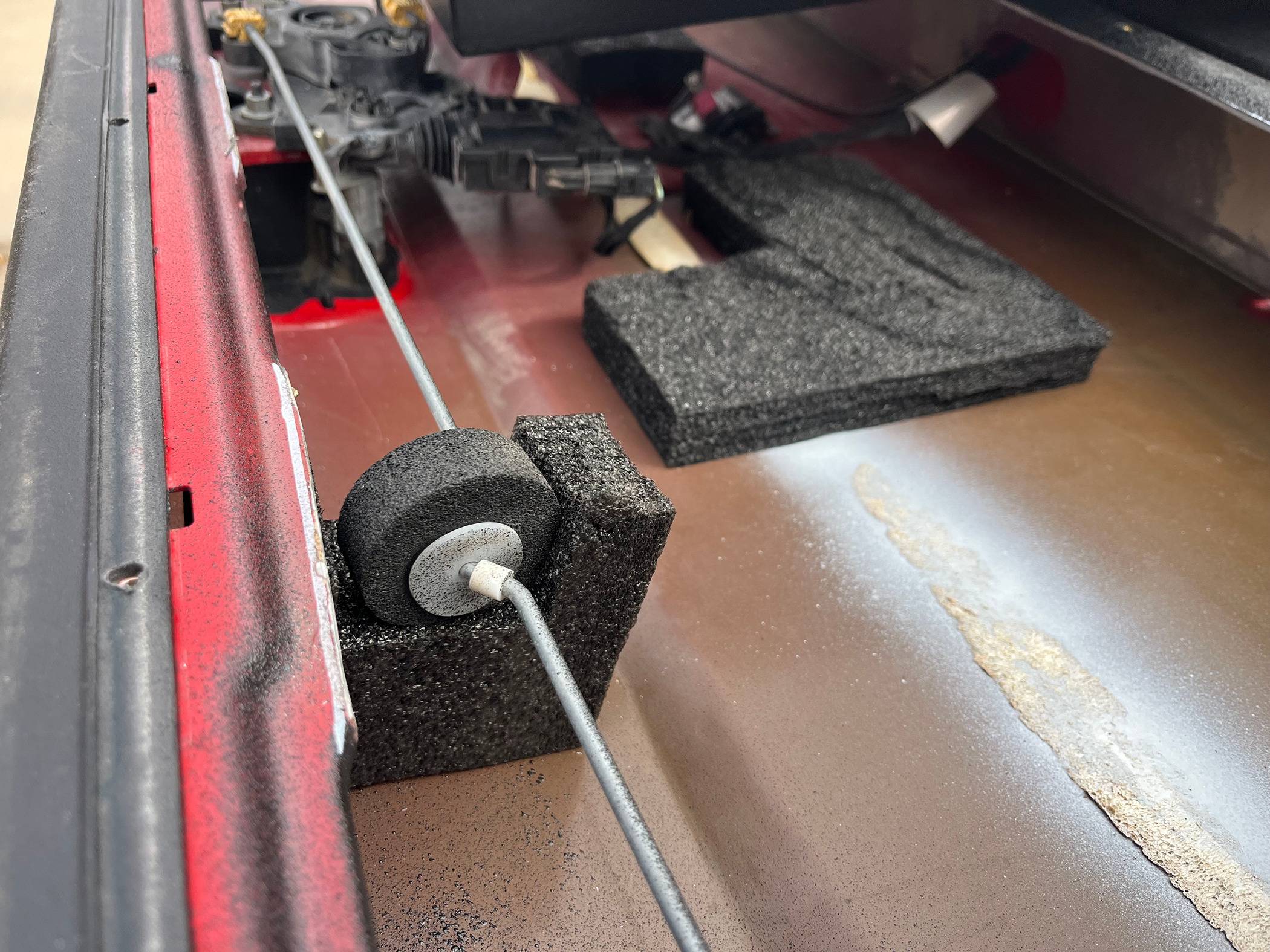

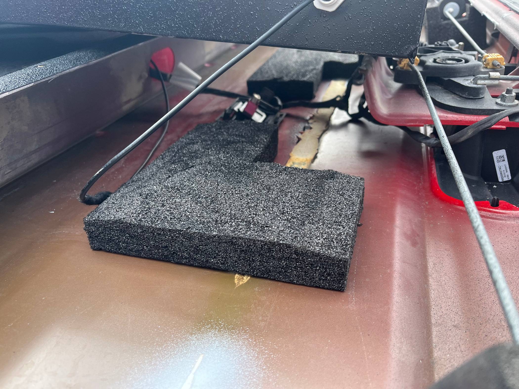

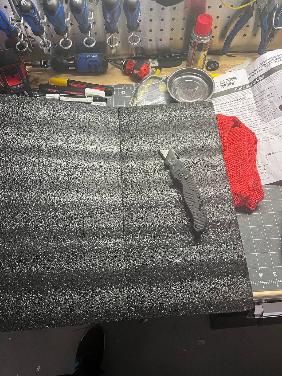

Update 3/18/2024:
Fixed the floppy sheet-metal!
Cut and added 1.5 inch thick polyethylene foam. Did my best to shape it with the same flat blade I used to cut out the original support.
Jeep Gladiator I cut a giant hole in my tailgate! Reaper Off-Road Tailgate Box install and write-up. img_9399-
Stuck it in the middle section with some double sided tape to hold it in place while I dropped the box in, and no more floppy tailgate! Tried to match the curve as best as I could. Only thing I would have done differently would be to just buy the 1 inch thick version, the 1.5 inch is a bit too much, and had to be trimmed down to that 1 inch thickness. Also threw in a piece to give my rattly prop-rod some support.
Jeep Gladiator I cut a giant hole in my tailgate! Reaper Off-Road Tailgate Box install and write-up. img_9403-
Jeep Gladiator I cut a giant hole in my tailgate! Reaper Off-Road Tailgate Box install and write-up. img_9404-

I would tapes/blocks off the locking mechanism area and fill the whole tailgate void with some expendable spray foam, then trim as needed.
