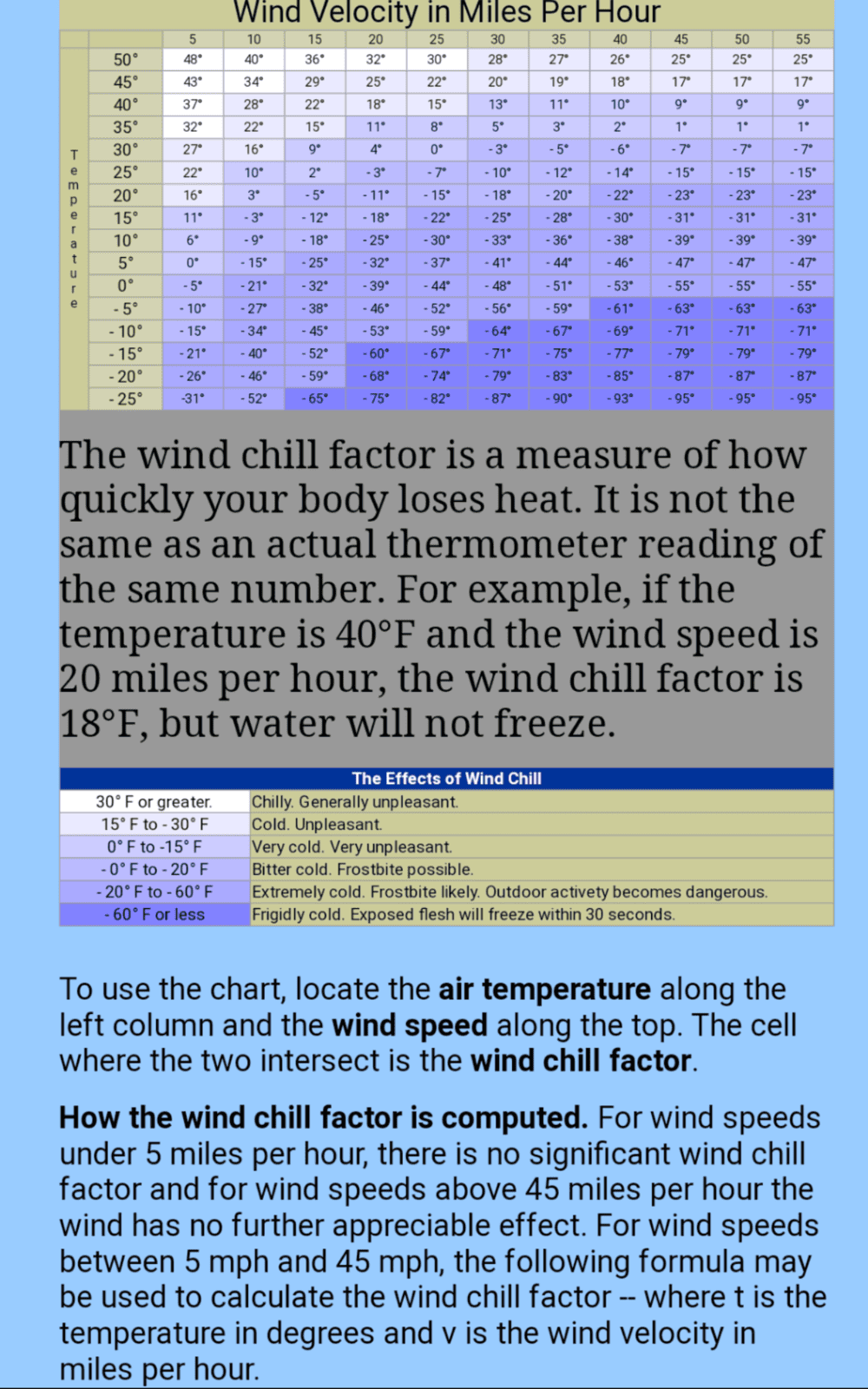

They’re correct. Wind-chill affects something with an internal heat source. If, say, it’s 30 F and really windy, it makes a human body have to work much harder to sustain its internal 98.6 F temperature because it is bombarded by a greater volume of 30 F air than if there was less/no wind. However, if you died and laid there for a while, the 30 F air would reduce your body temp to 30 F and no lower no matter how much wind there was. X deg. F air cannot reduce an object below X deg. F. However, it will make it come to X deg. F faster and require more heat production to prevent that. Whiskey can’t be made colder than the outside air temperature surrounding it. It’s physics. It’s possible that the outside air was colder or the booze was weaker than you thought. Otherwise, your booze was defying basic undeniable principles of science, which seems implausible.
40,501
54,022
From a site explaining how to chill or not chill your alcohol........
While the entire contents of the bottle will not freeze, the water will. This creates a slush out of your beverage and can ruin the flavor as well.
So they slush up because the WATER freezes. The water froze - so it was SLUSHY.
It wasn't frozen SOLID - but was slush.
Wine is 85 to 90 percent water, so it freezes at about 20 F (-6.7 C) — the water freezes first at 32 F (zero C) and then the alcohol after that [source: Wine Spectator]. It'll be slushy for a while before it becomes solid.

The greater the difference between an object's temperature and ambient temperature, the faster it loses heat. All windchill means is that the object loses heat faster as if the windchill were ambient, but of course the object's temperature won't go below the actual ambient. Make sense? The actual temperature is your final destination, the windchill is the speed at which you get there. Doesn't matter if the object is living or not (though I hear that a lot).
It does matter. Your body is generating heat. A bottle of booze isn't. If you're healthy, have eaten enough calories, and have some decent clothing on, your internal temperature won't fall at all--below 98.6 deg. F. In that scenario, your temperature won't fall at all; you just will burn more calories and possibly be more uncomfortable making that happen when the winds are higher, as opposed to when they aren't.
40,501
54,022
Funny thing about facts - you can post them, you can post screen shots, info from NOAA, from meteorology sites, weather dot come, post the comments from world-renowned scientists - and you STILL get push-back. Why are we wasting our tax dollars if even NOAA can't get it right. Maybe planes will start falling out of the sky, they are wrong.
I posted what, 5 things at least that say it has no effect on inanimate objects and still......................
I know there are multiple methods for determining it - one was to have a person out in the wind with their face exposed, another considers moisture, etc. There are winds that feel worse because of the humidity, or lack of - that's considered in some scenarios.
But still, every single resource agrees - does not affect inanimate objects, no matter which method you subscribe to.
I have a friend who is a local meteorologist, went to Alaska with her and her husband, will be going to Australia with her and her husband - maybe I need to get them to join in the fun here LOL

I'm not going to debate this - physics is physics, and thermodynamics is thermodynamics, and I was trying to offer a simple explanation. In my post I was describing one way that objects lose heat (that's pertinent to the discussion). It's certainly true that the object (in the case of a warm-blooded animal) can be creating heat at the same time, and especially if insulated (thus slowing the heat loss), the rate of heat created can meet or even exceed the rate of heat loss. No object, living or not, will become colder than ambient, but every object, living or not, will lose heat faster in a wind that's constantly bring cold air next to it, maintaining a large temperature difference. Windchill is not an important concept with inanimate objects - they don't "feel" how quickly they change temperature - but it is inaccurate to suggest that their rate of heat loss is unaffected by wind.
40,501
54,022
Now we're into heat transfer rates - BTUs, BTUs per hour, that sort of thing. Wind speeds the heat transfer process. That's something that cannot be argued - it's the whole idea for air cooled engines, radiators, and more.
Engines generate heat - for cooling systems we often use the BTU, roughly 250 calories or something like that. The heat energy required to raise the temperature of a pound of water 1 degree (F)
So if an engine generates xx BTU of heat - the cooling system must remove that heat just as quickly if not more-so.
A lot of "beginners" wanting to modify their car engine so they can go racing on weekends gripe "gee, what's wrong, my engine keeps over-heating". Well DUH. It takes so much fuel energy to make HP - you just upped the HP output, meaning you've upped the heat energy produced by that same engine and increased the BTU output but left the same two row core radiator in there? Genius.
More BTU produced by engine in a given time means the cooling system has to remove that extra heat as well.
So - you can INCREASE the AIR FLOW to help compensate - remove the heat faster, use a shroud, better fan, or increase the radiator capacity, whatever.
Air cooled engines produce heat and the air moving over the cooling fins removes that heat - if it's not getting air flow it will over-heat, so you improve the air flow - clean the fins, whatever it takes to increase the air flow to remove the heat faster.
Simple example - air cooled motorcycle. Keep it moving to keep it cooler.
Absolutely the rate of heat transfer is impacted by the air flow. The larger temperature difference between the item being cooled and the air cooling it matters - and once that air reaches a certain point, it's more efficient to bring in cooler air as the air by the item is warmed.
