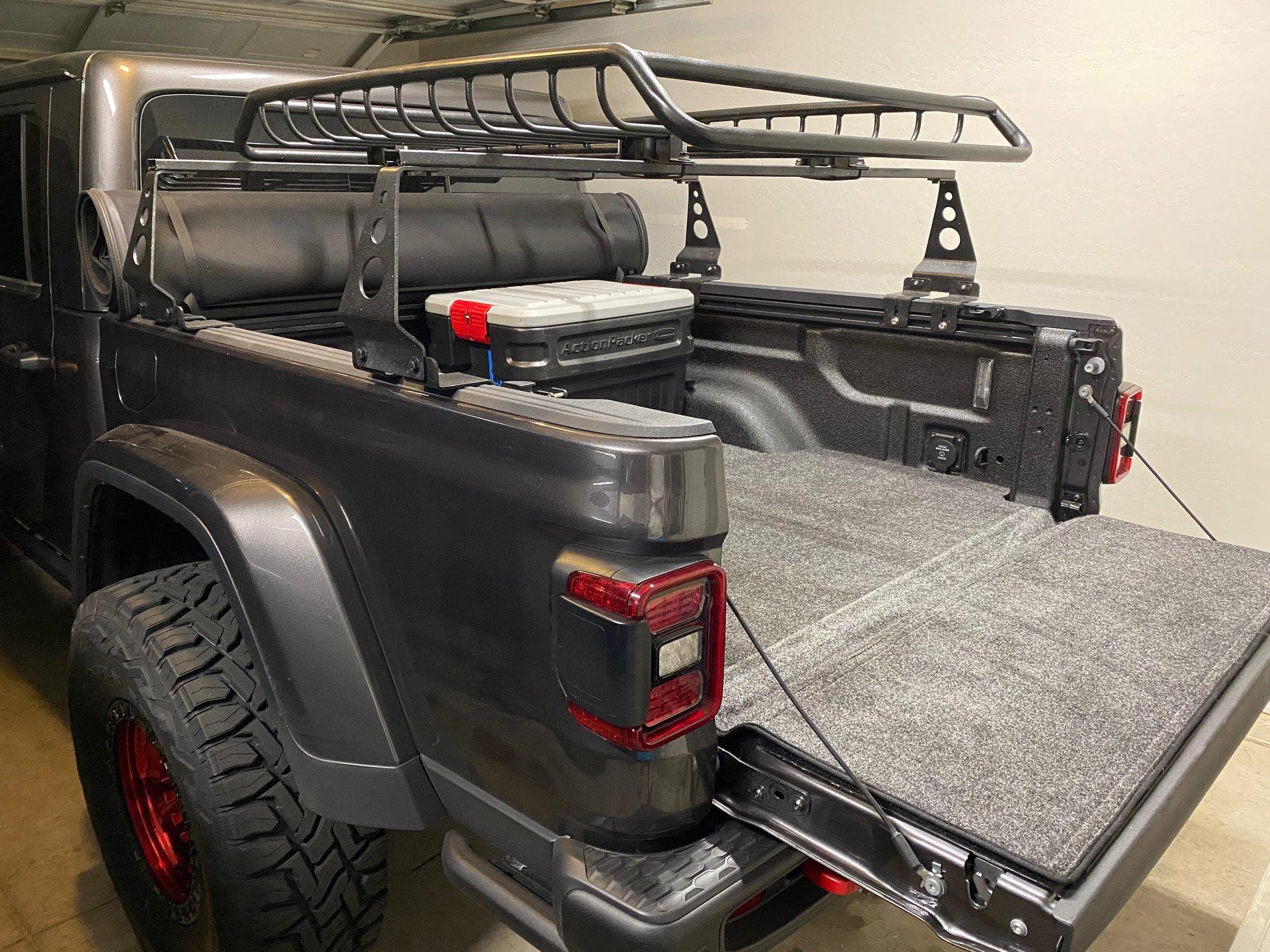

I'm building my idea of a perfect (for me) Gladiator rack

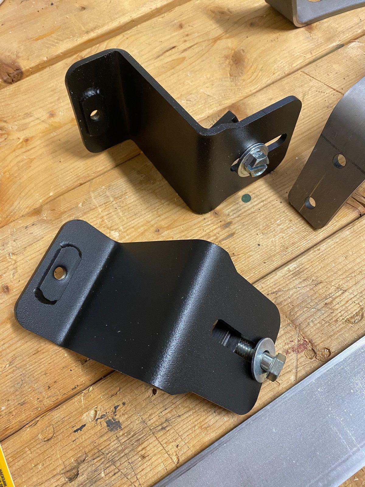

Sure. Here's the "Tonneau Brackets" story...
So I originally purchased 4 of the MAX Modular Bed Rack Tonneau Brackets but it seems that my purchase of 4 of them caused the good folks there to re-think their sales of them. To be clear, their website offered them to "test" the fit of the bracket on the Buyer's truck (Gladiator, Toyota, other trucks). They expected customers to only buy one but I bought needed and bought four. And they asked me what I'm doing with them - why I bought four of them.

I realized the upper brackets would work best with 8 of the Max Modular Bed Rack Tonneau Brackets so I tried to buy 4 more. But they changed their offering and they now only sell the brackets individually with no holes in them - what they call the

So now the only option they offer on their website is to buy the Tonneau Brackets with their other brackets - what they call their MAX Modular Bed Rack Tonneau Brackets...

Per their website:
These handy little brackets allow you to use your bed rack with most tonneau covers.
Rated for RTT's.
Raises the overall height of the bed rack by 2.5”.
Black textured powder coated.
Kit includes four attachment clips, four brackets, and mounting hardware.
$150.00 for 4 sets
I wish and hope they'll sell only the Tonneau Brackets to the market. I understand they're a business and they're doing what they think is best for them. And I'm sure they want their customers to buy more of their products (Racks). They didn't ask me for my opinion but I suggest they sell as many of these Tonneau Brackets while they can before someone else "builds a better mousetrap" and the potential for them to sell these brackets has gone away.

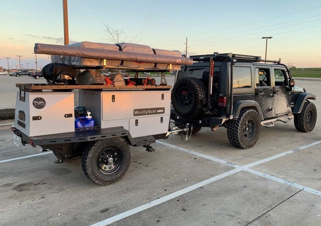

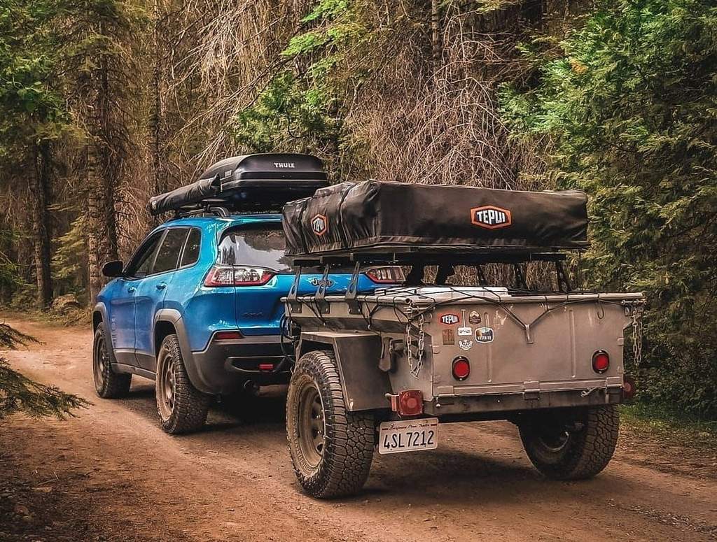

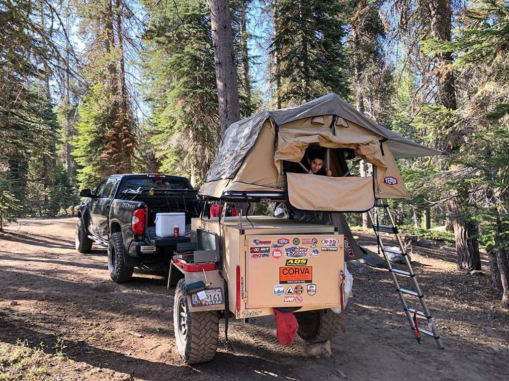

Here are a couple more pics of how folks are using their brackets...
Jeep Gladiator I'm building my idea of a perfect (for me) Gladiator rack Kristen_goforthewest_1024x1024
Jeep Gladiator I'm building my idea of a perfect (for me) Gladiator rack JordanC1_1024x1024

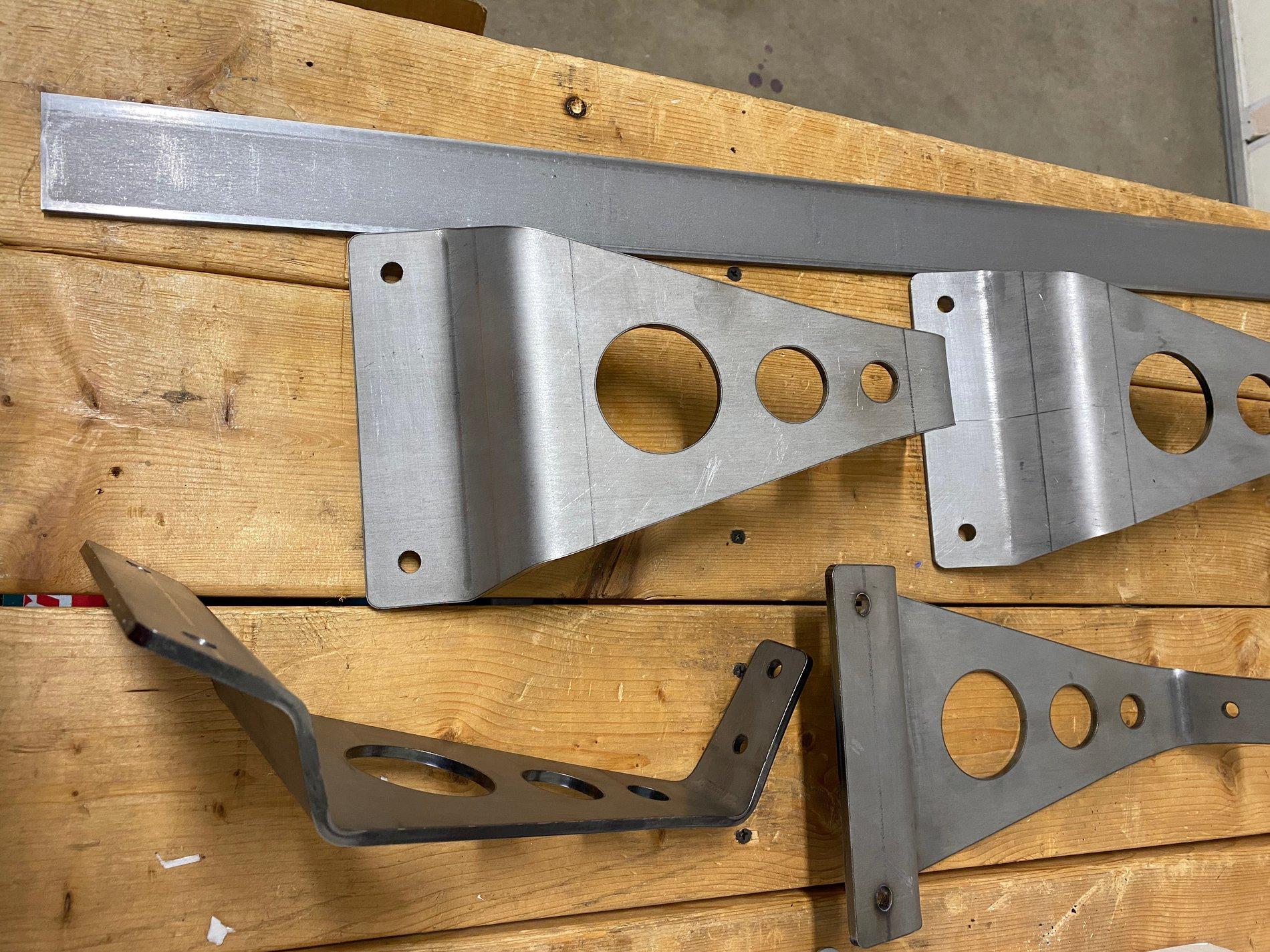

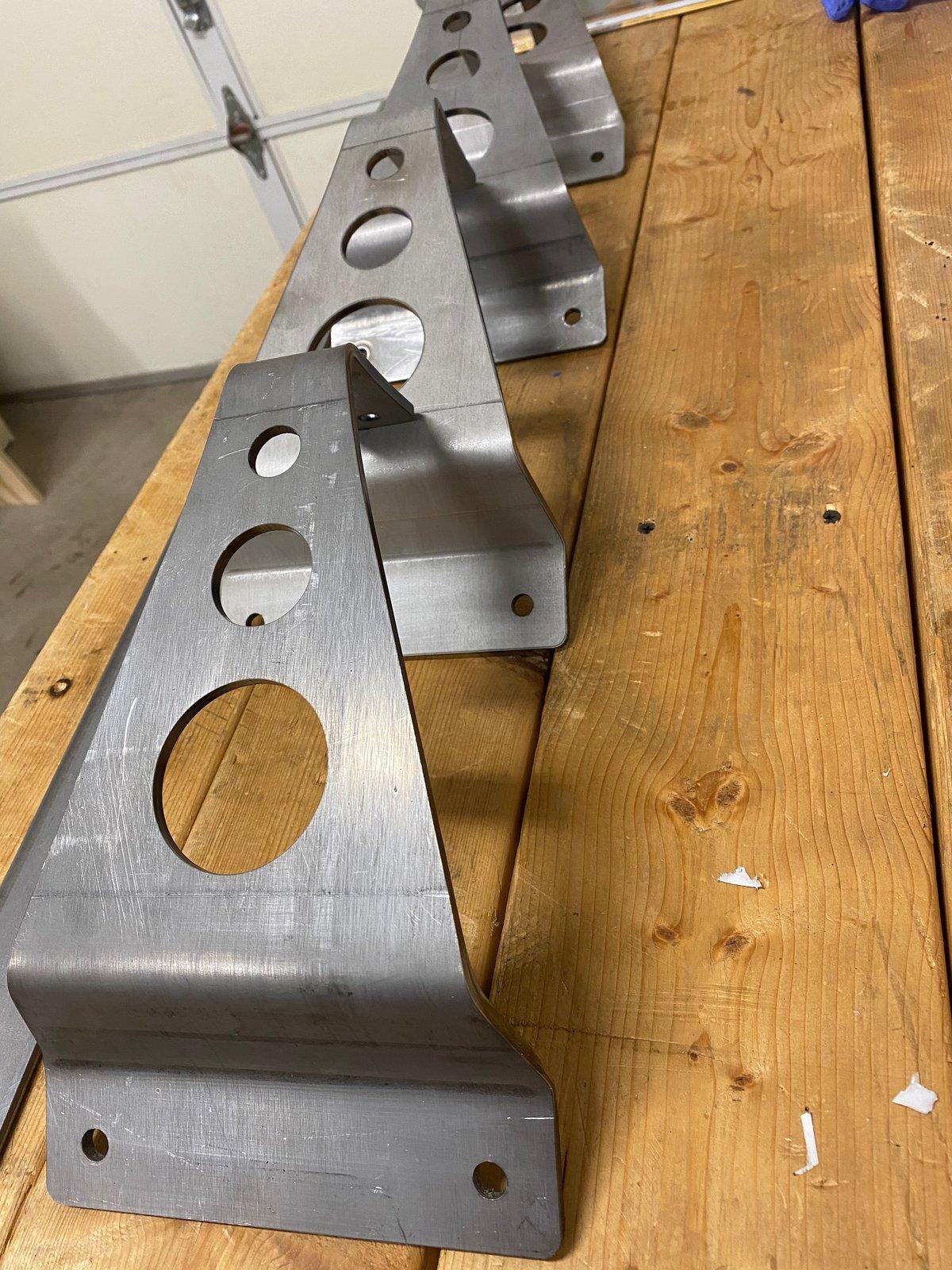

Here are my pics...
Jeep Gladiator I'm building my idea of a perfect (for me) Gladiator rack Brackets - 1

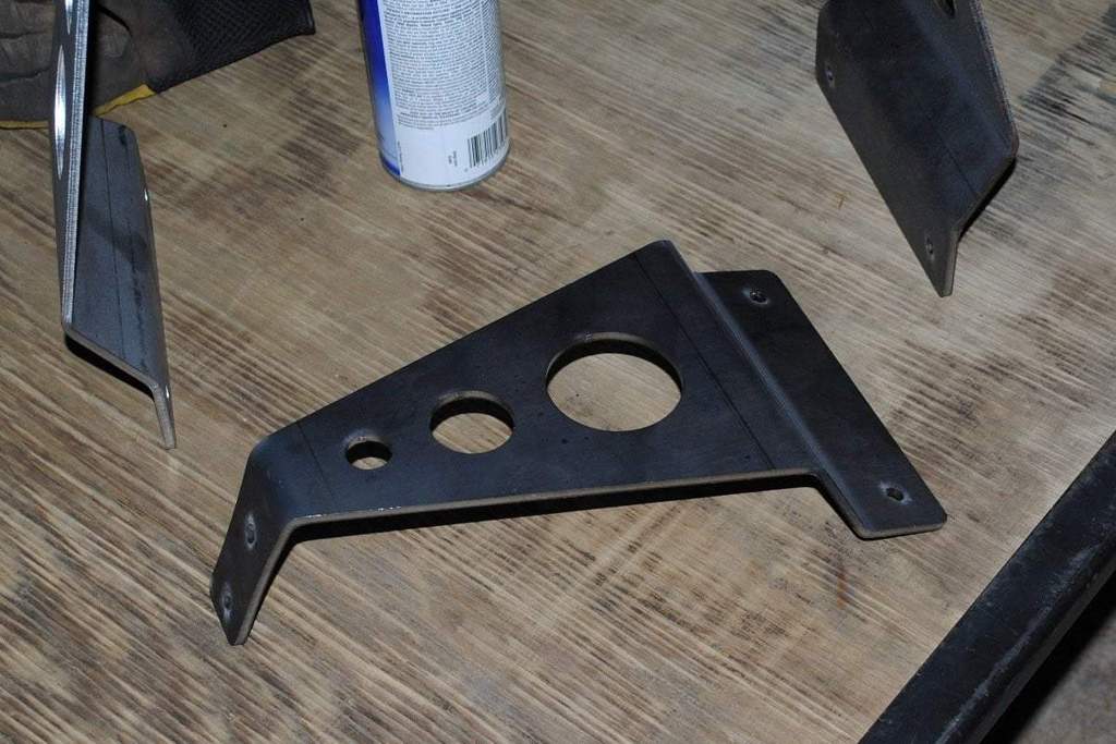

Note: I bought 4 of their brackets that were "seconds" - they were in excellent condition and I was OK with them as I was going to paint them anyway. I drilled out the 4 mounting holes to fit the â…ś" stainless steel bolts for the stainless steel T-Bolts (for the Trail Rail), cleaned them up, wiped them down with Acetone and then I sprayed them with Rustoleum Automotive Primer (fast-drying) and then finished them with the Rustoleum Metallic Black ("Galaxy" see back of can - I think the number is 252383 but it's the only one called "Galaxy") spray paint.
Below: Here's a pic of the brackets as I received them before drilling the holes (let me know if you need any tips on this). You can also see the steel flat bar stock I bought at Home Depot which I used for the CO2 tank installation...
Jeep Gladiator I'm building my idea of a perfect (for me) Gladiator rack Brackets - 2

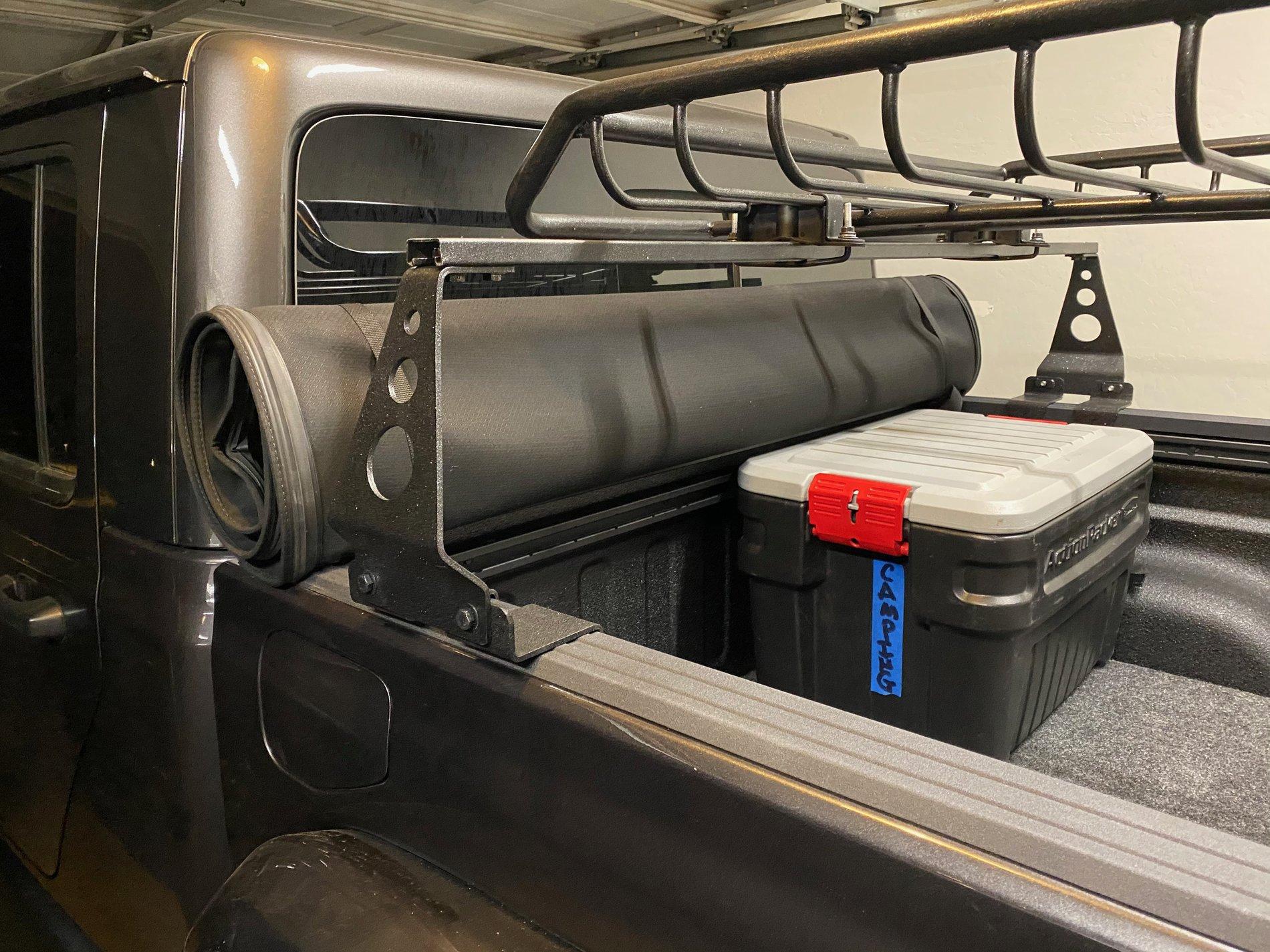

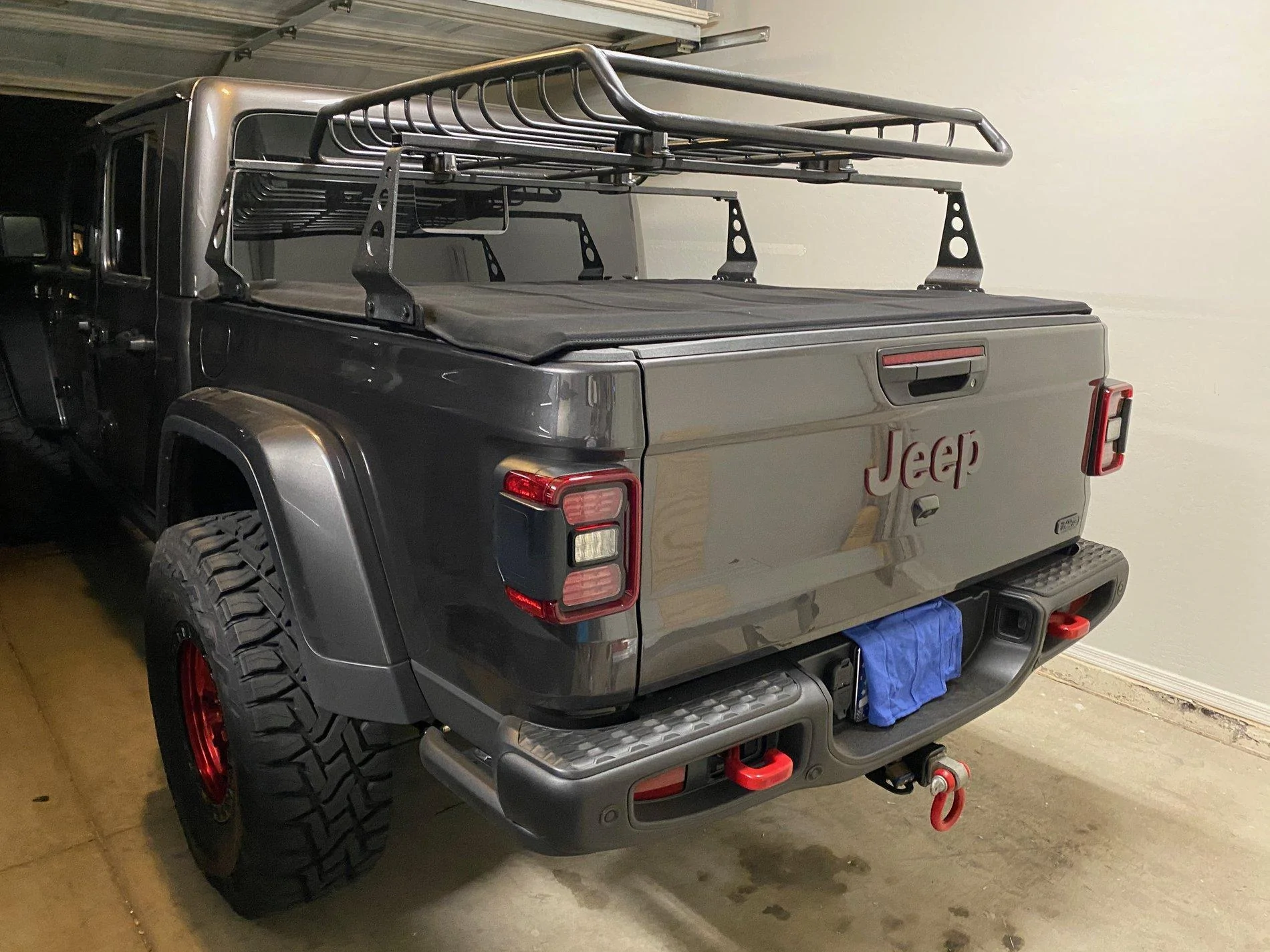

To be honest, I lucked out! The combination of these brackets allows me to completely roll up the factory Tonneau Cover - it just fits under the Superstrut cross rails - it's exactly what I hoped for and I'm really pleased with how this rather involved project turned out (better than even I expected).
Jeep Gladiator I'm building my idea of a perfect (for me) Gladiator rack BedRack - 22
Jeep Gladiator I'm building my idea of a perfect (for me) Gladiator rack BedRack - 13

One more pic of the Tonneau Cover rolled up...
Jeep Gladiator I'm building my idea of a perfect (for me) Gladiator rack Brackets - 1 (1)

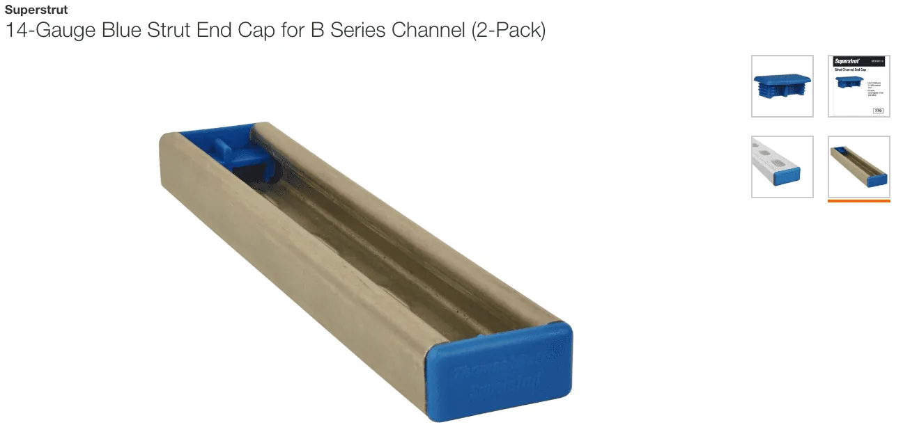

Do you think you could find end caps for that strut you bought at the Depot? Just to clean the ends up a little. It looks great and I like what you have put together.
Yes. I haven't had time to buy them and then do what's necessary to paint these plastic caps...
Note: I used "Superstrut" purchased at Home Depot. There's also "Unistrut" (not sure if that's what Lowe's sells nor do I know what the differences, if any, might be - I suspect they're interchangeable but I can't confirm that).
<EDIT: I can't add these end caps because the brackets are bolted right at the ends of the Strut>

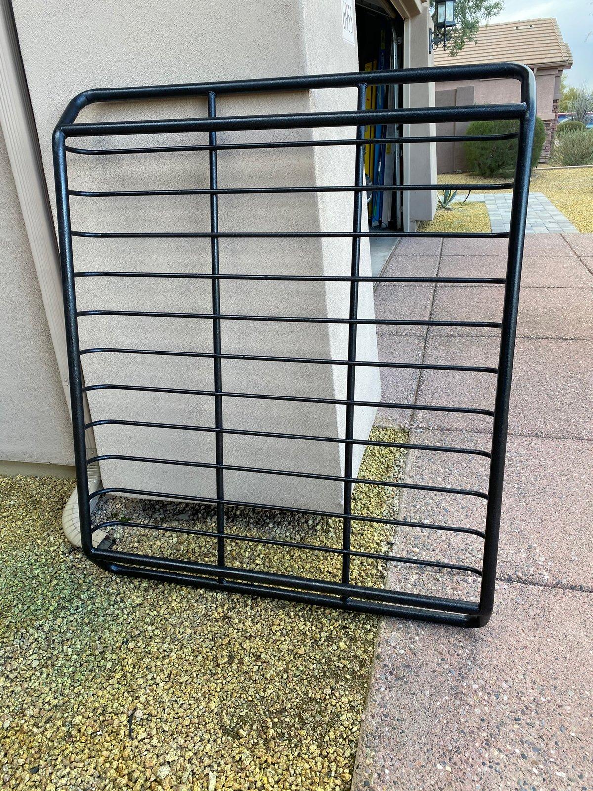

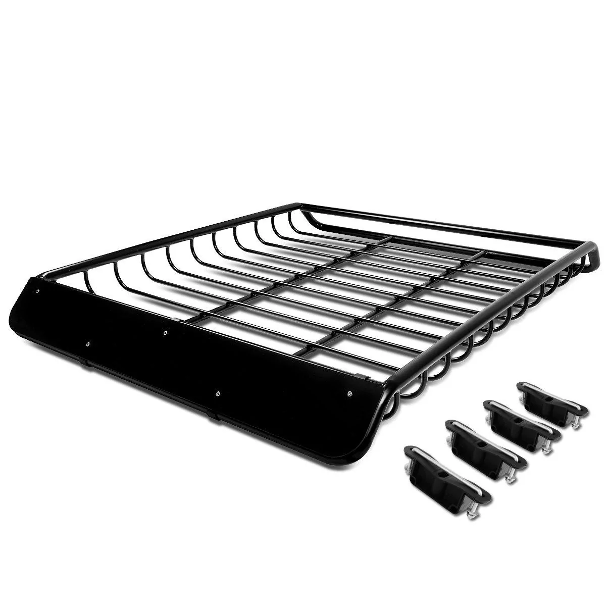

Here's the "Roof Rack Top Cargo Carrier Basket" I purchased after researching them online (some of these baskets/racks are expensive and some are super expensive).
This one is a great size for what I wanted - it's 53 inches long by 43 inches wide. The quality of this thing is excellent. It apepars to be very well made, the finish is really good (painted black). The size is good - I'm happy with the length and my only wish is that it was a bit wider but it's a good size for my needs.
Note that the wind deflector is easily unbolted and removed. The brackets are high quality as is the hardware that comes with it.
It was $135.88 on Amazon - such a deal :handsinair: for a quality product with excellent ratings.
https://www.amazon.com/gp/product/B06Y4GLGDN/ref=ppx_yo_dt_b_asin_title_o04_s00?ie=UTF8&psc=1
Jeep Gladiator I'm building my idea of a perfect (for me) Gladiator rack 61MMEVdE-OL._SL1200_
I wiped it down with acetone, sprayed it with primer and then with the Rustoleum Metallic black ("Galaxy") paint. It wasn't nearly as bad to spray paint as I thought it might be. I masked off the hardware (threads on the U-bolts and the nuts) and everything now matches...
Jeep Gladiator I'm building my idea of a perfect (for me) Gladiator rack CargoBasket - 1
