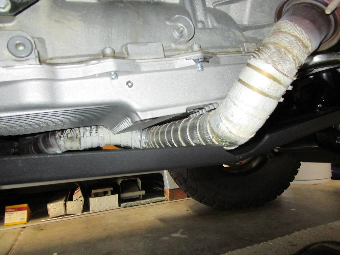

Just got back from the 4X4 shop in Livermore
I brought up my concerns about the jeep hitting 231 before the fan would kick on and bring the temperature down
I ask Joe if any one has added a fan with variable speed on the font of the radiator
He said no put he has a lot of customers that have the same complaint and if I go ahead he wants to Know the results
I just ordered the 10in. Mishimoto fan and Pulse-Width Modulated (PWM) Fan Controller
I will let you guy Know how it goes . good ,bad or no change

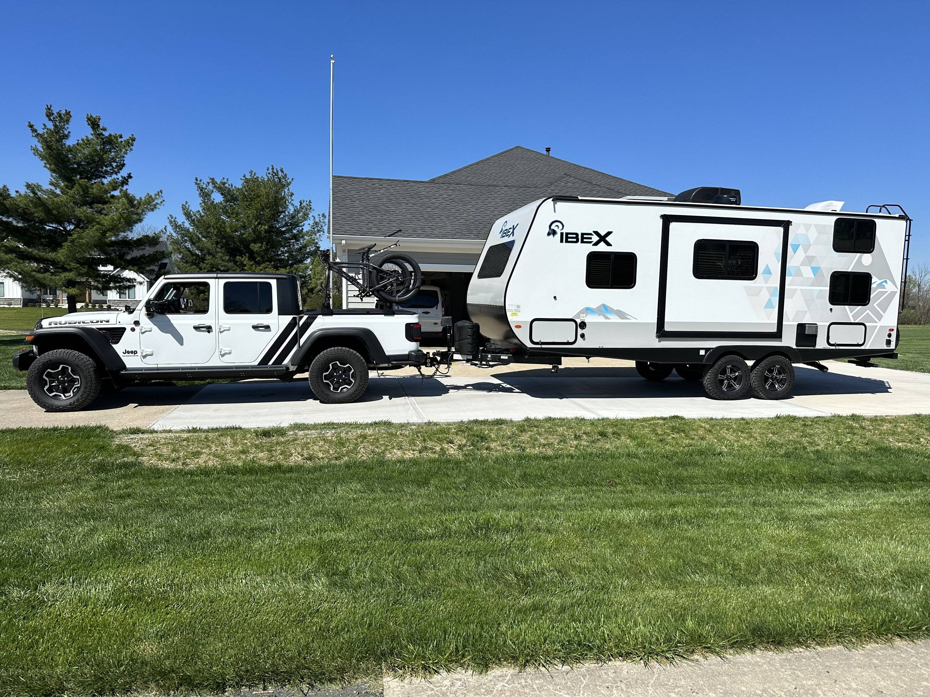

I have a 2023 JTR and I‘ve pulled my 25’ camper loaded around 5500lbs several times now. I have the 3.6 gas engine and when pulling at 65-68 mph I regularly see oil temps around 240F. With a pretty strong head wind coming back on one trip I was running 245-250F for a good stretch but I was also running in 4th and 5th gear a lot at around 4000-5000 rpm. These temps are high but I’ve gotten use to it now and as long as It stays under 260F I’m ok with it now. If I could drop these temps 5-10F I’d definitely go with the new grill.

If you want to see even lower trans temps rap your exhaust pipe where it goes under the trans pan
I would see trans temps 225 just around town put after the rap it stays around 201
Just got back from Lake Tahoe off and on road temps never got over 206 even the long pulls up to Tahoe
The key is to rap it twice
The first rap is normal rap. The second rap is with the foil backed exhaust rap put I found out that the foil wont stay on so my next step is going to install the foil rap with the foil down. the foil dose a good job at blocking the heat
Before the rap my exhaust pipe was 400 to 450 now checking the temp of the rap is around 180 to 225
How can a pipe at 400 to 450 an inch away from the pan not add heat to the trans oil
Seams to be working for me
And yes all testing was done with and without the skid plates. The results where the same
