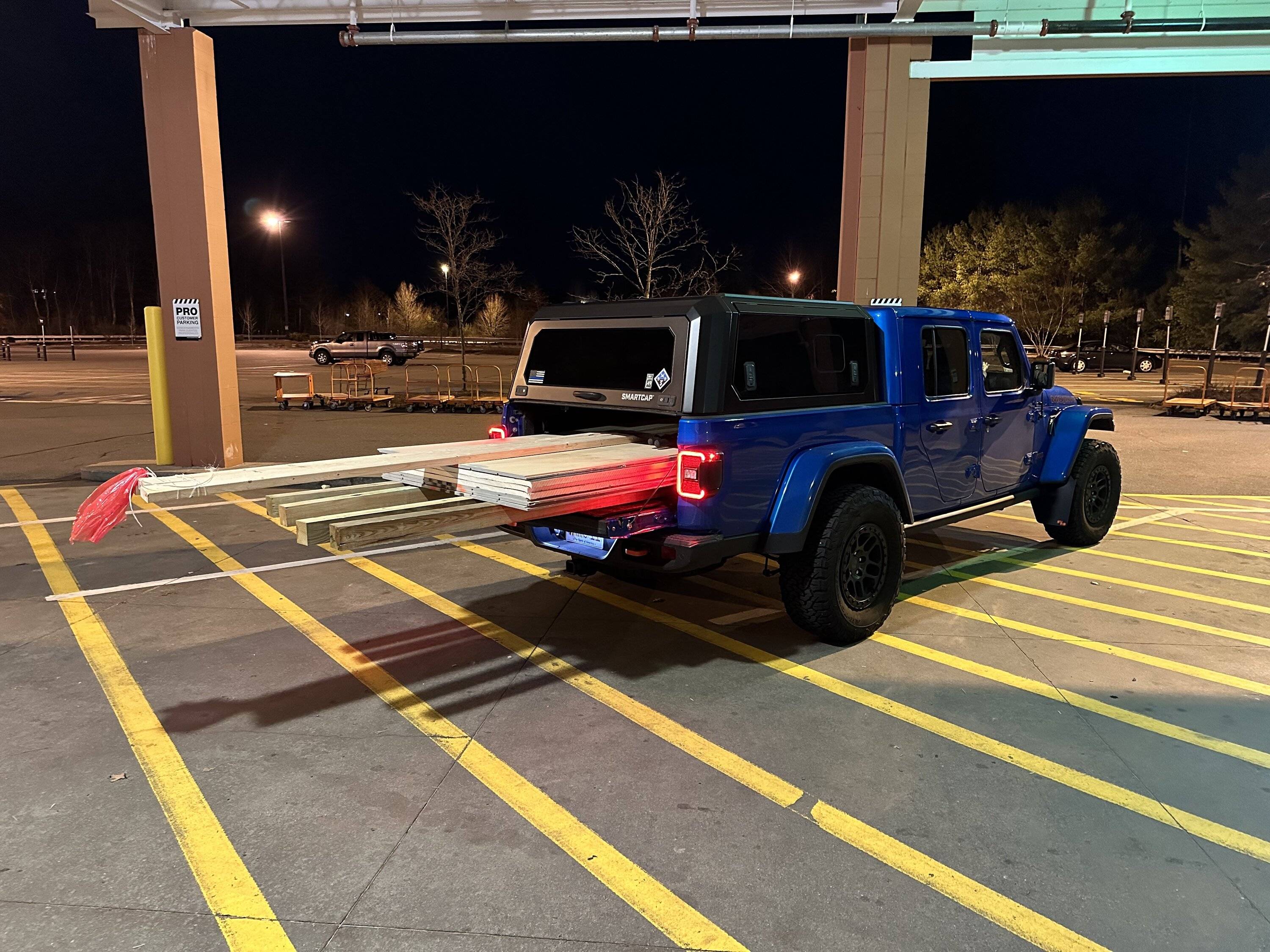

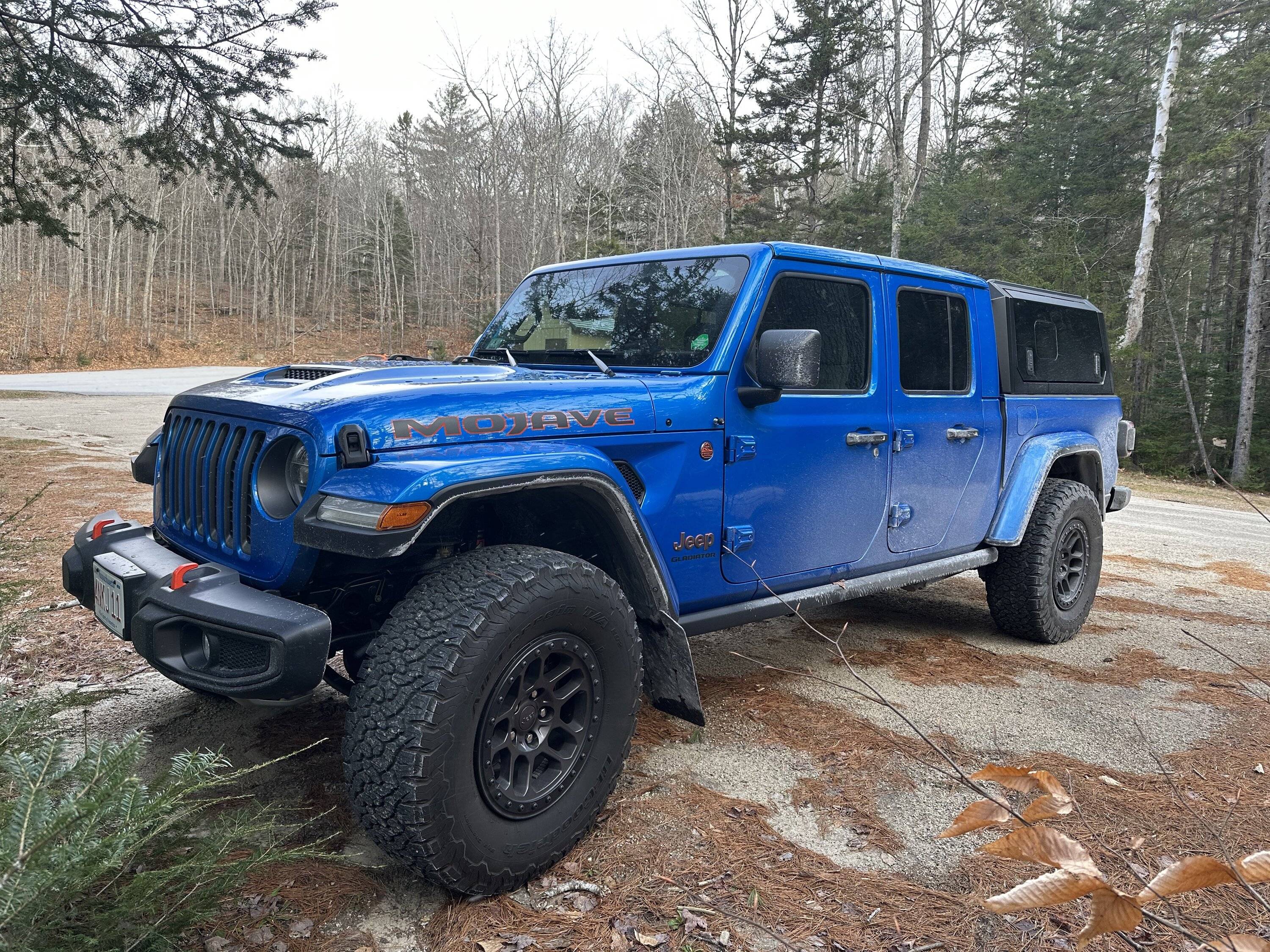

I've got a Mojave with 35s on it. I also have a topper on it. The topper didn't make the back go down much, I guess it just got rid of the rake the truck normally had. Either way, I don't feel a need to do anything to the suspension at this point.
If I wanted to tow more than what I currently tow, which maxes out at about 2500 lbs, I'd get bags.
