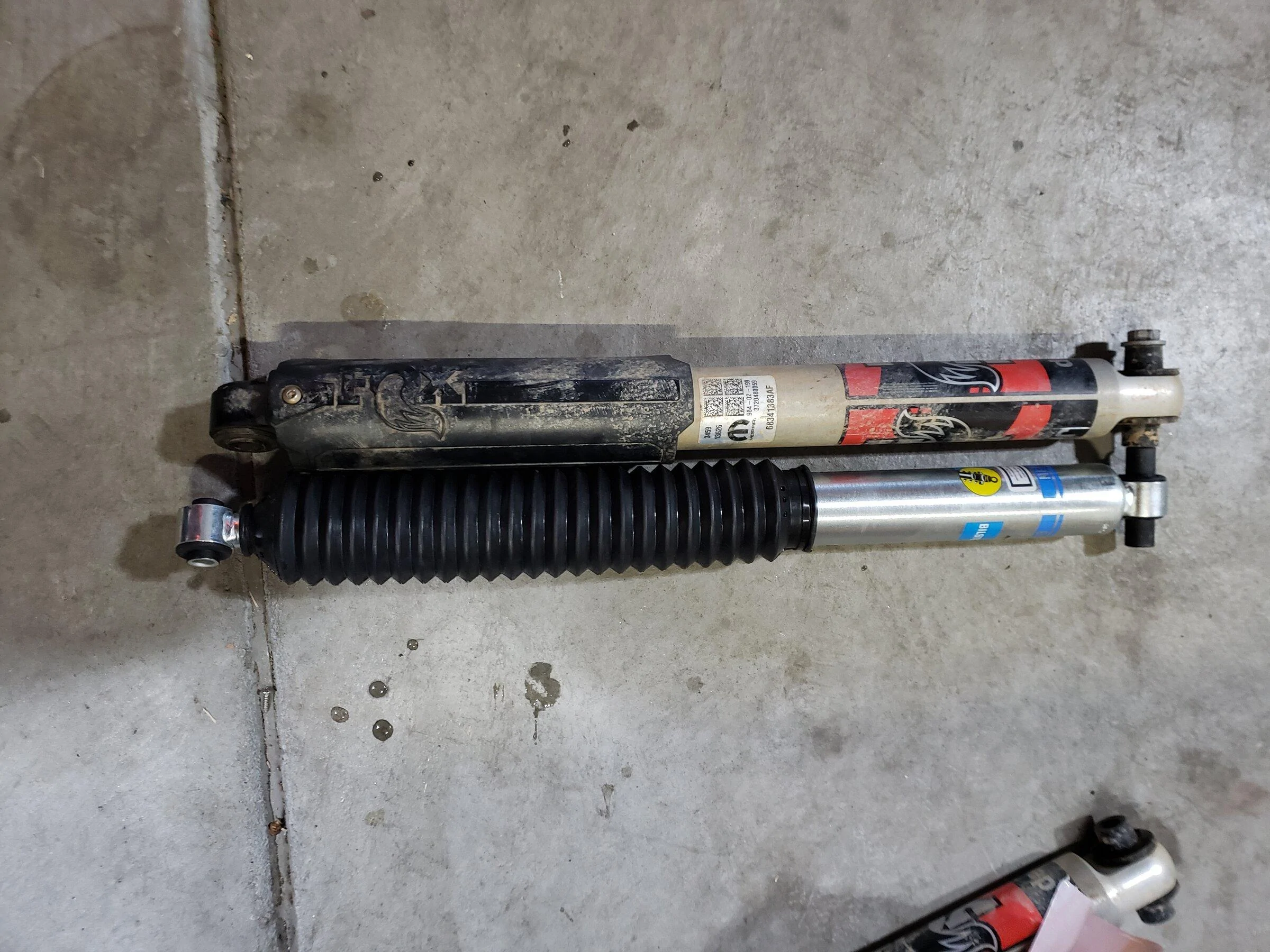

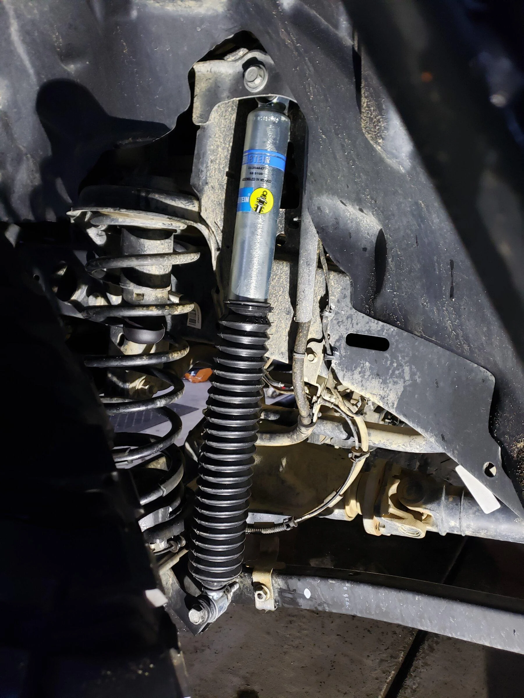

The front pair actually came in today and I put them on. Still waiting for the rear. So far I immediately noticed the back ends tendency to bounce when backing off my driveway. The front end dips once and stays put. They are stiffer, but I feel they handle the sharp imperfections (jolts) in the road better. I'm starting to think that the factory Fox shocks arent the same as the 2.0s that everyone loves. If anyone has info on that let me know. So far I'm happy with my purchase but I'm still running half and half until the rears get here lol.
I noticed the Bilstiens were a hair longer than the Foxs also. Not enough to make any difference I'm sure. Just passing on what I learned. Fox was lighter as well.
Thanks for your feedback! I’m starting to lean towards the 5100. Even if it doesn’t “fix” my problem, I’m sure they’ll at least make it better. Let me know what you think when you finish the set!
