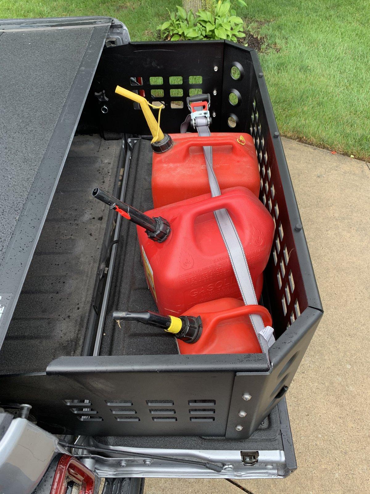

Installed ACE bed extender

Jeep Gladiator Installed ACE bed extender C510F0B3-5F12-4D14-AC09-0E5FB15A5281

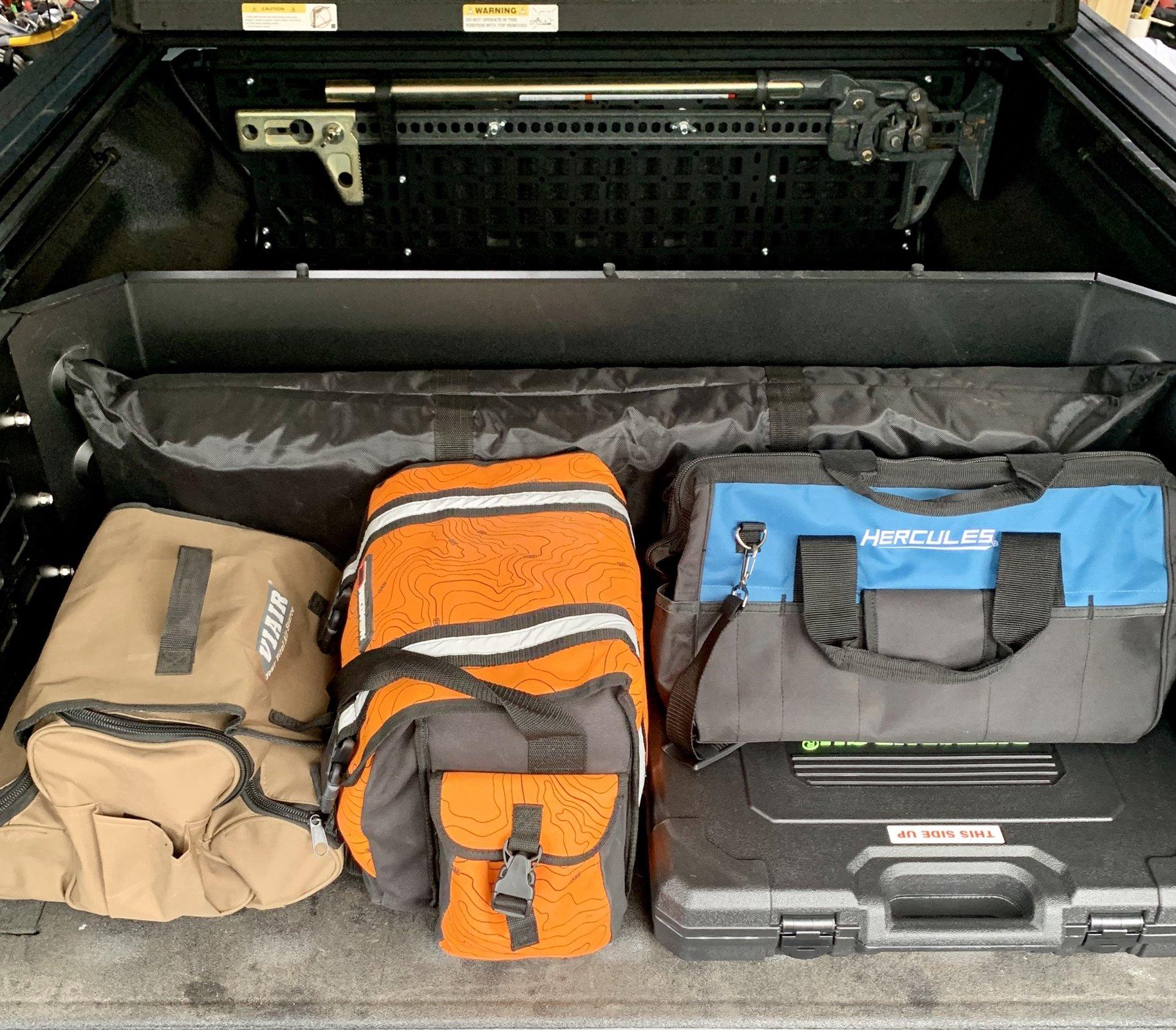

Here is my recovery gear for the Trails over the weekend. Also use it for something as simple as gas tanks :)
Nice. I like the simple use of the ratchet strap. could do it that way even with it in the bed with tonneau cover on (although the spouts may need to be removed)

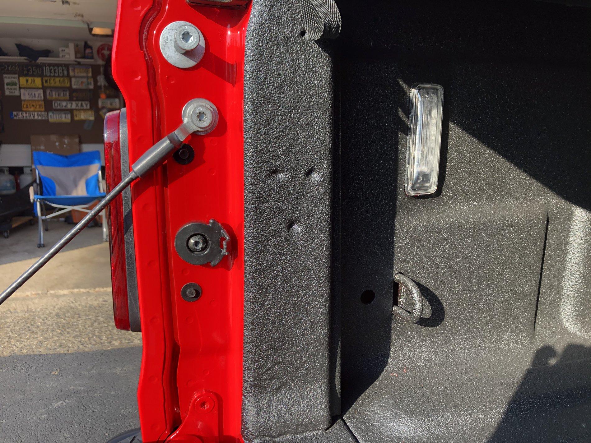

Anyone have a link to an install video or printed directions? I just received mine and no instruction. Couldn’t find anything on Ace’s website. I’m sure I could figure it out, but the nutserts have me mildly concerned. Anyone know what size hole to drill for the nutserts?

Before receiving it and looking at it, I just assumed I would drill out the dimples (see pic). I have a spray in liner, but there are three obvious dimples in the bed wall on either side. I see now that the bed extender mounting bracket uses 4 nutserts and doesn’t use the dimpled area at all.
Thanks again, I’ll give them a call on Monday.
