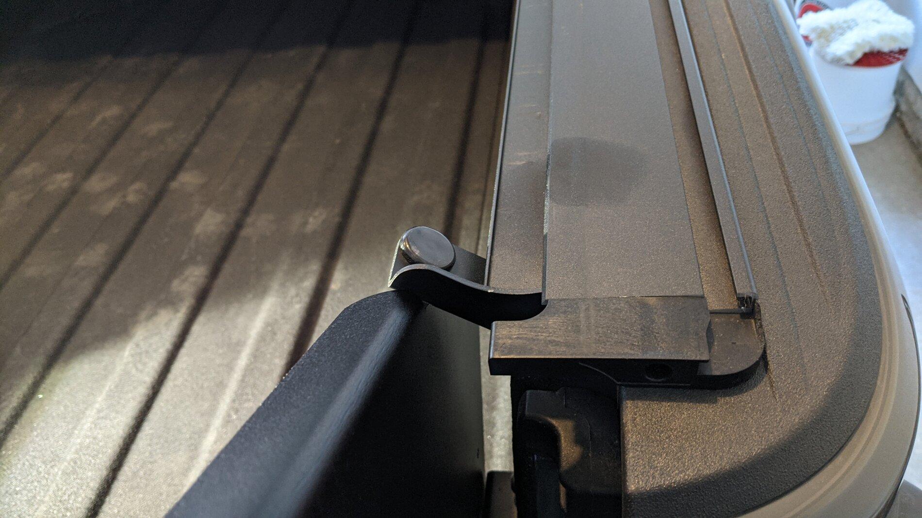

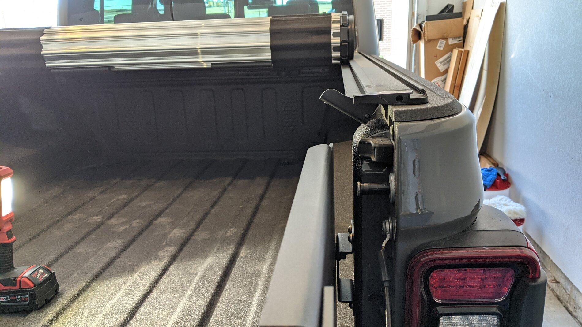

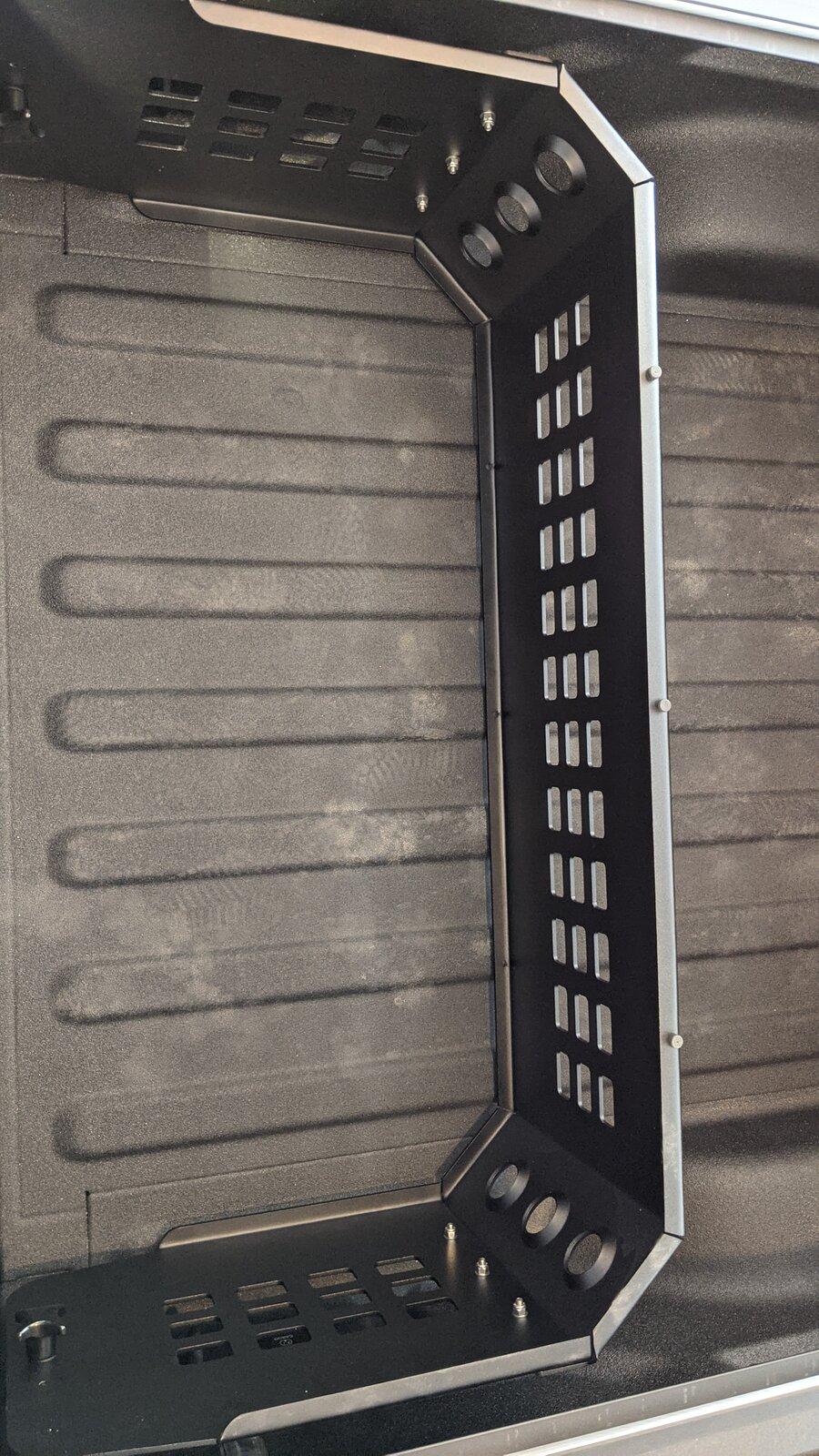

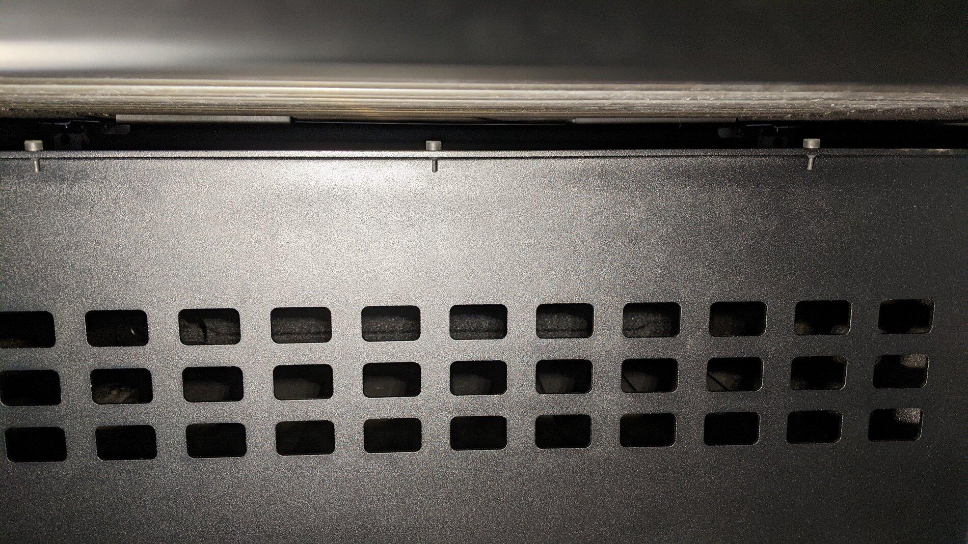

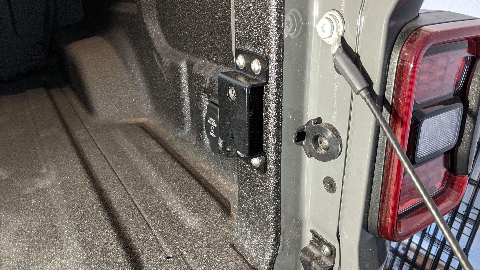

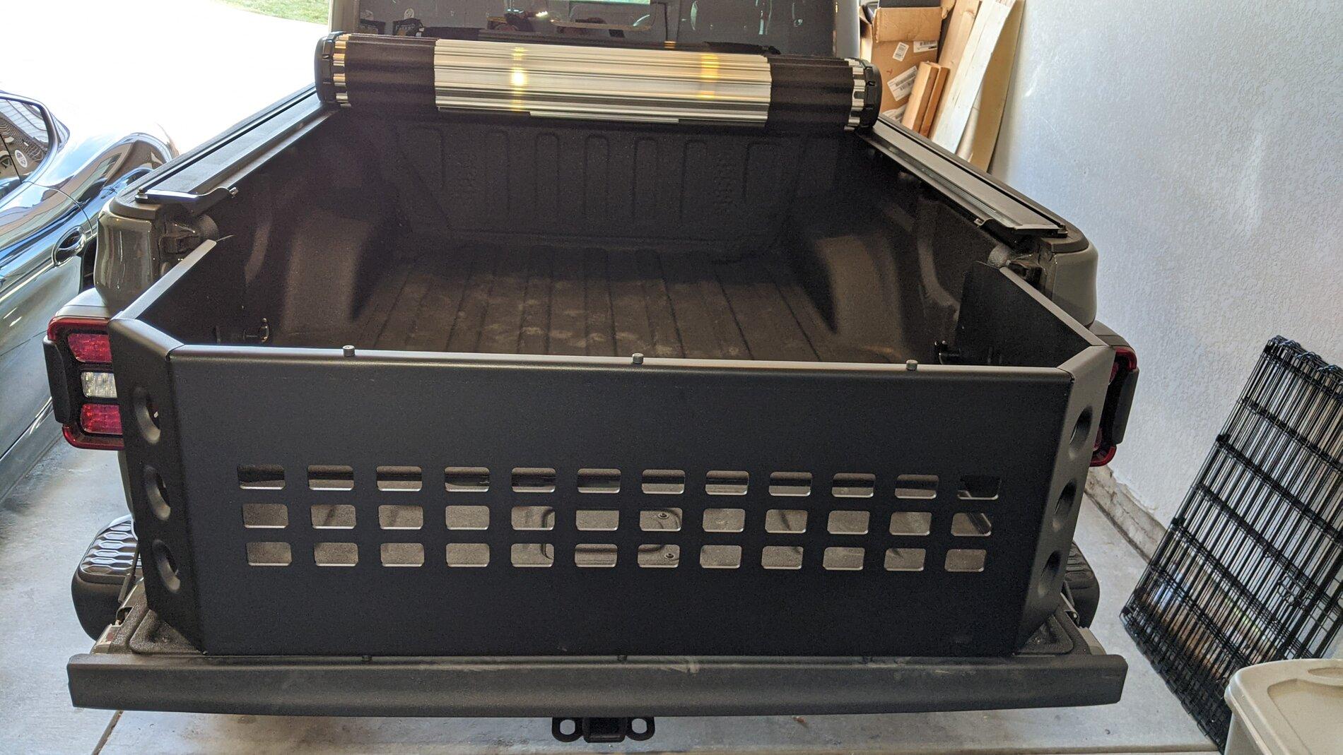

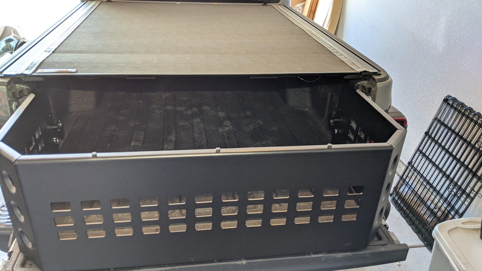

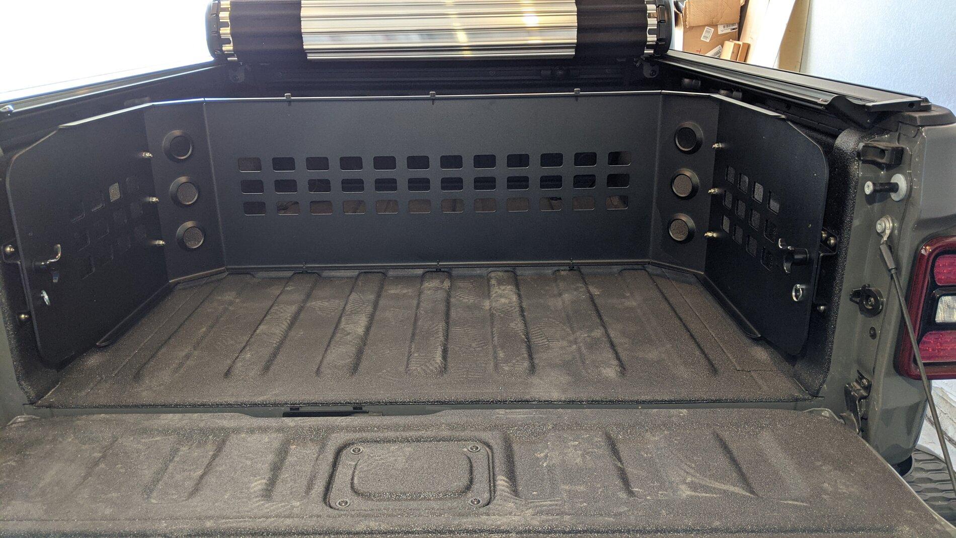

Finally got mine installed, had to order the 33/64 drill bit. Not too hard but definitely a measure thrice drill once. Moving up in bit size gradually helps.
One KEY note, for those with BAK X4 hard rolling tonneau cover, this won't work for you very well, and I wouldn't recommend getting it. The issue is that the bed cover has locking latches that stick out in towards the bed at the tailgate to actuate the locking mechanism when you roll the cover out flat. They stick in far enough that you can't flip this thing on the hinge, instead having to remove it to flip it. I'm going to see if I can either get the custom made so that they fold out of the way, or move up my timeline for going with a topper instead of tonneau cover which is why I still went ahead with the install. Here are some pics showing it installed as well as the problem I described.
