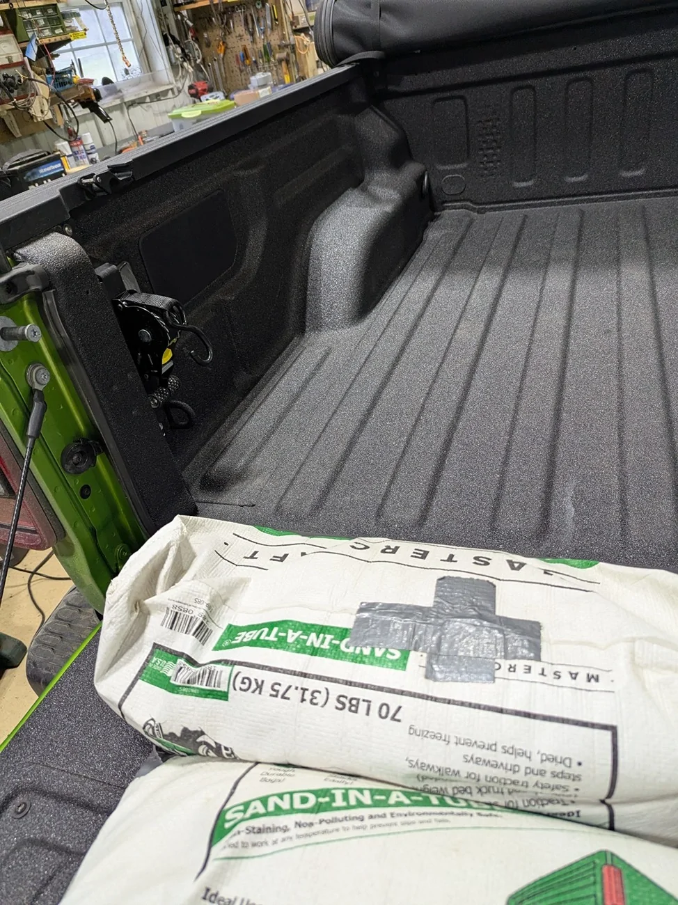

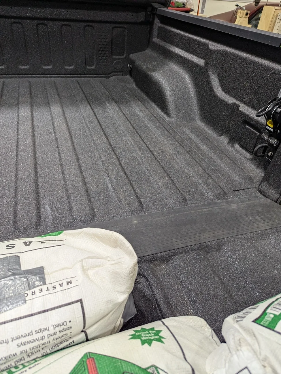

Sandbags rolled back off the bed floor and bed cleaned up. You can see the tailgate gap cover in this first picture - it prevents rock, sand, gravel, debris, whatever, from falling between the bed and tailgate, maybe even wedging in there.

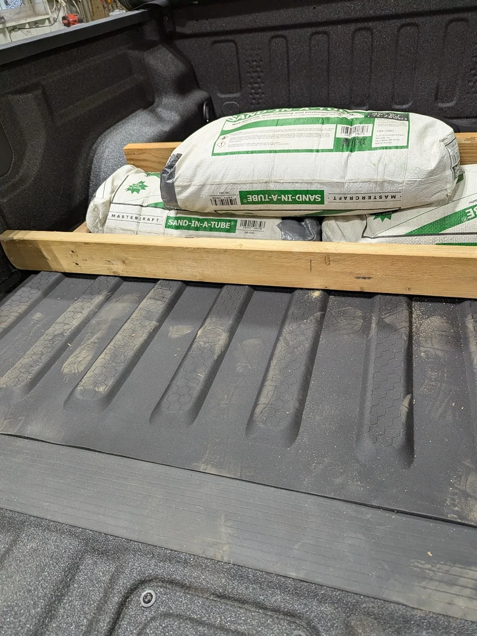

Mat in, sandbags back in place - you can see the mat, and the tailgap filler piece here. I need to wipe down the mat - got my footprints all over it rolling the sandbags back in (70 pounds each)

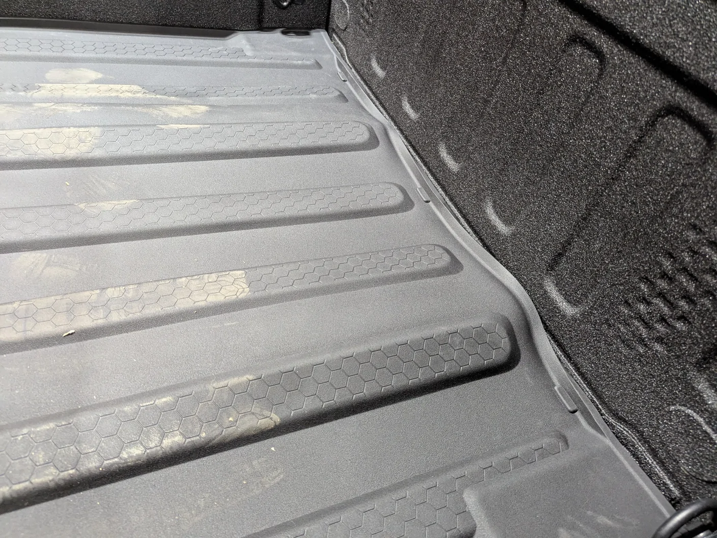

I hope this settles down and lays flat...........
Jeep Gladiator Installed and checked out the 3W bed mat PXL_20260105_221634707

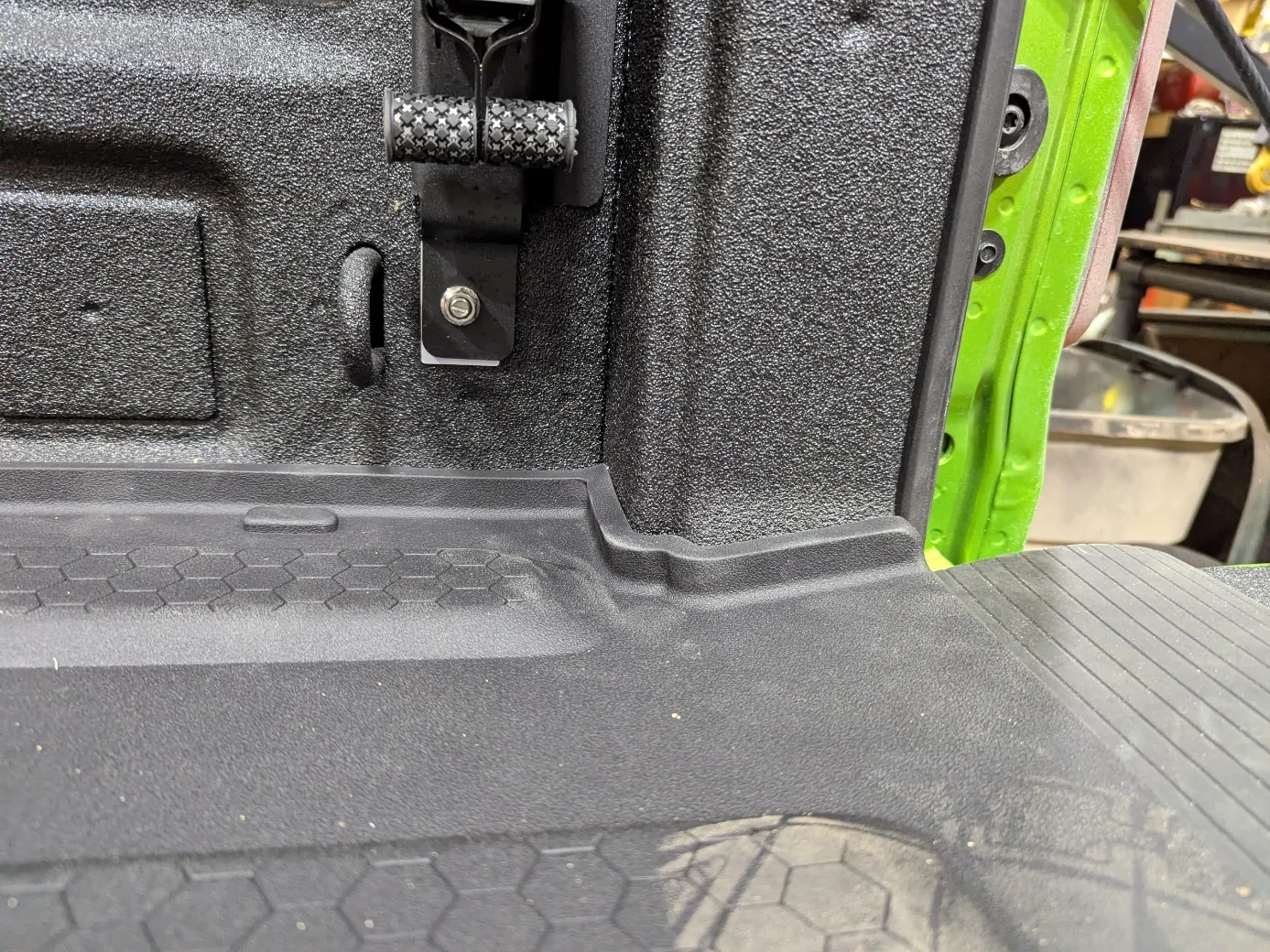

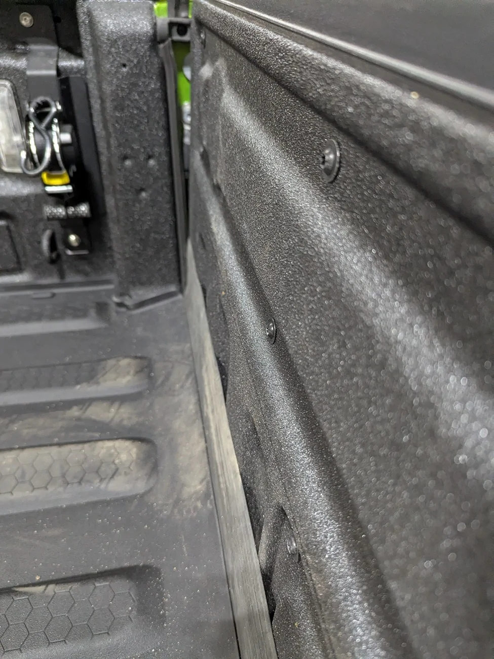

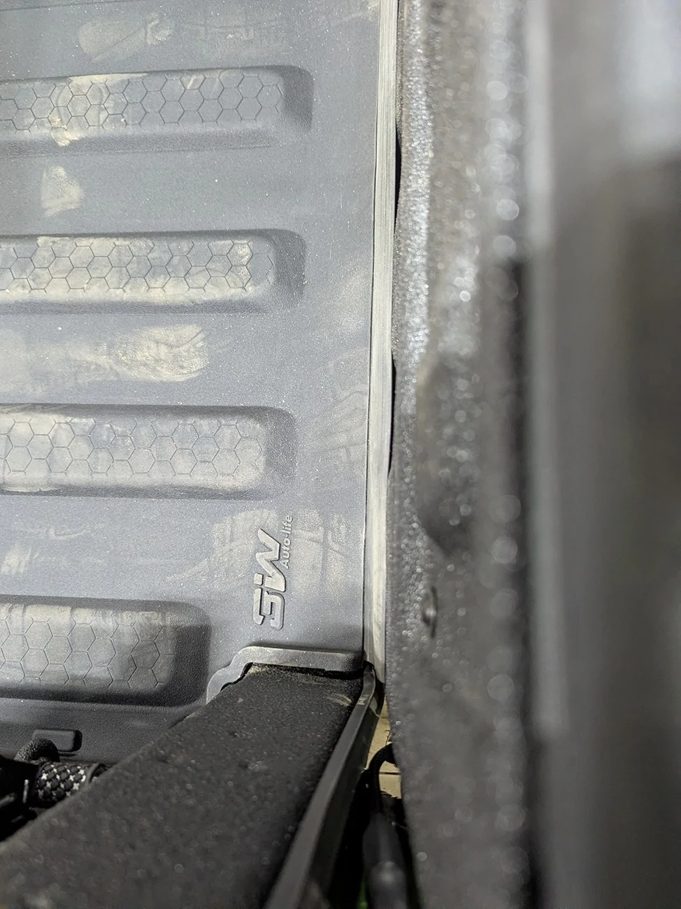

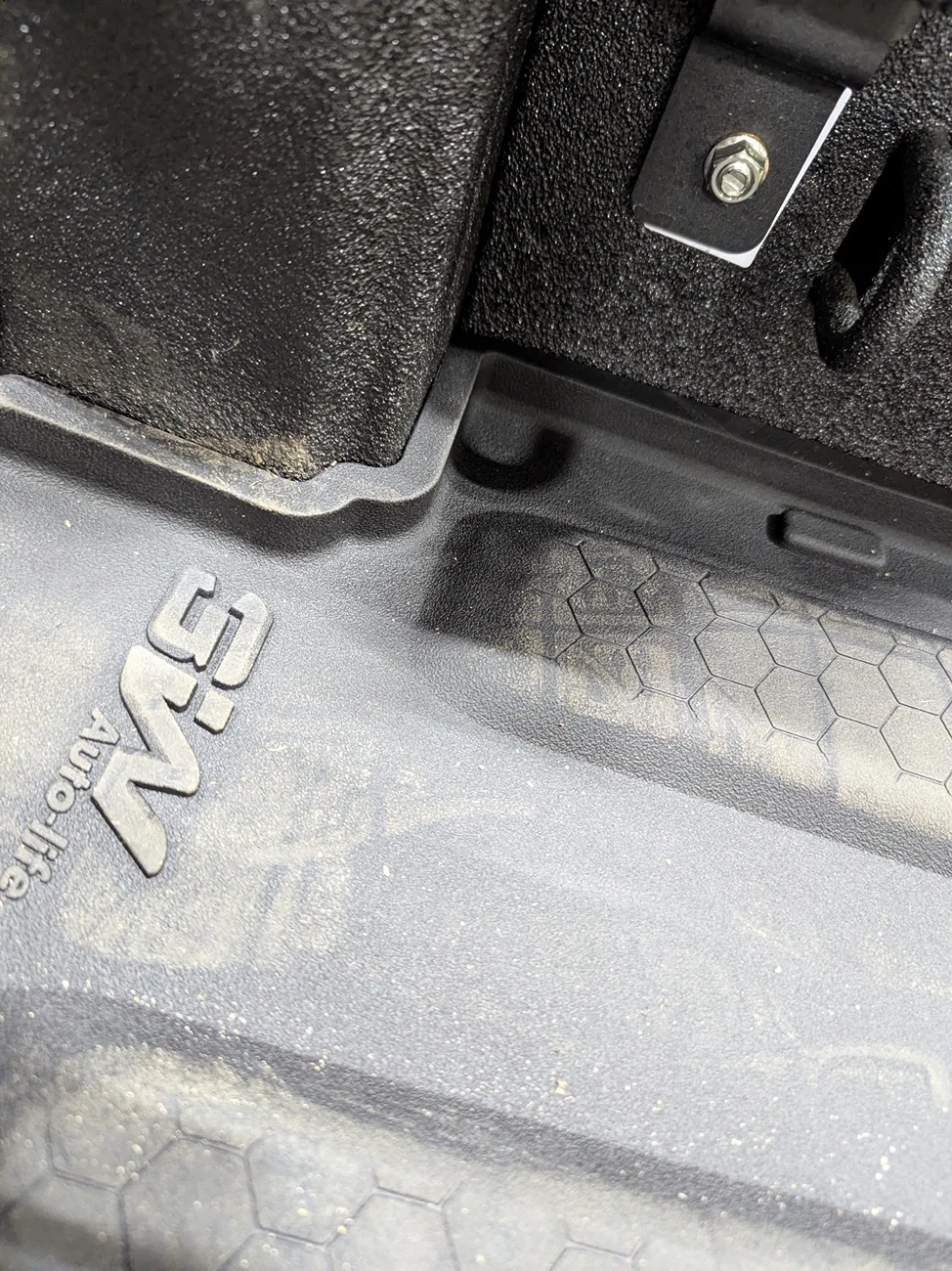

The fit back here is amazing! Not too tight, no gap

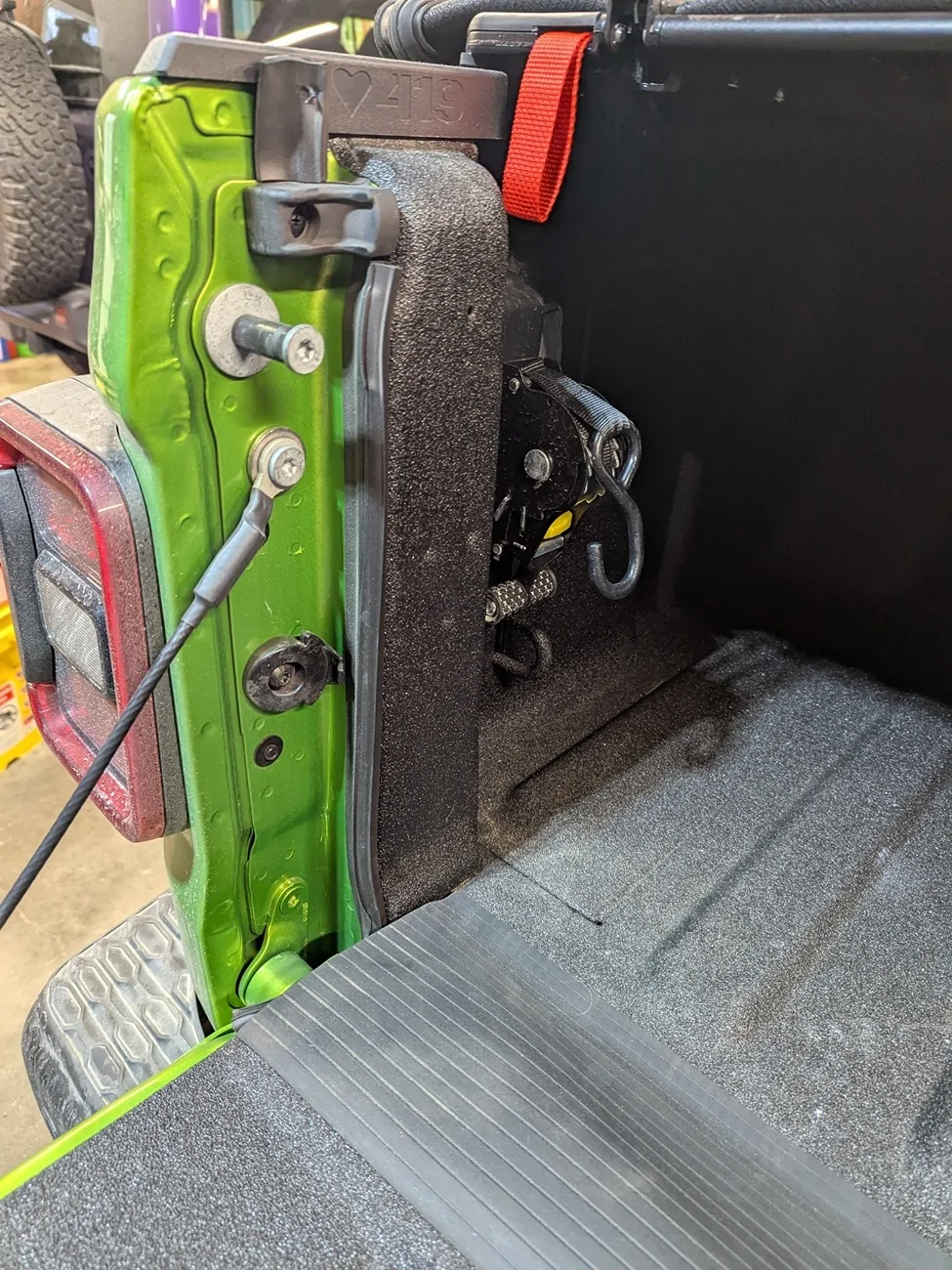

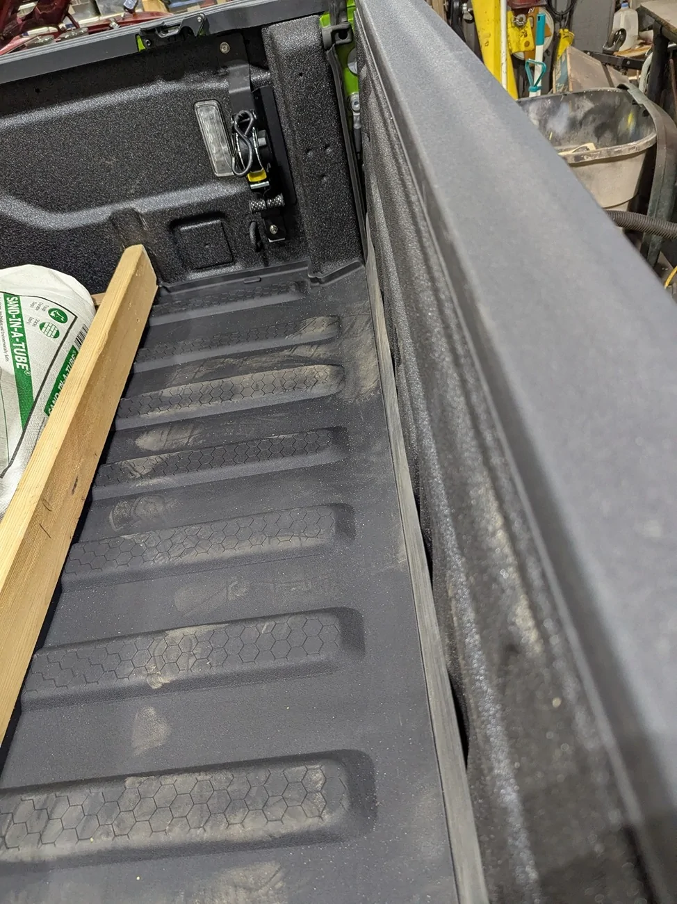

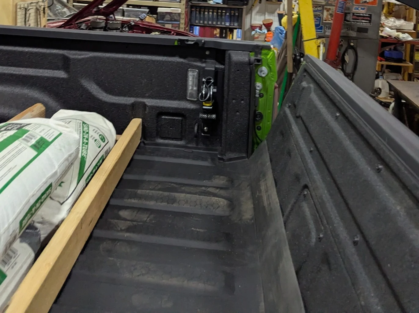

The tailgate gap filler needs to start folding or rolling up back here, about an inch under the back edge of the mat, so the mat prevents that.........
Jeep Gladiator Installed and checked out the 3W bed mat PXL_20260105_221621490
This is as far as you can close it without forcing it or lifting up the rear of the mat with that filler in place.
So, do I trim back the mat a bit??????????????

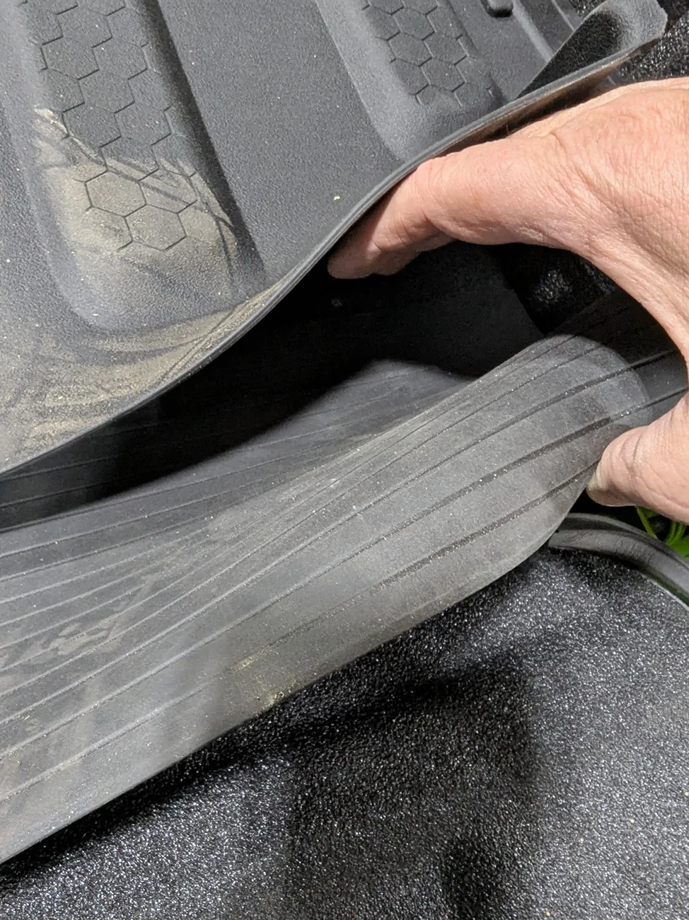

The problem is that the bed to tailgate gap filler "hinges" on the bed floor but about an inch from the rear of the bed. When you close the tailgate, it "rolls up" .
The mat prevents that. I don't want the mat held down, that would prevent the closing of the tailgate because the gap filler can't roll up.
When you close the tail gate - this piece lifts up. The mat prevents that, so the tailgate can't be closed with both the mat and this gap bridge in place.
Until I decide what to do, I'll have to prop up the rear end of the 3W mat so I can close the tailgate.
(or cut at least 1/2" off the rear of the mat to allow this piece to hinge up as the tailgate closes)
I don't want to give up this seal! It keeps crap from getting in, and allows you to sweep stuff out without it falling into that gap.

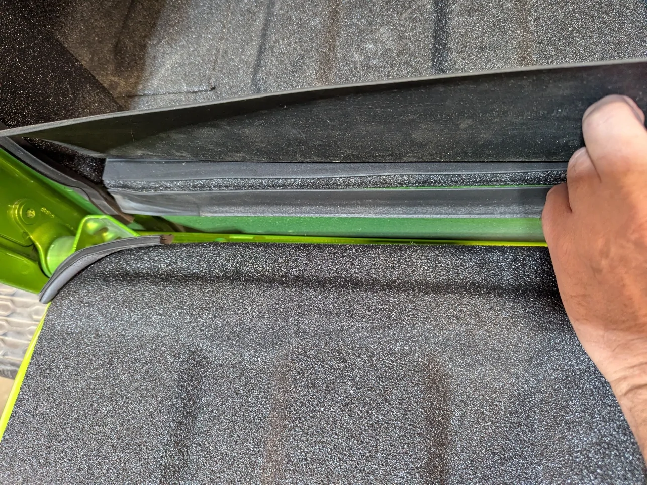

It actually "folds" or hinges up.
when the tailgate is up - it does this - and look at where it attaches to the bed floor -
There are only two alternatives - cut the bed mat, or take off the gap filler and buy a new one and apply it to the mat itself.
The mat comes clear out to the end of the bed, but this has to HINGE or pivot up about an inch in from the end.

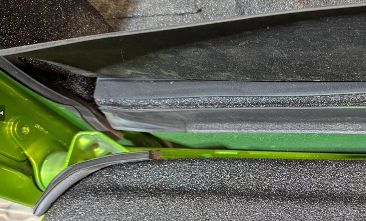

This how the seal is with the tailgate closed - so it actually prevents snow and dirt from getting into the bed, and then when the tailgate is open it flops down and bridges the gap between the bed and the tailgate.
I got tired of the snow and dust getting in when the tailgate was closed, and ROCKS getting between the tailgate and bed when it was open, and having to pry them out before closing the tailgate.
Jeep Gladiator Installed and checked out the 3W bed mat 1767661252041-5f
It adheres to the bed here - and it takes an act of congress to remove it, literally destroying it -
Jeep Gladiator Installed and checked out the 3W bed mat 1767661498194-hh

Ok. I see it a bit clearer now. I’d probably do a trim. Maybe a bit at a time until it closes like it should. To many factors with attaching the gap filler to the bedmat.
250
40,598
54,277
Yes, sneak up on it,, and take off only enough to make it work.
With the mat OVER that gap filler, then sweeping stuff out won't hit any edge like it would if such a piece was attached to the mat.

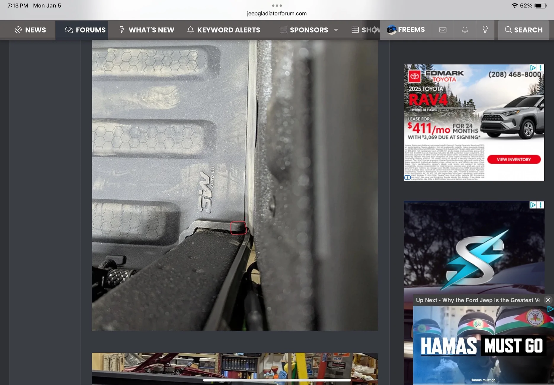

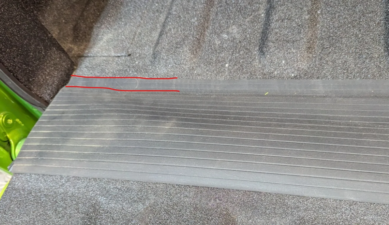

Make sure you take it out of the bed to cut, I’d do an 1/8” at a time, reinstall, lift the tailgate see where you are, measure…rinse wash repeat, until it’s a perfect fit up or down. Cut small miss small. As your trimming the mat, see pic below I marked in red and area to watch, that you might have to cope around that ridge of material, if it’s crowding the hinge material as the tailgate is closing.

OMG - lift 210 pounds of sand back out and remove the wood frame holding the sand bags! Ouch!
