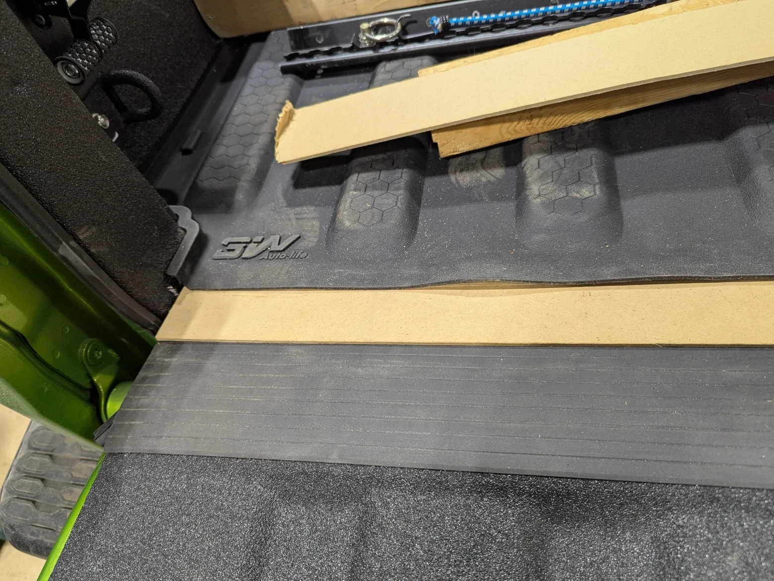

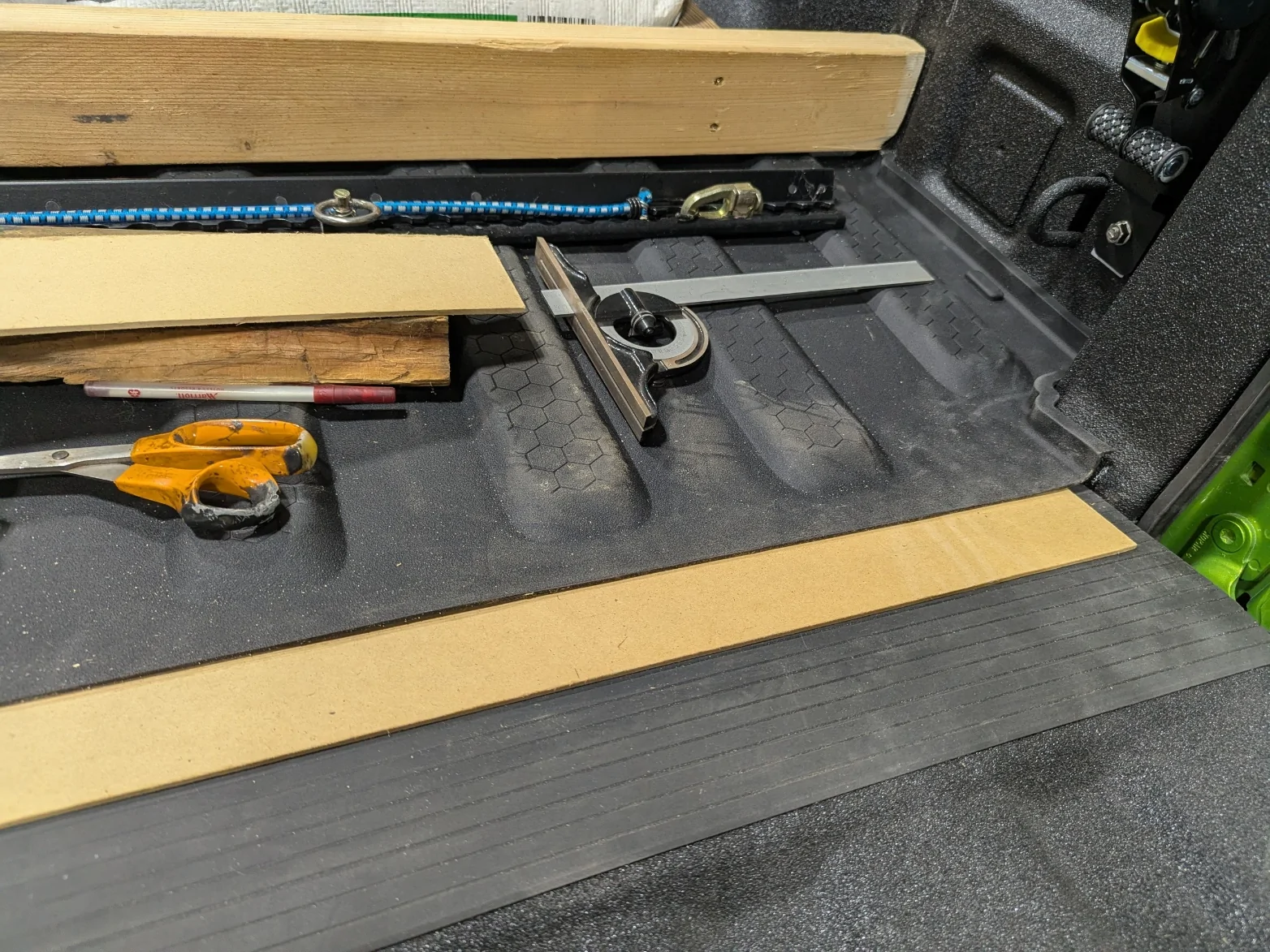

I have the exact same setup, Bedliner and gapshield. The tailgate end of the gapshield slides up the tailgate when closing. Mine opens and closes fine and both work great. Is yours not hinging correctly? Installation looks just like mine.
There was so much pressure on the gapshield thing, the tailgate was almost impossible to close. The mat wanted to fold it in an unnatural place.
Resolved now, though.
In the end, I ended up cutting the mat back to the place the gapshield hinged on the bed. This made it better two ways - the shield worked as if there was no mat, and the end of the mat is now on the low point of the shield making it almost as if they were made to work together.
I made 3 cuts and tested each time - it ended up at 1" to make the shield hinge where it was made to hinge and not fold in the middle.
No way I was taking that mat back out - 210 pounds of sand bags I can barely lift!, then to remove the wood frame holding them? Nope.
So I went upstairs, grabbed a long strip of 1/8" masonite to shield the gap shield from the knife and protect the knife blade, and used another as a straight edge. I used my square to make lines with a pen. The silver marks seen are where the gapshield "hinges" on the part that mounts to the truck bed floor.
Jeep Gladiator Installed and checked out the 3W bed mat PXL_20260106_173505424
Jeep Gladiator Installed and checked out the 3W bed mat PXL_20260106_173508470

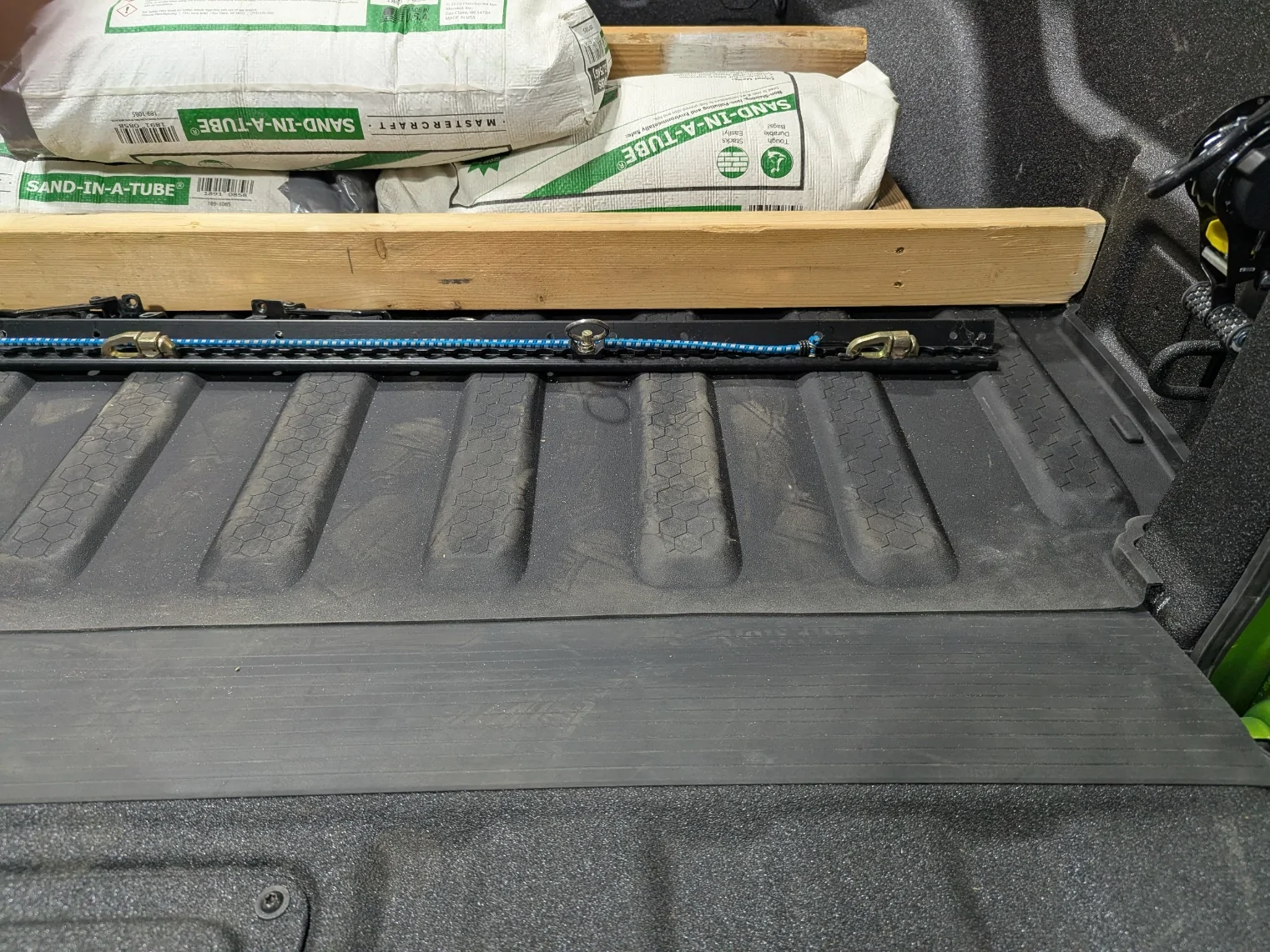

Tailgate up, working great!

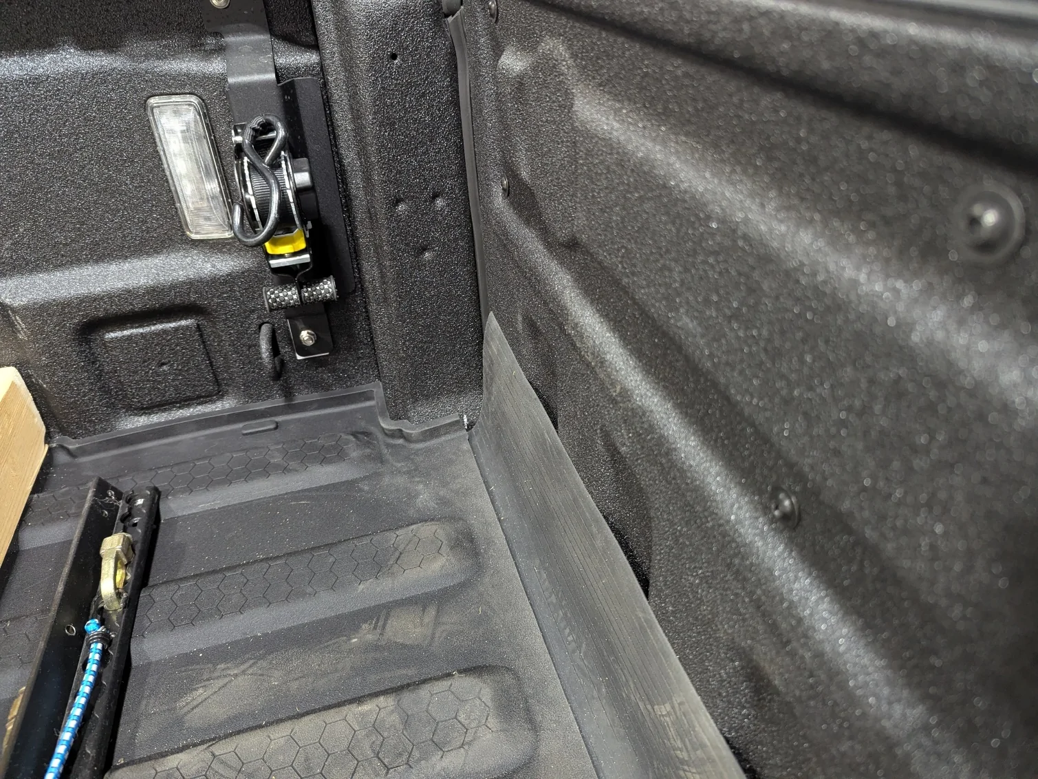

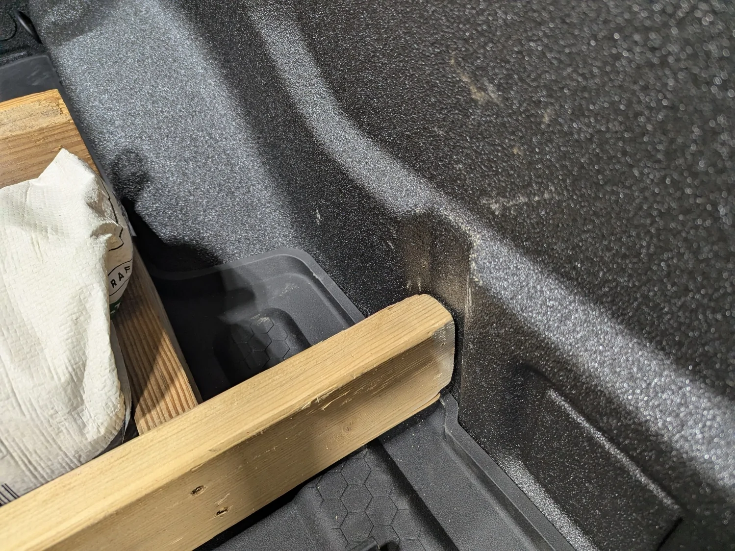

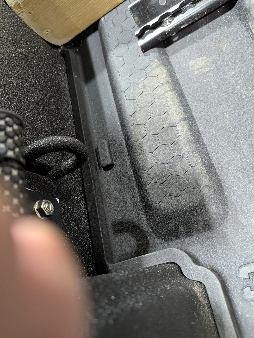

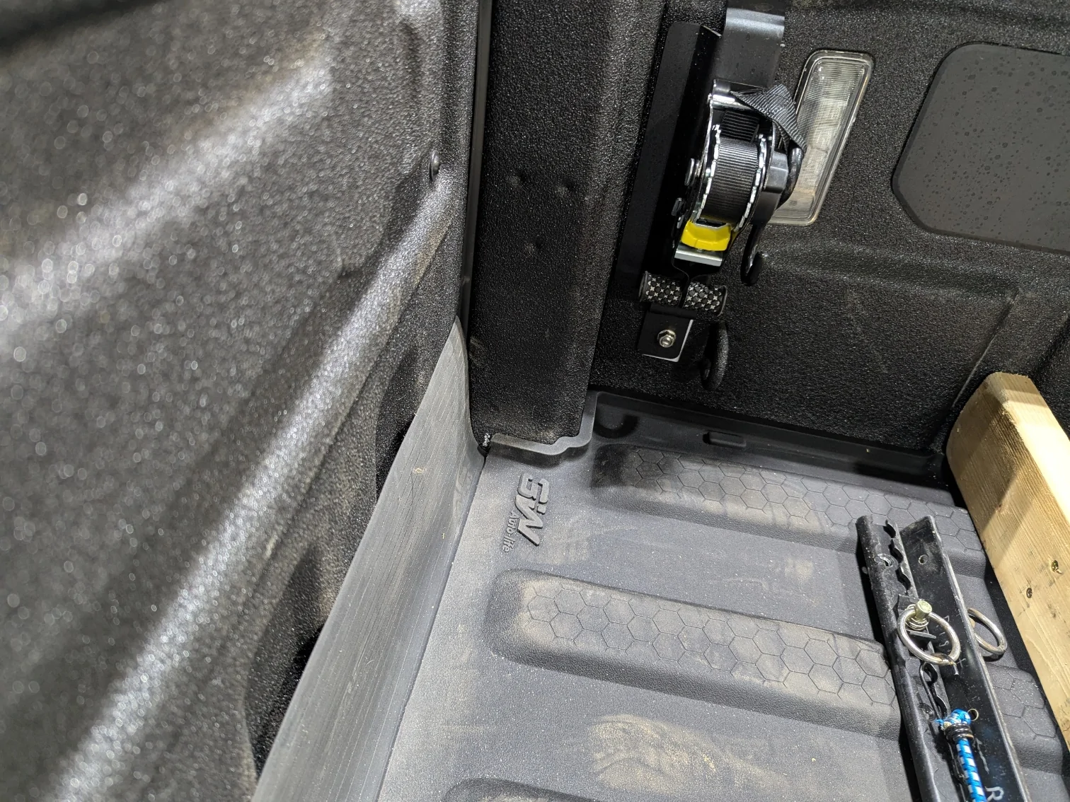

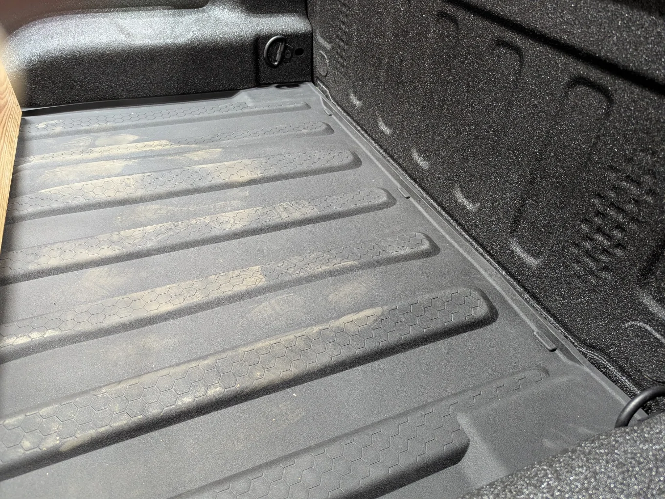

Nice fit elsewhere, too.
Jeep Gladiator Installed and checked out the 3W bed mat PXL_20260106_175535071
Jeep Gladiator Installed and checked out the 3W bed mat PXL_20260106_175542347
Jeep Gladiator Installed and checked out the 3W bed mat PXL_20260106_175558553
Jeep Gladiator Installed and checked out the 3W bed mat PXL_20260106_175523344
Jeep Gladiator Installed and checked out the 3W bed mat PXL_20260106_175612122

That looks great. I second the fit and performance. Spray in liner protects the truck, 3w bed mat protects gear and knees. I installed the gapshield and ESI Ultimate Tailgate Seal primarily to keep dust out.
Questions? 1) do you attach that versatrac to your 2x4. 2) what’s your assessment of winter driving with the sandbags? Thanks
40,480
53,965
The track is there to remind me that I need to reinstall it in this truck along the tops of the bed rails. It will go on the sides of the bed like the trail rails or whatever MOPAR calls them.
The sandbag weight is there to help balance out the 300 pound snow plow when it's mounted on the front.
It doesn't hurt on some of our roads and highways with snow pack, but if not for the plow, it probably wouldn't be there.

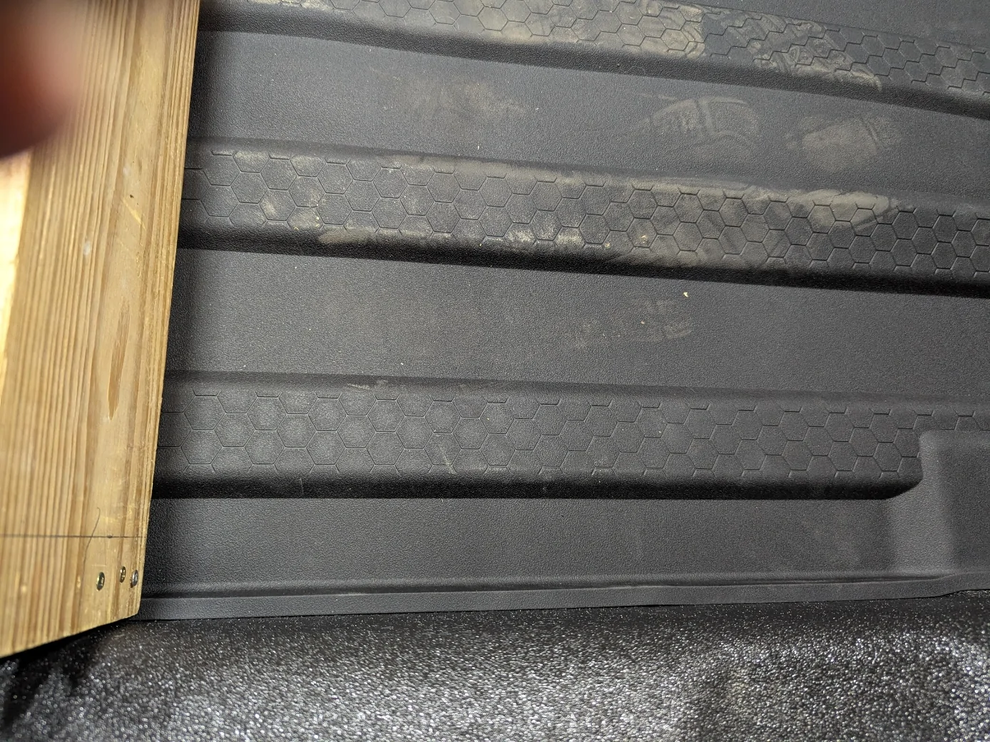

Heck, I sleep in mine, too - the corrugations - never an issue.
I want the corrugations there - keeps boxes and luggage up off the bed floor and allows water to run under cardboard boxes or bags or luggage.
I'm really glad this mat has them and is form-fitted. I've had a flat mat before -any time water got in, stuff got soaked.
This mat will never move around - the snug fit all around, the STRONG magnets, the form fit, it ain't gonna move, trust me.
If the corrugations were an issue - I'd know about it. One of the things that goes with severe ADHD is what they call "princess and the pea" syndrome. If there's a wrinkle in a sheet or pillowcase, I'll know it and not be able to sleep.
For weight - with only 850 pounds payload, I don't exactly want a 50 pound mat back there, this is plenty heavy enough to prevent damage unless I'm loading up an engine block and drop it.
So in short, I'm 100% fine - and happy with - this mat. It holds stuff up if water gets in, it isn't possible for it to move around or shift out of place, it's easy on the knees and hands, I can use the tailgate as a work area and toss tools onto it and it's quiet and safe if I'm clumsy about it.

I really like mine and alsonI dont have the gap filler
But it would probably help to make a perfect fit for you , I just feel like unless you cut a couple 2x4's to clamp down tight on each side of that mat before trimming it will be difficult to make a straight cut .
2x4s would get in the way of the knife, and frankly, using masonite as a straight edge worked great. Several shallow cuts got it.
