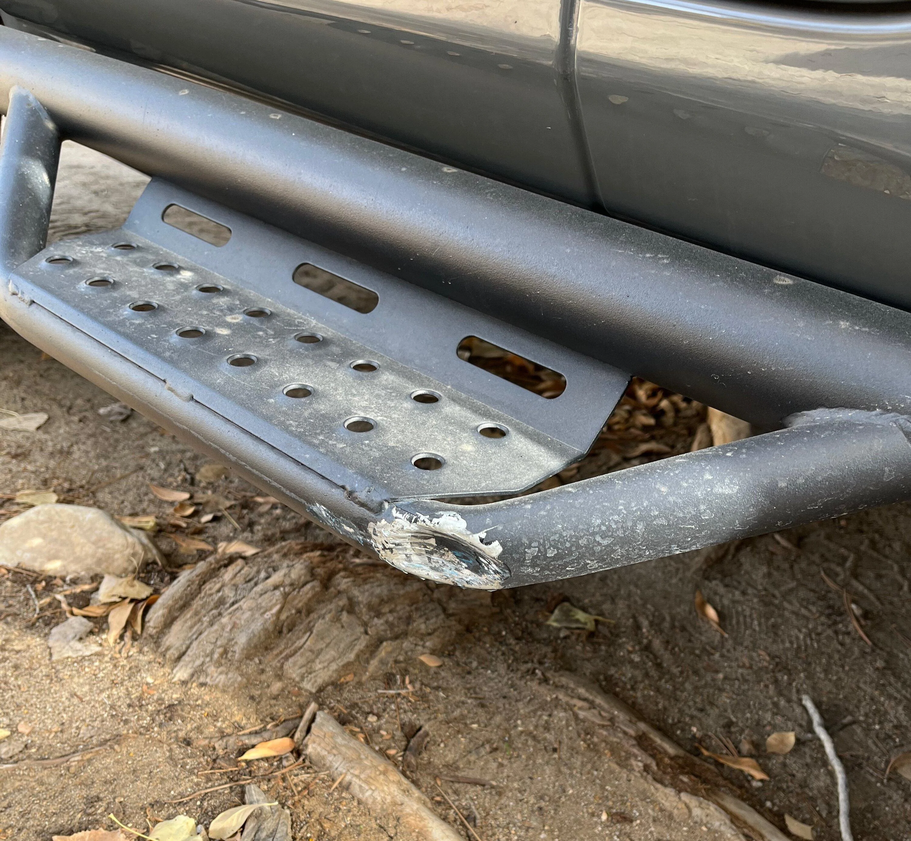

Anyway, while on the subject of my travails while RV camping I did this to my passenger side rear NFab step bar. SEVERELY pisses me off!
Pulling out of the campsite, I hit a big boulder used to define the parking spot. What you can't see in the photo is it also slightly bent the whole bar toward the body in the center. My son says it gives me 4x4 "cred". I think it looks like crap and will fix it. Thinking using a hole saw on the reverse side, using a rounded punch to drive out the dent as much as possible. A little filler, texture and flat back and it won't be noticeable.....except to me of course. I'll weld the hole shut after.

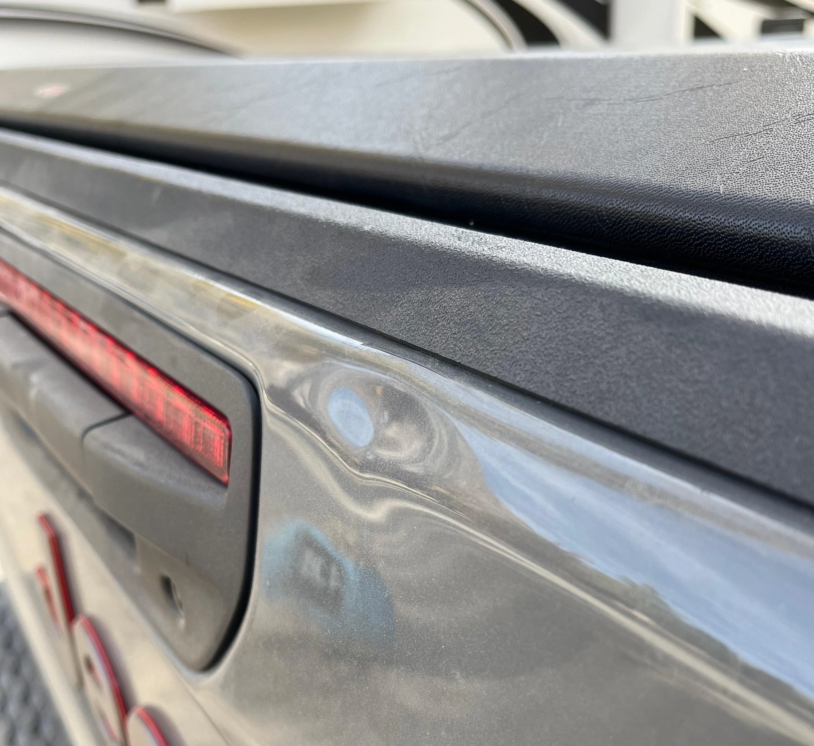

Also while bitching and moaning, I noticed I lightly dented the tailgate somehow. NO idea when or how I did it but a Paintless Dent Removal (PDR) guy I used before should be able to get it out.
Before you inevitably say, "It's a truck, it's SUPPOSED to get used and abused". My attitude is, "I don't polish turds". If I don't fix things as they happen I begin to lose interest in the vehicle. Having payments on something that's getting more and more beat up pisses me off!

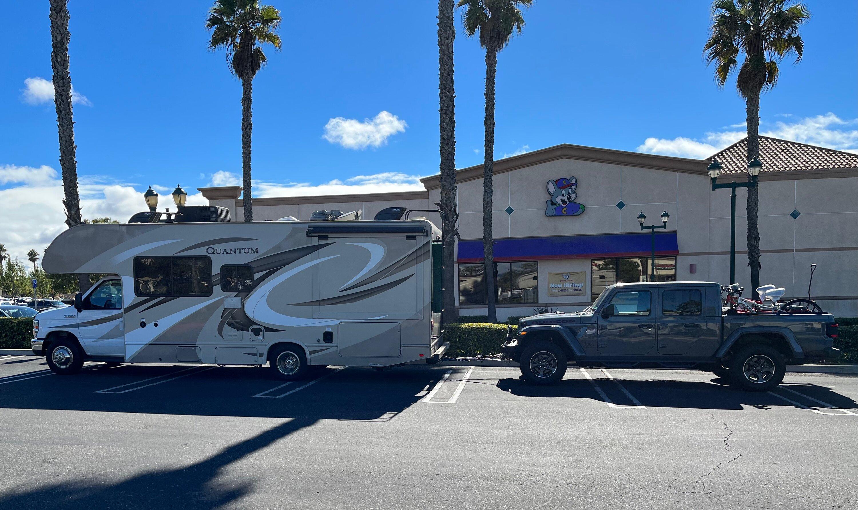

Oh, I forgot the "money shot". Here's the rig connected. Tows fine, no issue at all. I got an additional "cigarette lighter/12V outlet" added in the driver side under dash area. Brake controller worked fine this trip.
