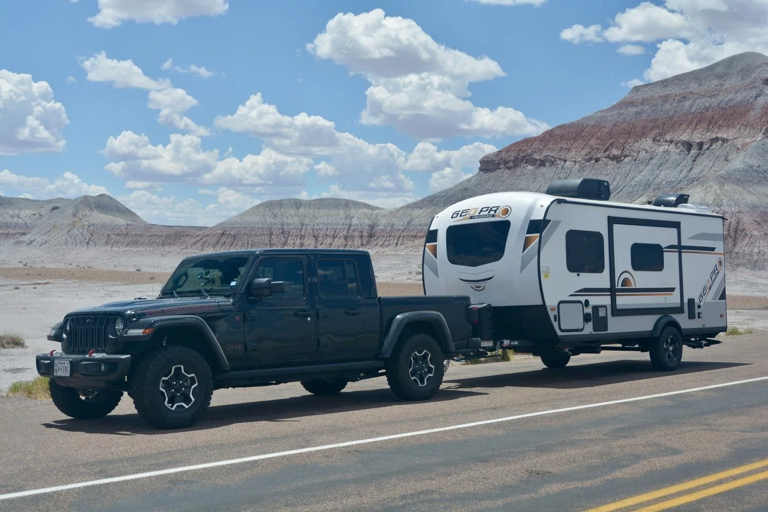

I've used my '21 JTR to tow my 20' GeoPro all over the mountains out west and through the desert, plus lots of places here in Texas and I've never, ever had a problem with overheating.
Jeep Gladiator Rubicon, would installing the "open hood vents" improve cooling when towing? MVF_4208
11,444
30,505
From what I've read both here and other boards, the 3.0L Eco-diesel needs all the help it can get when it comes to cooling. Stone stock diesels have overheated while towing and as a result, the PCM throttles them back to barely move...I've read 25 mph max until they cool down (meaning pull over and let the engine temps drop back). I've also seen (anecdotally) the Eco-diesels becoming Car-b-ques from overheating while towing in high heat situations.
Having said that, I'd leave well enough alone for max air flow around your engine and it's cooling components, especially seeing as you're in Arizona.
Not every one is like that.
