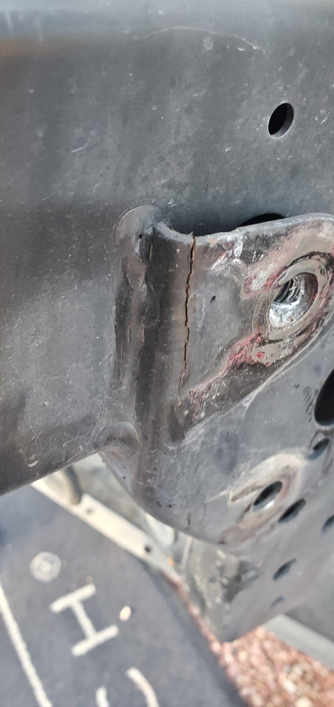

so , after 2000 miles in towing my JT with the Maximus tow loops , as i also do i check the hooks to make sure they are not coming loose, well today ... i notice alot of play in one of the hooks, well as it seemed the frame is cracked where the loops bolt into from the bumper , so i now need to weld that portion , i will probably take them off and go another route
WOW!!! Very scary and good thing you checked!!! What are you thinking of going to for tow loops?

I am going to put a DEMCO base plate , it seems to be the sturdiest, one thing i had a problem with at time was getting the tow bar clevis at times when the jeep was not perfectly straight. i think it was the length between the loops , typical that i have noticed on most plates is 19 to 24 inches.

seems like the Ready Brute tends to bind up at time , then i have to use some pliers to pull those pins. We travel alot so when you go 10k miles in an RV hooking and unhooking trying to find the easiest , i really like the Maxiums tow loops with the look , but with this last trip it cracked and leaving that tow hook dangling .. that leaves me uneasy to note it happend and will potentially happen again. so will try another route.

If the hook came loose I can see it cracking. Do you check everything after each tow ? I only ask as on our first 5K trip I found many bolts not torqued to spec after the trip. I did it in a hurry before we left and equated it to that. I toss a socket on every bolt before each trip.

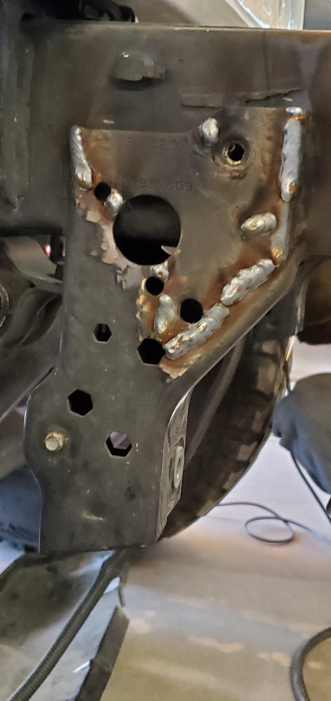

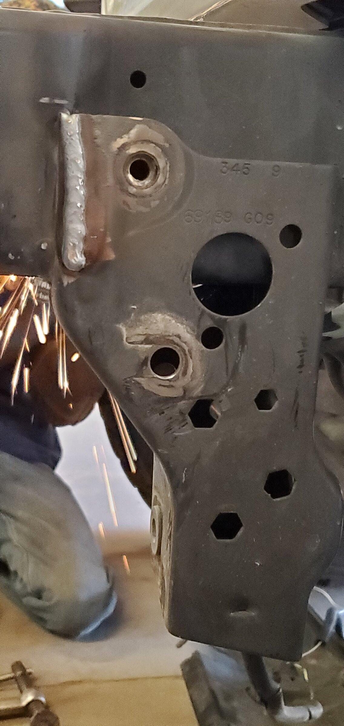

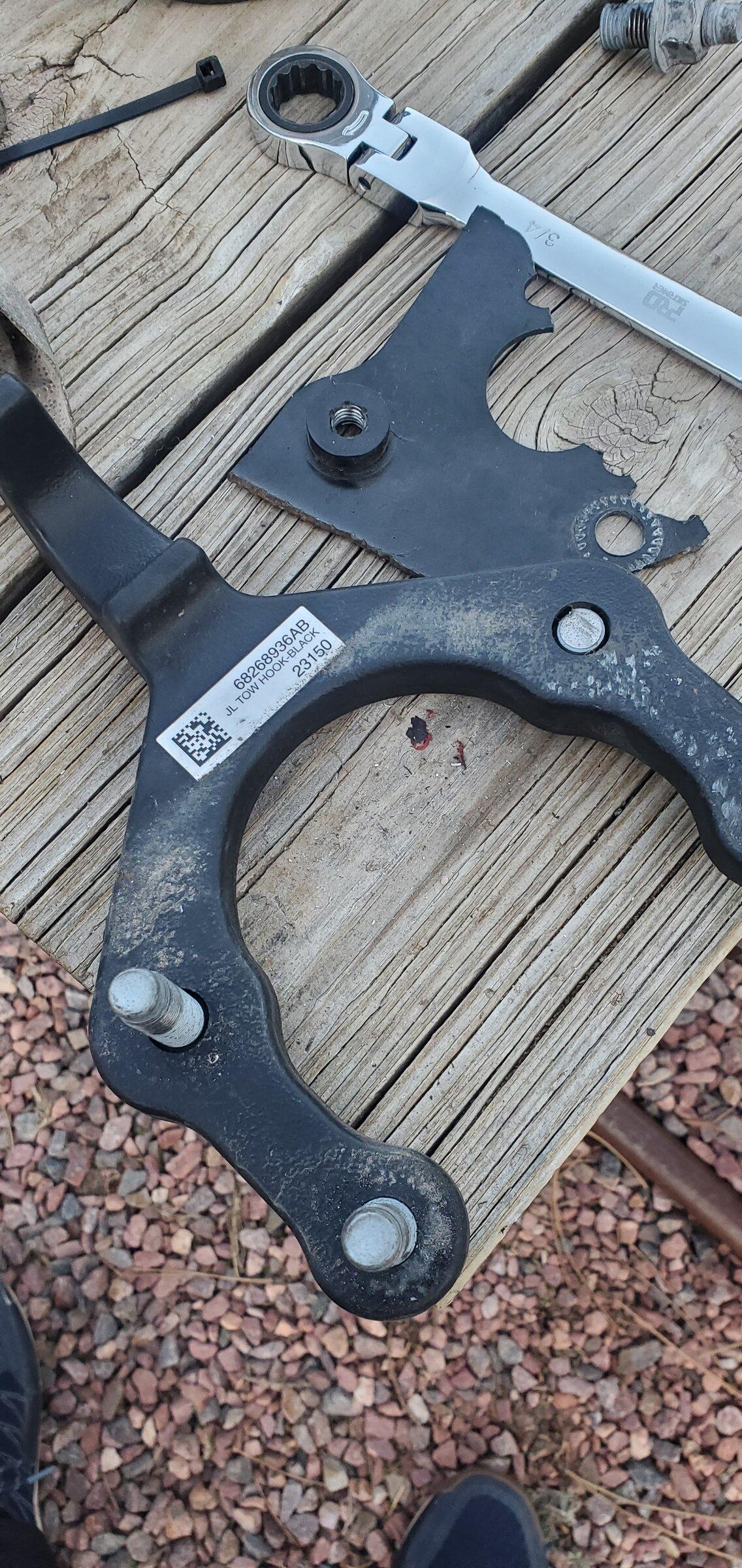

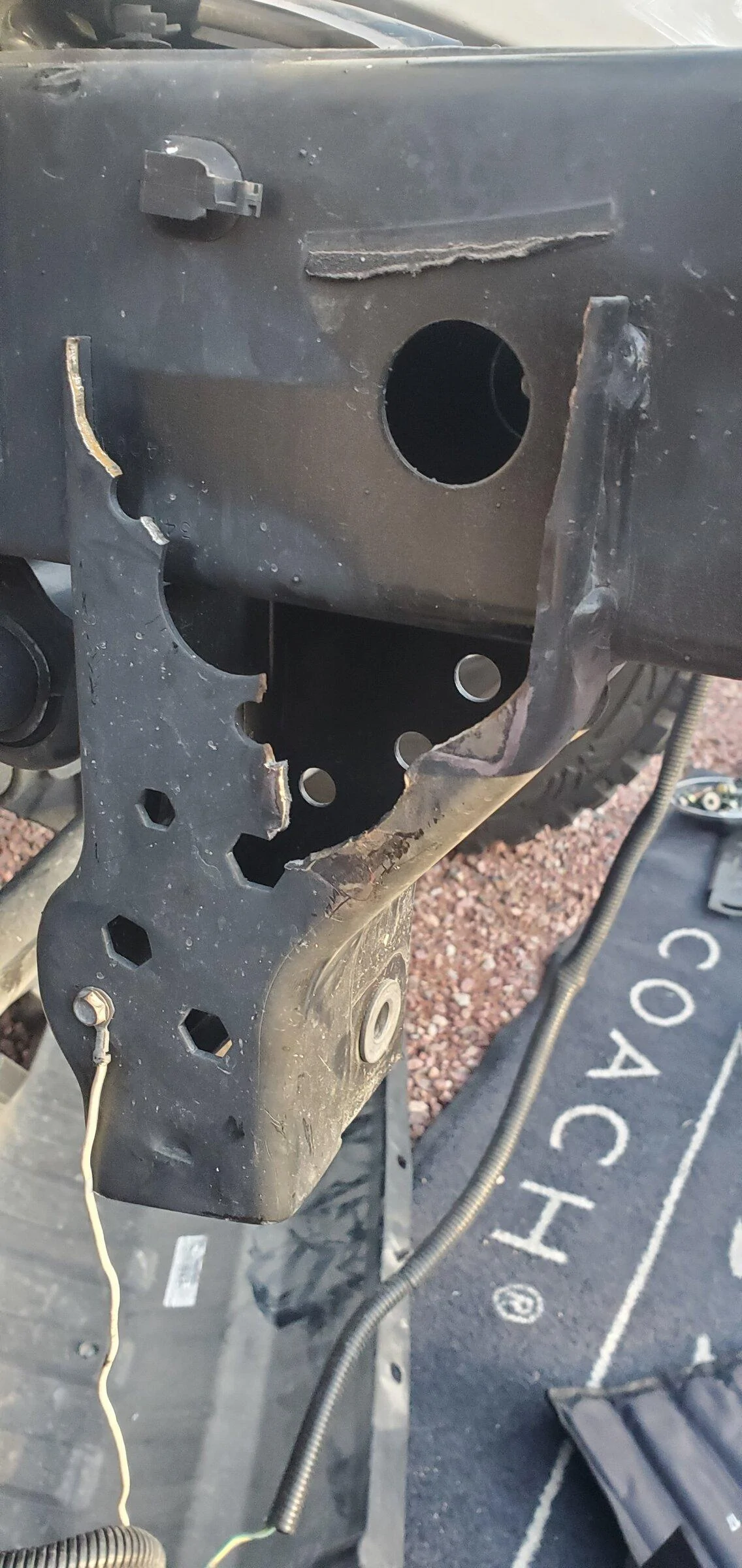

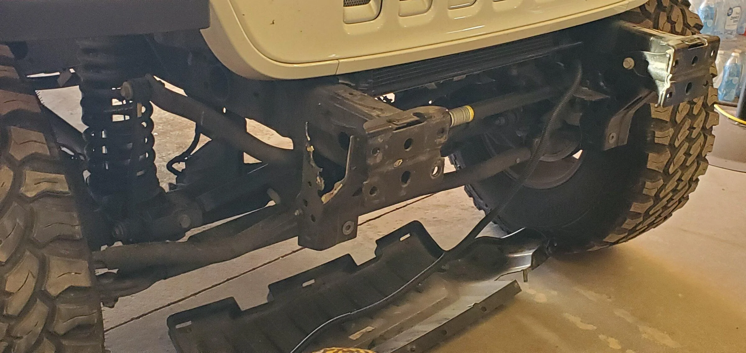

So as a follow up here on this issue , here are pic from the damage of the MAXIMUS TOW LOOPS. I had to get the pieces welded , The Driver side also stared to crack . On picture shows the TOW HOOK bolt broken as well on the passenger side . The driver side was hard to tell that it started to crack until i took the hooks off as it was hidden. I have spoken to a few others that have had this issue. So just keep an eye out. I product is solid but the design on how it is bolted on lack support , too much force is given causing this issue .
That damage looks like it was mostly caused by sideways stresses on the tow loops.
Maximus-3 is aware of the issue, see this post...
https://www.jeepgladiatorforum.com/...ng-jtr-with-37-tires.43080/page-2#post-925078
...and the few following it.
