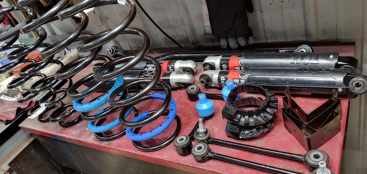

Is anything missing from this rubicon take off?

Like a Mopar 2" or larger lift.......
yeah the owner i bought it from put a mopar 2" lift on his JT LE I believe.

No need for lower control arms or bump stops. Installed Rubicon take offs on the front of mine and didn't replace anything else.

2" Mopar comes with bump stops because they are needed due to the longer springs and shocks.
No change in bump stops is needed to install Rubicon springs in a Sport or Overland.
Shop is thinking they are installing a "lift" which they are not, they are doing a factory spring swap.
Parts not needed.

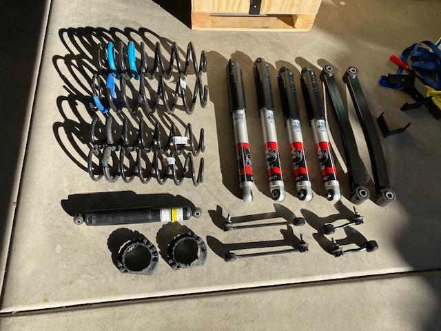

This picture below is what they just gave me a few weeks ago when I did my Mopar lift at the dealership.
The only difference see is I paid extra for the front steering stabilizer shock that was replaced with the upgraded / matching FOX shock that is silver and looks the same as the new silver ones from the Mopar lift. So I see my picture has the factory black shock and yours doesn't.
