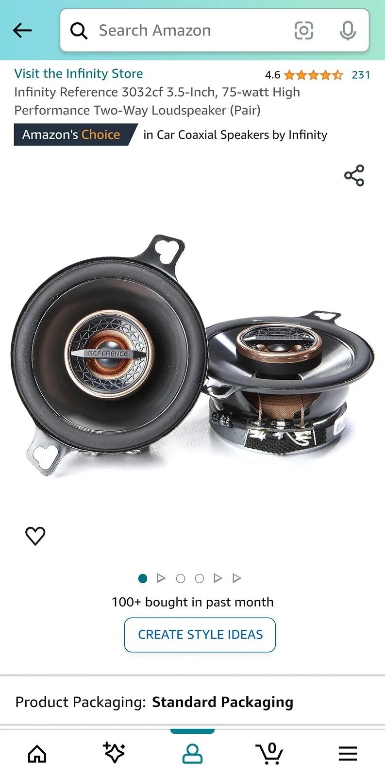

I put a pair of Infinity's ($54) in the dash and Alpine's in the roll bar with an amp.
I didn't replace the lower dash speakers.
Replacing the dash speakers made a big difference.
Jeep Gladiator Is it worth it to change the lower dash speakers out Screenshot_20240429_161902_Amazon Shopping
