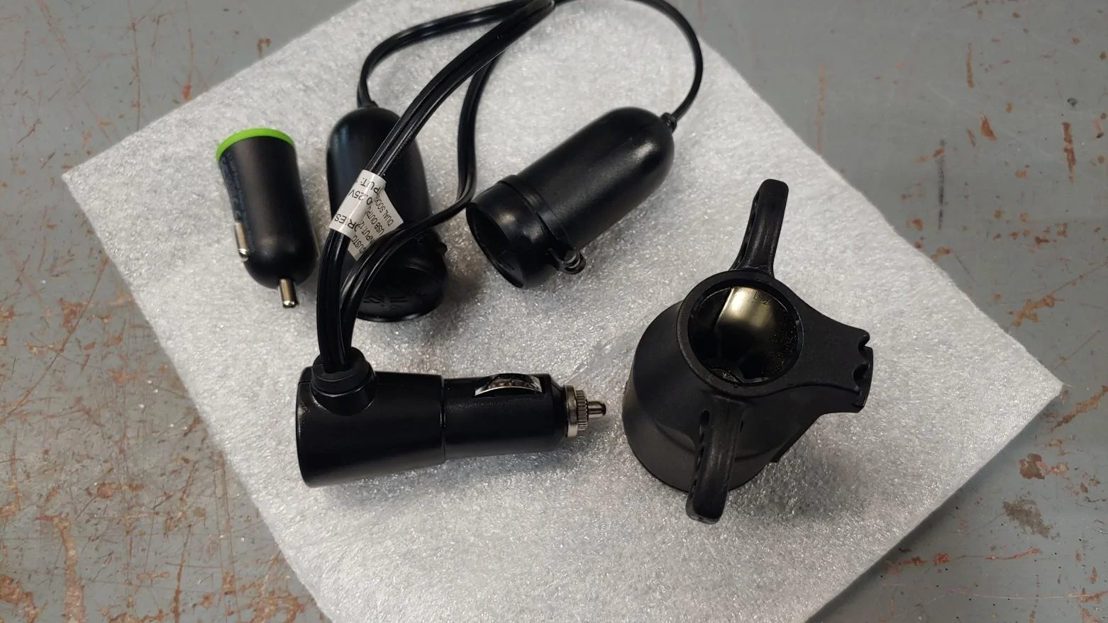

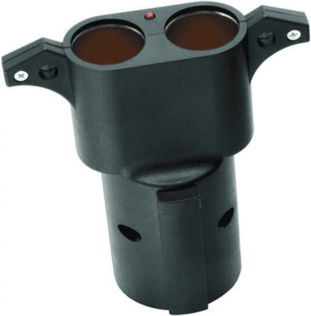

Yeah, that's what i showed.
I have one, a single but with a plug-in splitter that gives me 2 12v outlets AND a USB charger, but I want the power in the truck bed as I have a truck tent and want t have things inside while charging.
That's why we're talking the curt harness so we can route power up into the bed of the truck.
Where would you have the power come in? Just leave the cord dangling?
