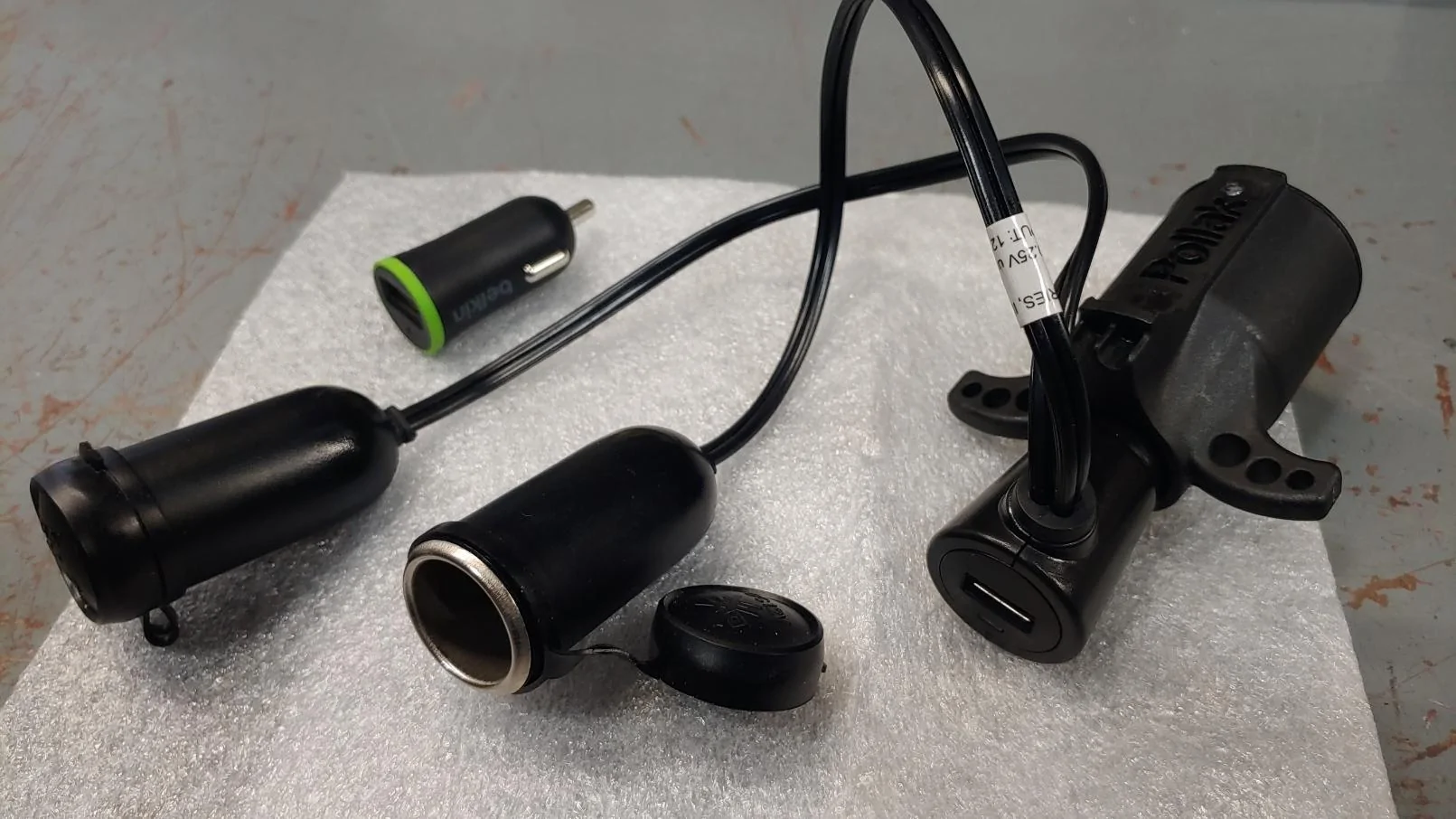

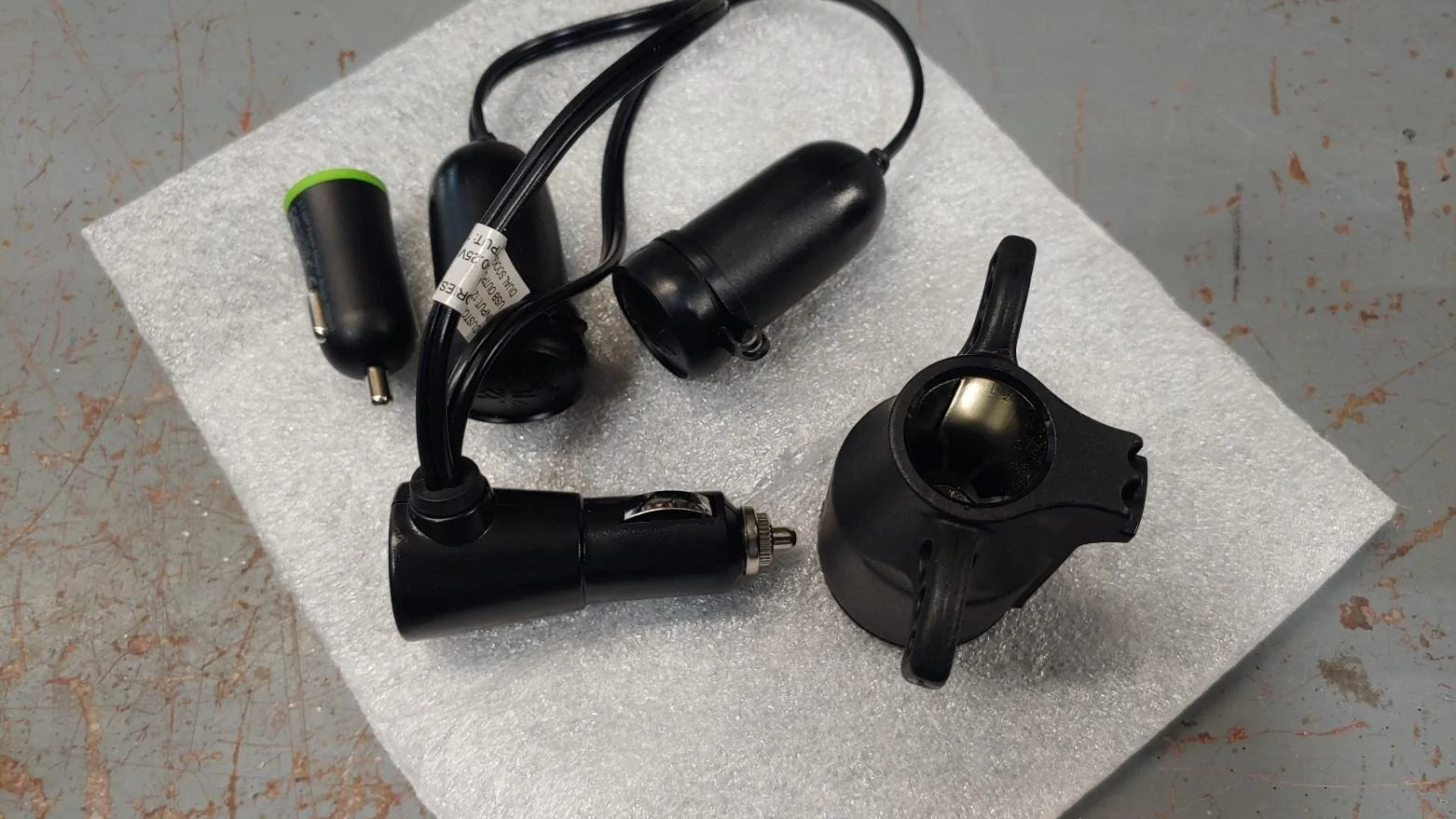

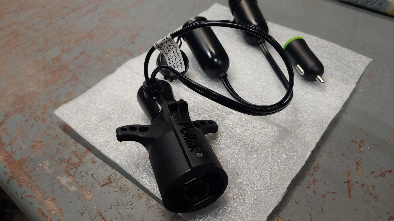

Frankly, if all I need is 12v, I have a fast, cheap solution! ?
I have an adapter that plugs into the trailer connector and give me a 12v outlet. Then I have another piece that plugs into that and gives me 2 12v outlets and a USB charger.
And I have another UBS charger I could plug into one of the 12v outlets

Did you order the chargers that way...........?
Your trailer adapter is pretty cool!
