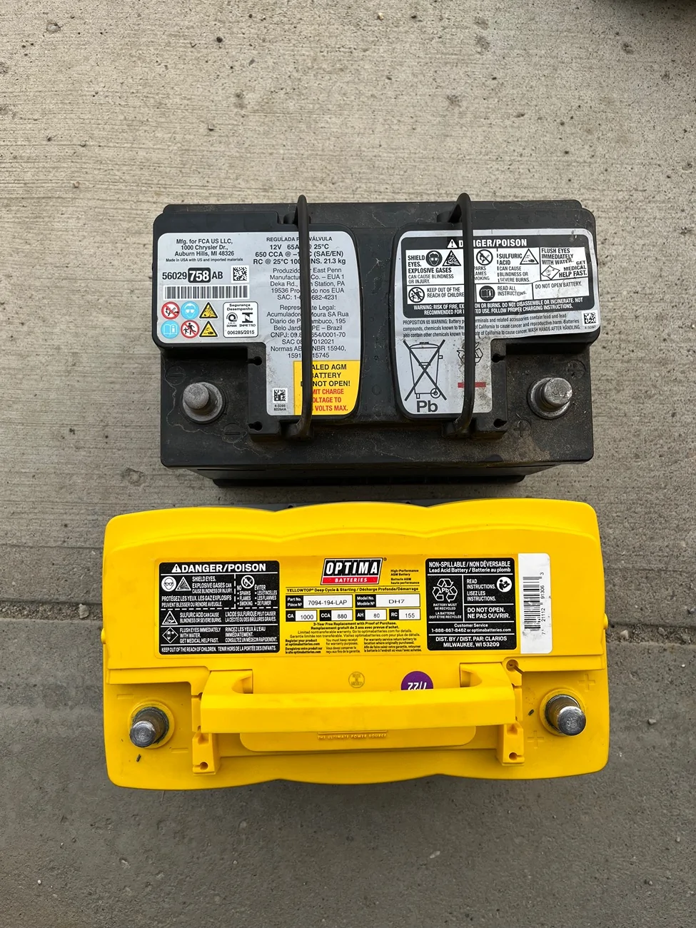

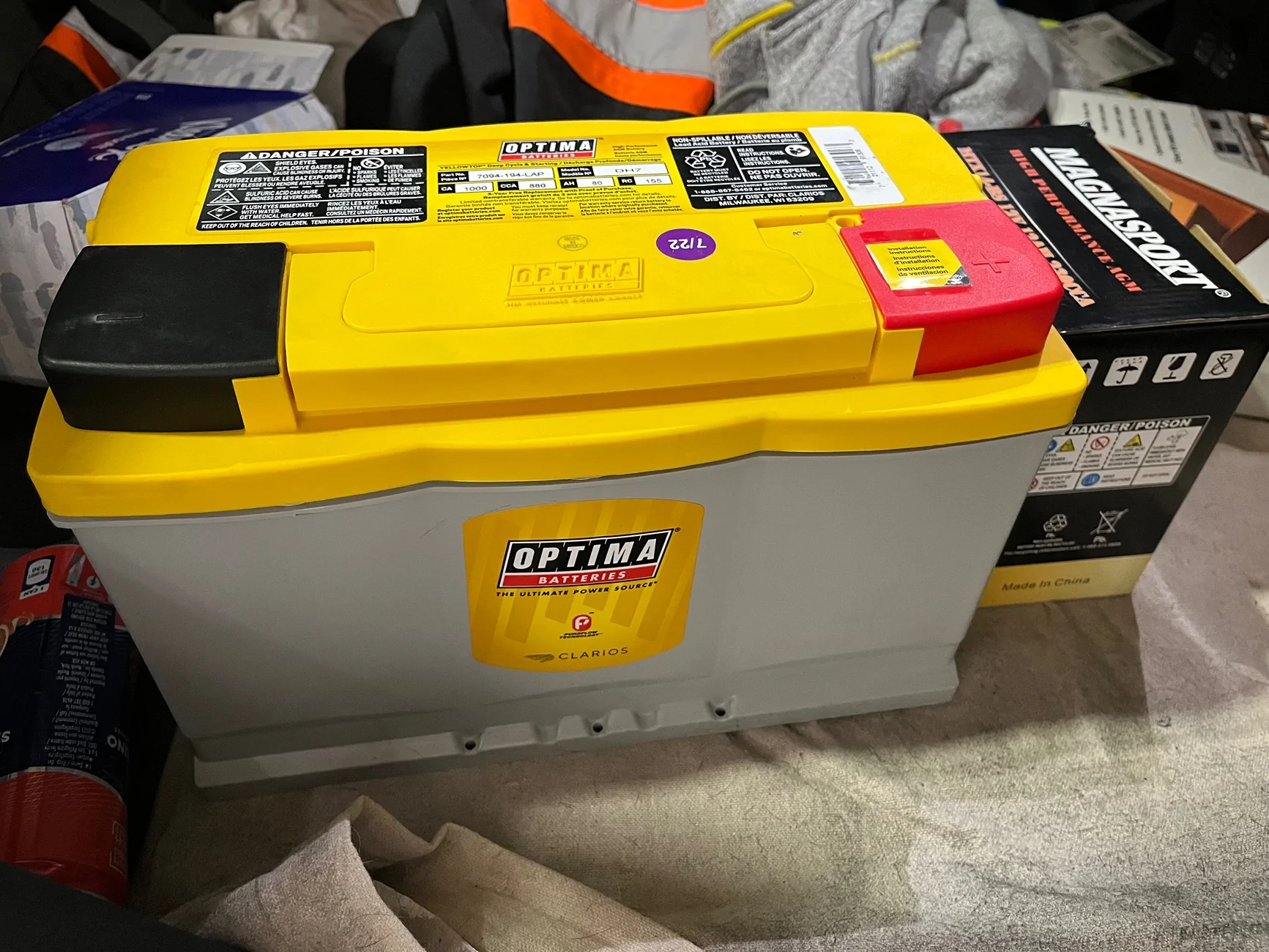

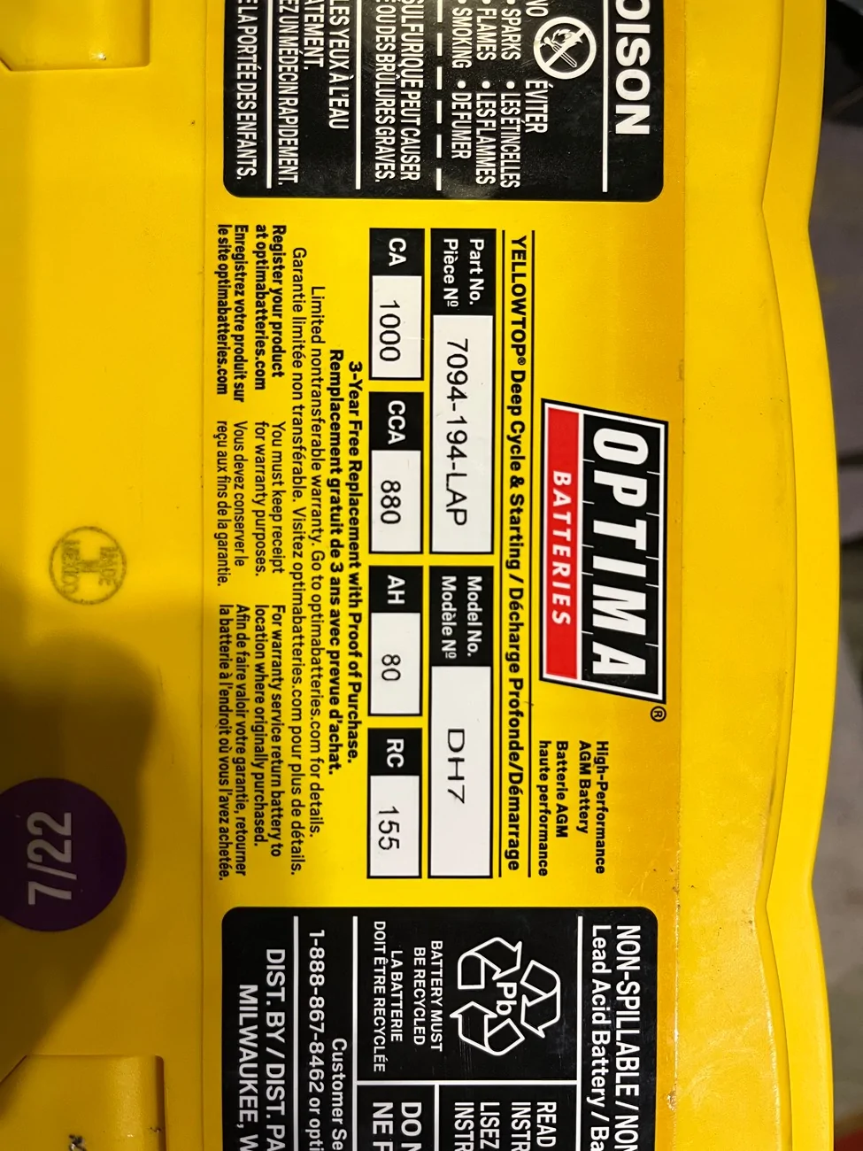

This is the upgrade to my batteries. For the main I went with deep cycle/starter Optima DH7. I wanted it to be the biggest I could get to fit the space. I believe in the 2 battery system as it’s designed. It works just fine if the AUX battery is healthy and LORDCO Auto recommended one that was 220 crank amps as a pose to the 200 Mopar’s is. This was back in 2023 and batteries are still working as they should.
I got tired of having to plug in the trickle charger every couple of days or so and the noticeable low V was always a concern, so it was time for them to go.
Now, after all these months, I rarely go in to load test it but they do get topped up every couple of months.
