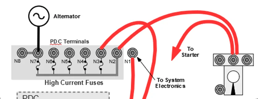

So I replaced my main with a H7. Disconnected the aux negative (labeled 2020 in the picture) and pulled the ess fuse.
Car has no power whatsoever. I'm thinking maybe the IBs? I'm on my way to AutoZone to replace that.
Any ideas????

However, when I came back home I pulled the main fuse array block and tested them for continuity and n2 failed (that is for the ess) so maybe that's the issue?

No power can either be wrong ground cable is separated and taped up. Another reason can also be the high amp Z fuse array that’s located on the very outside end (drivers side of fuse box) Are you familiar with this fuse?
40,445
53,878
So it looks like the battery sensor is a dealer only part since none of the parts stores carry it.
That's not for per se. That's not what it handles. But if that is bad you can have multiple issues. There is no "ESS fuse".
that is what I tried first, thinking I taped up the wrong negative terminal. But I swapped them and nothing. I am pretty confident I have the right negative cable to the main battery and the one I have taped up is the aux negative cable.
unfortunately the dealer (both of them) did not have the fuse array in stock. I did order one through autozone as they were the cheapest and fastest turn around. So waiting for that to come in and crossing my fingers thats my fix here

How did you test the fuse array? Did you pull it out? N2 is pretty much a bus bar that powers part of the power center. Now n3 150 amp could be what you are talking about.
The ibs is not your not power issue.
Maybe I just need a little refresher course and I'm wrong.

OK, N2 isn't a fuse. It's direct from the high current fuse array "bus" to the crank/main battery positive.
N3 goes to the aux battery.
There is no "ESS" fuse although the fuse key on the PDC lid calls N3 exactly that. But it doesn't really handle "ESS" as such. It's a direct line from the alternator output to the aux battery positive.
Oddly, even though the auxiliary battery is connected to the main battery positive through the PCR, it doesn't charge when N3 is blown. So it's more for keeping the aux battery up and of course if it fails, then ESS won't function correctly, and many other things likely won't as well.
N3 goes to the auxiliary battery positive THROUGH the PCR (a heavy-duty relay between N3 and the aux battery positive)
IBS is Intelligent Battery Sensor and yes, it's likely a dealer item.
