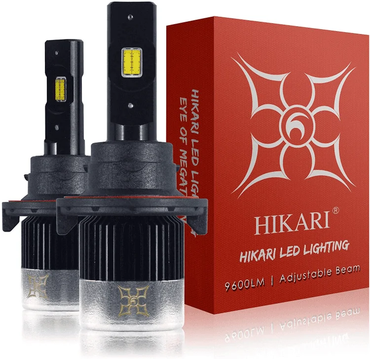

I just put these on, per someone else's recommendation within this post:
https://www.amazon.com/gp/product/B07GKCNPD1/ref=ppx_yo_dt_b_asin_title_o04_s00?ie=UTF8&psc=1

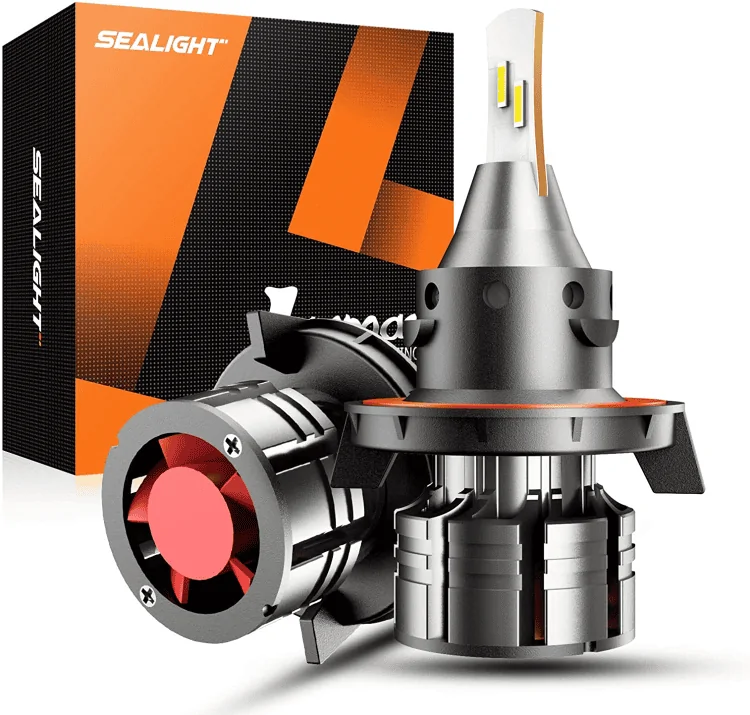

They look great -- I cannot say that they are any brighter/blinding than the OEM LED's. Need to be sure to rotate the bulb to the 3/9 position. It took about 30 minutes to install.
I also purchased the JScan app and upgraded all my settings to LEDs. No flickering, etc.
If you look at the lamps you bought, (first image,) you'll see the radiators (the LEDs) are positioned directly beside each other.
If you look at the Sealight lamps (the ones I used, second image,) you'll see the radiators are offset.

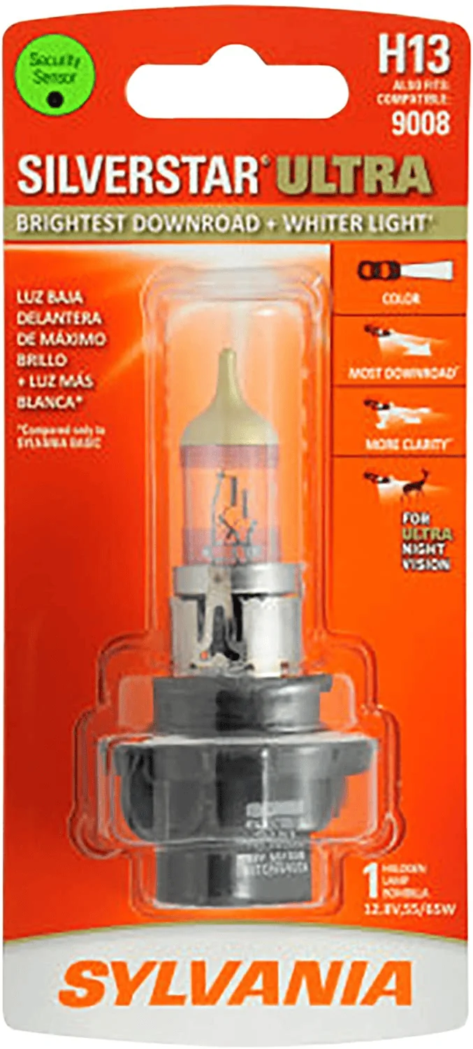

Now compare both of those to the radiator (filament) placement in an H13 lamp (third image.)

If you want satisfactory performance from your headlights, you need to use a radiator that the headlight housing was designed for.
Many people are happy with the Hikari bulbs as a fix whether permanent or temporary and are not having any issues with the bulbs, the light being put out or with getting flashed much by other cars. The constant bashing of them is not going to change people using them.
They probably work OK, as evidenced by the many using them.
I'm saying that the Sealight lamps. or ones built like them, will work better.
I see what you mean. To be quite honest, it was not something that crossed my mind when purchasing. The Hikari's were relatively affordable, and work just fine (no flashes yet),but will likely consider purchasing the Sealights in the near future based on your recommendation.
Thanks!
No need to purchase only the Sealight brand, as there are other lamps with the same LED configuration, so there are options. It’s the LED placement that is important.
Would imagine that is probably accurate if they are crafted a bit better in quality and design. Seems like there are more companies now coming out with replacement bulbs only

I have the Hikari bulbs and I'm no lighting expert as mentioned before they are a temporary fix for me. But I think they are crazy bright. If I was driving toward my truck I would probably flash me (LOL). I leave the lenses dirty (LOL)
The headlights then need to be changed to LED to reduce brightness, otherwise they are being powered as halogens and getting to much power.
Yea I changed it to LED with the Tazer mini but its still really bright
