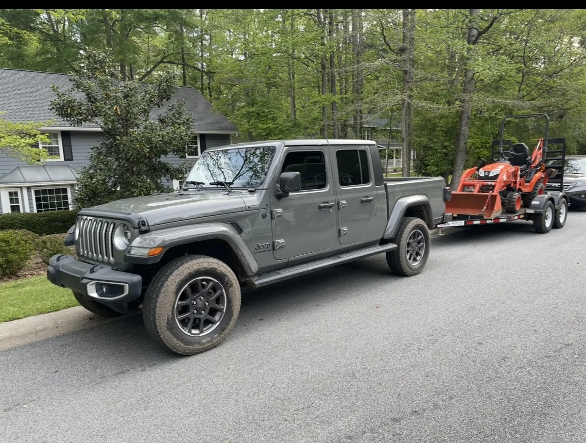

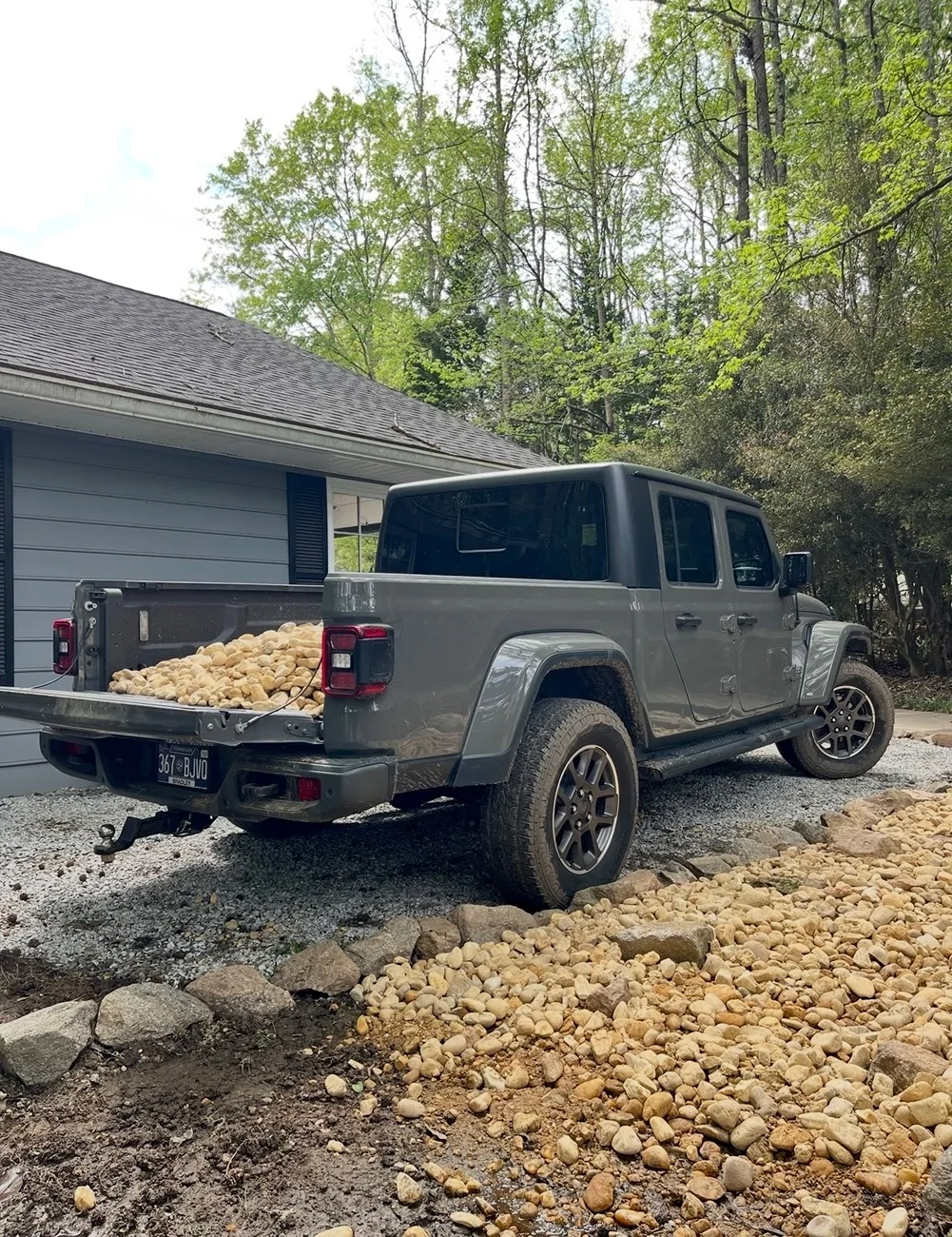

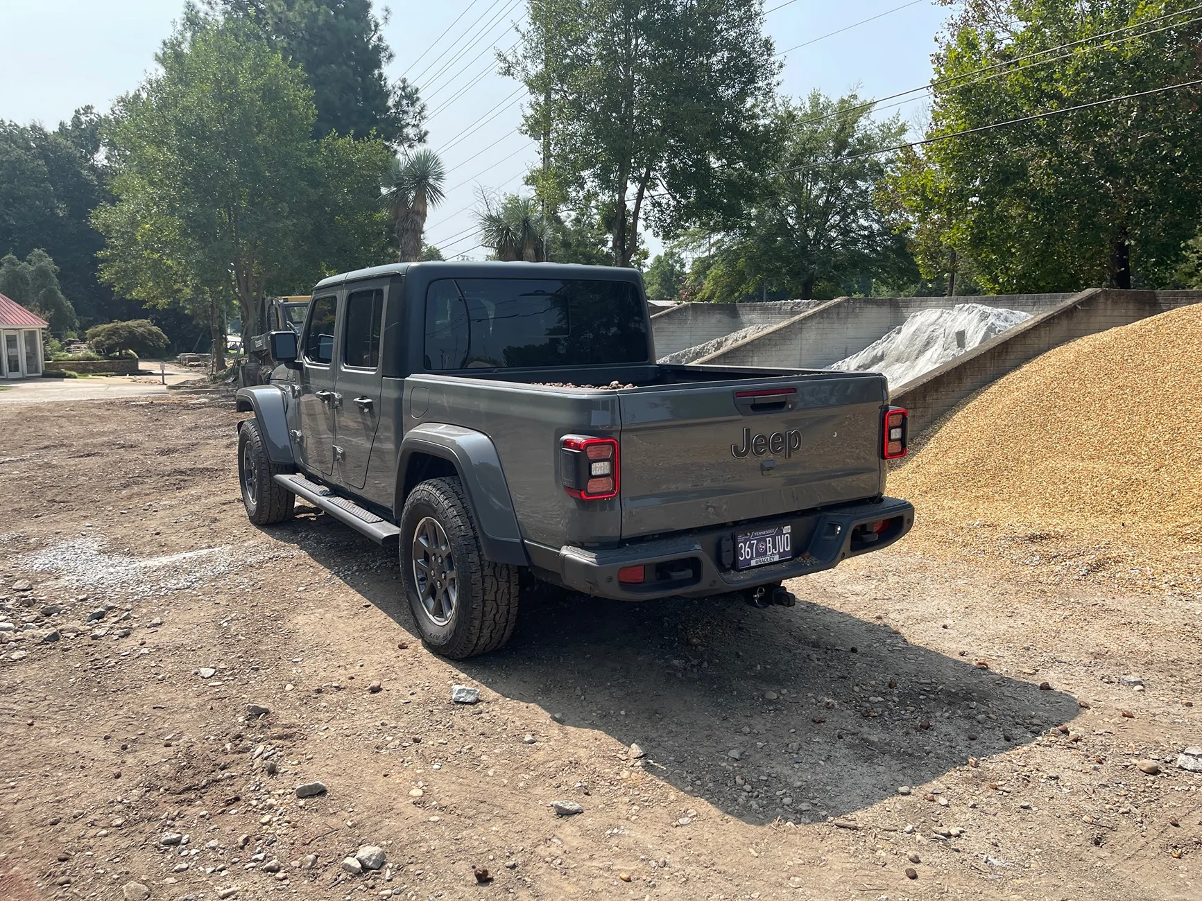

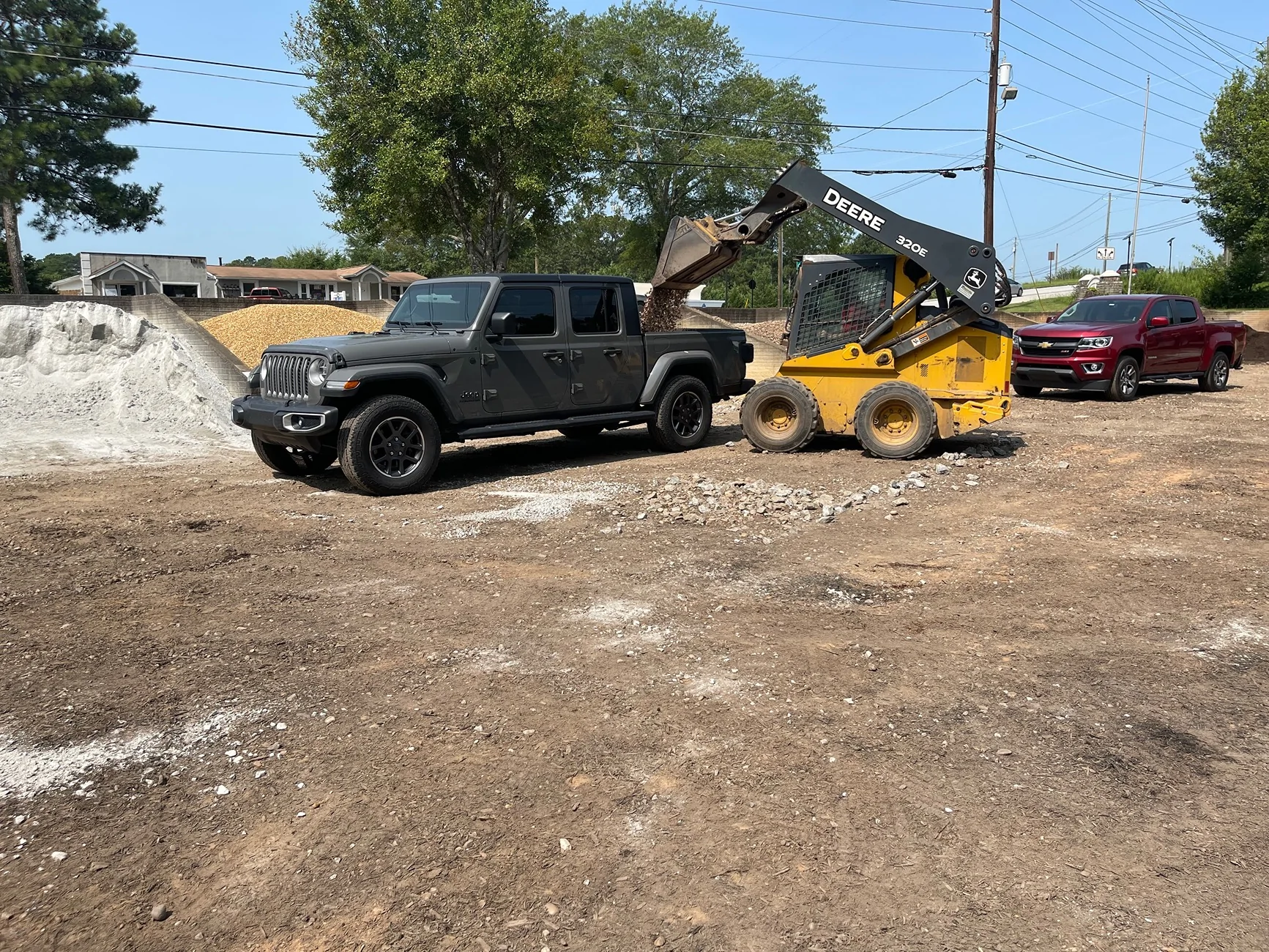

The biggest limiting factor of the Rubicon suspension with the highest spring rate is the Fox shocks. I wore them out pretty fast. They always did pretty well under load or when you pushed it cornering (unloaded), but they had too soft of a ride in normal driving and I eventually wore them out at 60k miles because I just don’t think they were designed for the towing and hauling I did with mine regularly for years. I recently put 5100s on it and it’s great now. Better than new. The 2nd and 3rd pic are roughy 1200 lbs in the bed. Accordingly to Home Depot that tractor/trailer combo is 6800 lbs. Those are just the pics I have because it was for personal projects.
