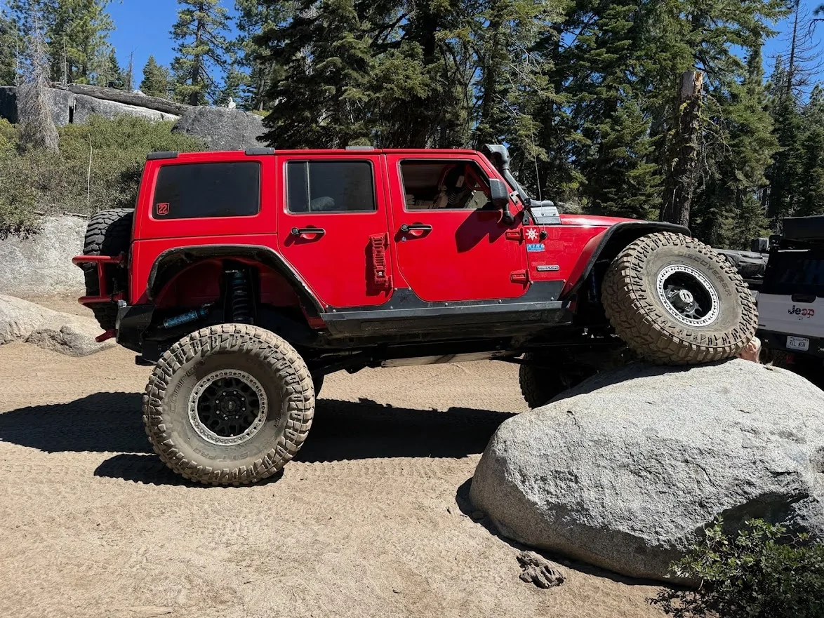

As good as the mojave shocks are at speed, they are still too short stroke and limit flex as seen here.
The stiff front sway bar tremendously limits flex and also severely imbalances the front/rear articulation bias. The Mojave simply isn't intended for rockcrawling, but it still does worlds better than any OEM IFS truck.
The OEM shocks' travel is roughly matched to the OEM control arm bushings' capacity to flex. With longer-travel shocks allowing for more articulation, the OEM bushings rapidly out. All of these parts play individual roles in a complete system.

That is not washboard. Washboard travel is within the travel of a OEM shock.
If you want you rig to perform like a rock crawler you are right, it needs most suspension and longer travel. An alternate is to take better line limiting the articulation challenges in you mostly stock suspension.
High frequency movement thru a light shim stack will allow for needed movement in the washboard case combine with a separate Reservoir with the appropriate N2 charge heat will eb controlled and performance will be significantly extended.
All designs have limits. You can go to extremes and prove a point for the sake of proving a point but the mainly "highway" design is limited in it off road capabilities. due to the primary use case of the vehicle.
I agree with the sway bar, although the mojave actually did better on the rti ramp than the rubicon with the sway bar connected. After these pics I did add a set of sway bar disconnects, but the shocks are still very limiting. Our 2019 JLUR still had stock control arms everywhere but the front lowers (for caster correction). Bushings were all good after 63k miles on rocksport red shocks and it would use all 12.2" of stroke. The short shocks are limiting for no reason in my experience. The JL sport/saharahs have all the same parts and front shocks with only 5.8" of stroke. You can easily double that travel with a shock change and nothing else.
