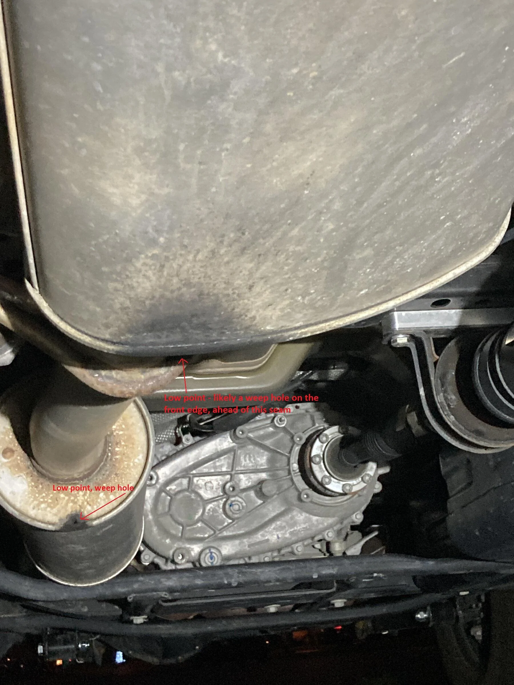

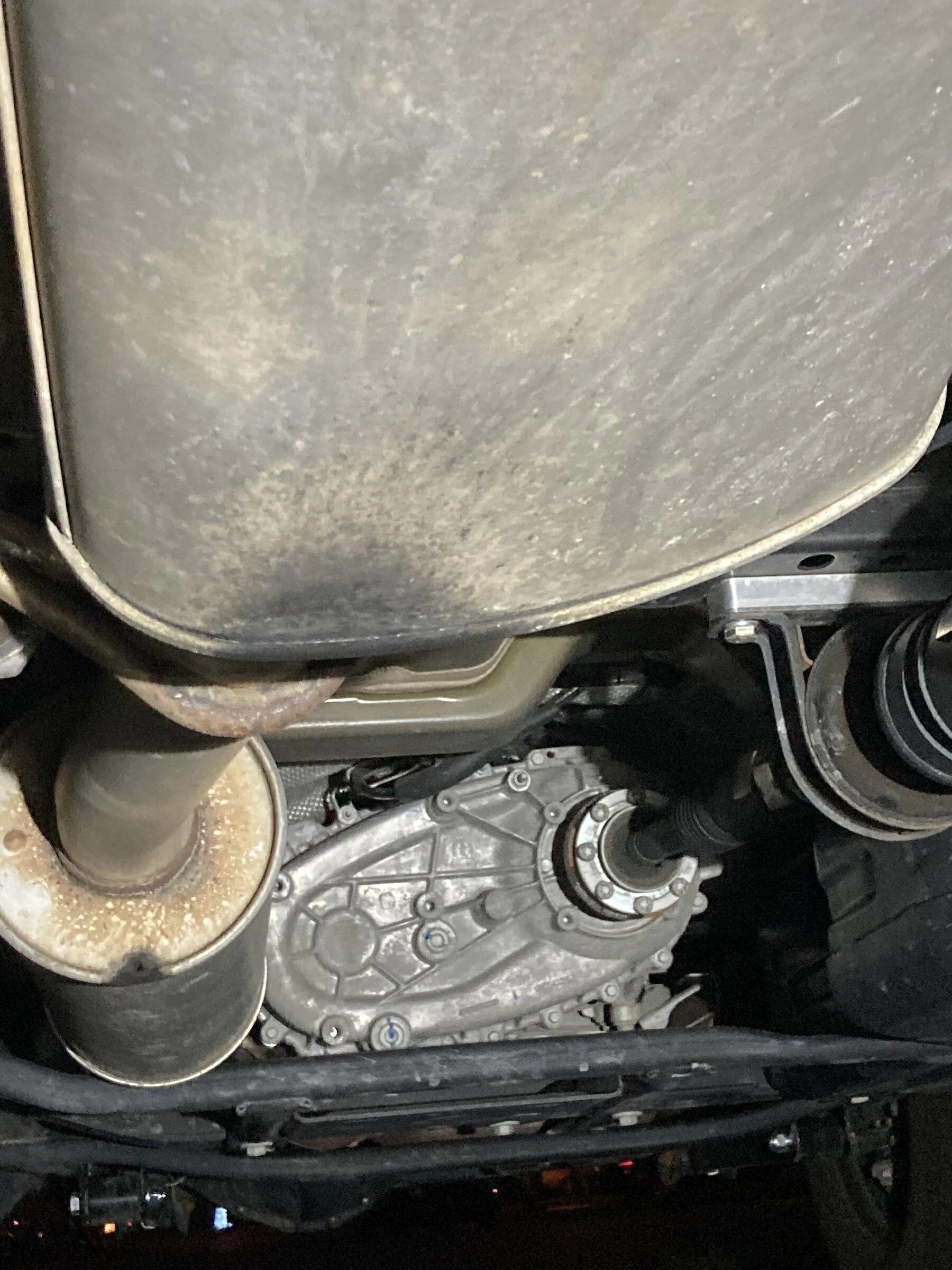

Every time i start my truck and let it warm up i have a puddle under it. Summer or winter. Initially I assumed it was just a/c condensation. But now that its cold i gave it s little more thought and realized the drips are coming from the rear of the jt not the front.
looking under there i see black soot looking crap on my exhaust and a small hole in the resonator.
is this normal?

Can't tell by the pics but are we talking condensation from exhaust? There are multiple drain points and it's also possible to drip water out the very end. The byproducts of perfect combustion are a lot of water and carbon dioxide. Winter or summer, you'll see condensation from exhaust - maybe that's it?

Condensation. Mine does it also. Havent you ever been behind a car and see water dripping or even running out the back exhaust tips?

I have but always figured if it was running out of the tips that was bad.

Most mufflers and like have "weep" holes to drain condensation to keep them from rusting out.

Yes - and with exhaust in cooler weather the ends of the exhaust are cooler than the middle and front. That means that once heated, water may not condense at the front pipes or muffler until ir reaches the rear pipes where they are cooler and water condenses out of the exhaust.
If things are working right - these can put out a lot of water and where it ends up will depend on how cool the pipe is that the exhaust is going through. Early on the muffler is cool and a lot condenses there. As the muffler heats, the water stays in the hot exhaust passing through a hot muffler until it reaches the cooler pipes later.
His pic did show a perfect example of the weep hole you bring up.

Looks like leaks at the seam. See if you can feel exhaust pulsing while idling.

Where do you see a leak at a seam? That black is below a weep hole - we just can't see the hole. But the black is distributed in such a way it's coming from the front edge, not a seam. It's being blown down, and back across the crimp and back along the bottom an inch or so. Bet there's a hole up there we can't see.
