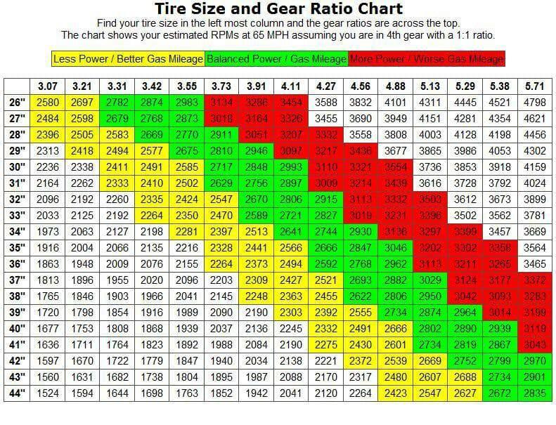

I’m curious did you regear? I just put 35s on my Sport S with a Mopar lift. Been debating which gears to go with down the line, still at 3.73 atm
Here's a chart to help you.
Jeep Gladiator Is this mpg normal? gear-ratio-1
That chart looks pretty old as it references being in 4th gear, pretty sure the JT automatic is lower than 1:1, believe it is .67 in 8th gear.
That could be the old chart that made its way into this forum multiple times a couple of years ago.
Automatic 6th is 1:1
Manual 4th is 1:1
It's a good useful chart. Say you have 3.73 gears and are turning 2470 rpm with 33" tires. You put on 37" tires. To find the closest gear ratio you need. Look at the 37" tires, go across and find the closest rpm match. Then look at the top for the gear ratio. 2427 rpms will give you a 4.11 gear ratio.
Look around they probably have one for the current JL/JT with the eight speed. This chart is probably from the JK drivetrain.
That's absolutely for a JK.
