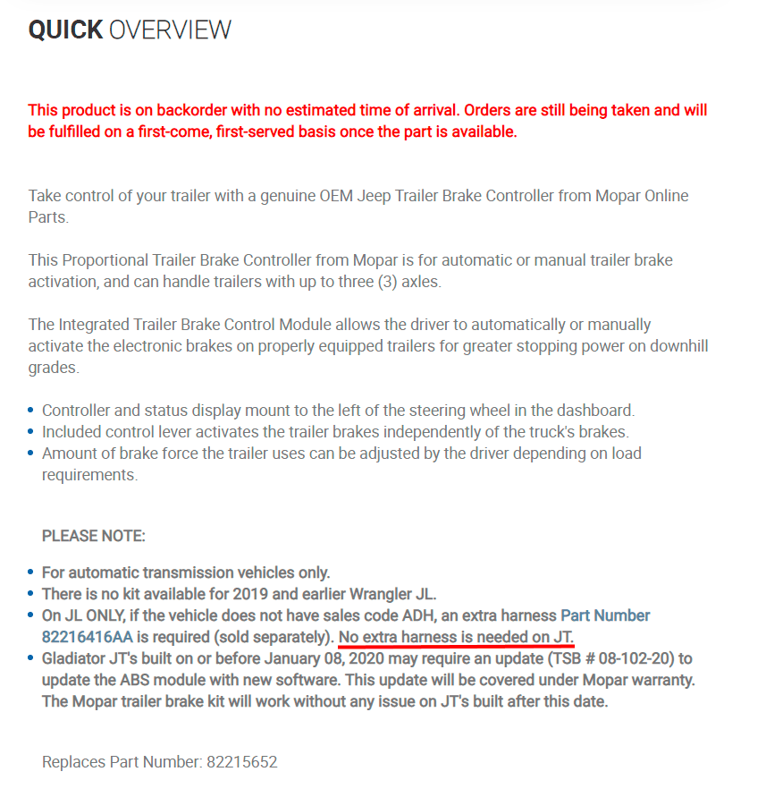

I also have a 2021 JT Diesel with a tow package and I am also missing the trailer brake controller plug. with the recommended wiring harness on back order, how did you overcome this?
You missed reading the later posts. All Gladiators have the plug. No extra parts needed to install the Mopar controller. I believe the backordered harness is for the Wranglers. One of the places the 2 vehicles are different.
See here:
https://www.moparonlineparts.com/sku/82215652.html

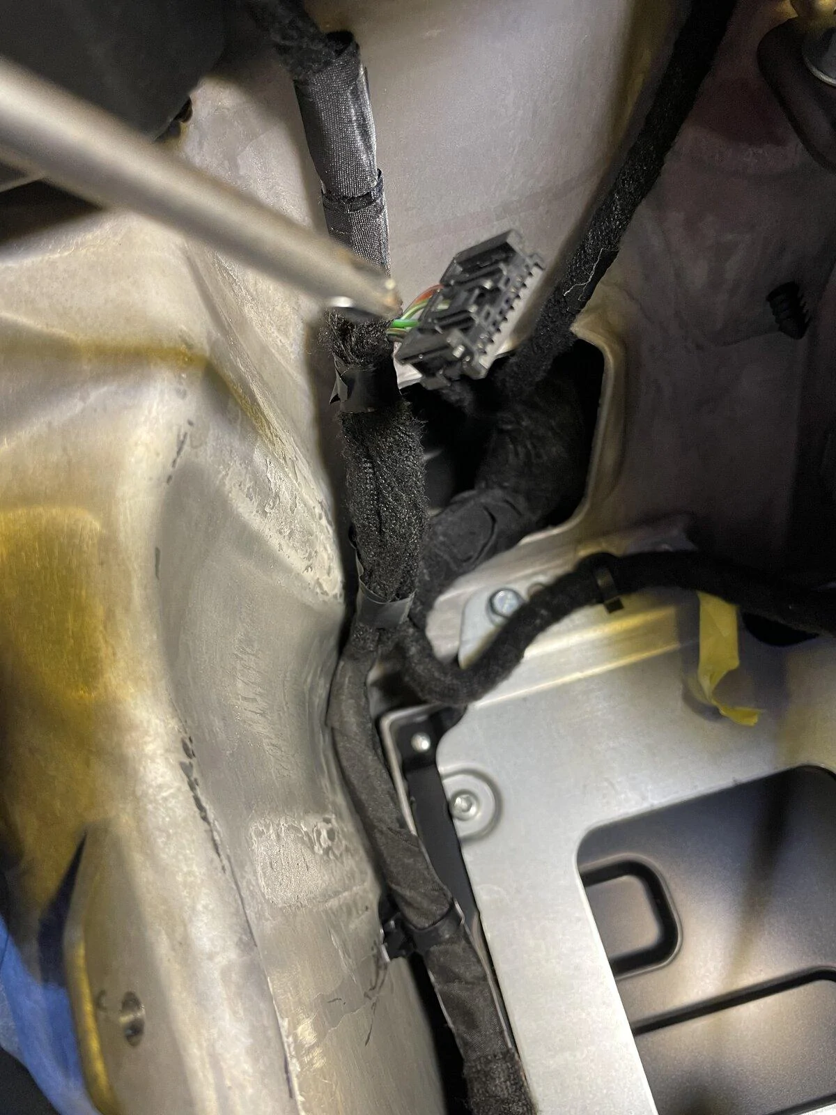

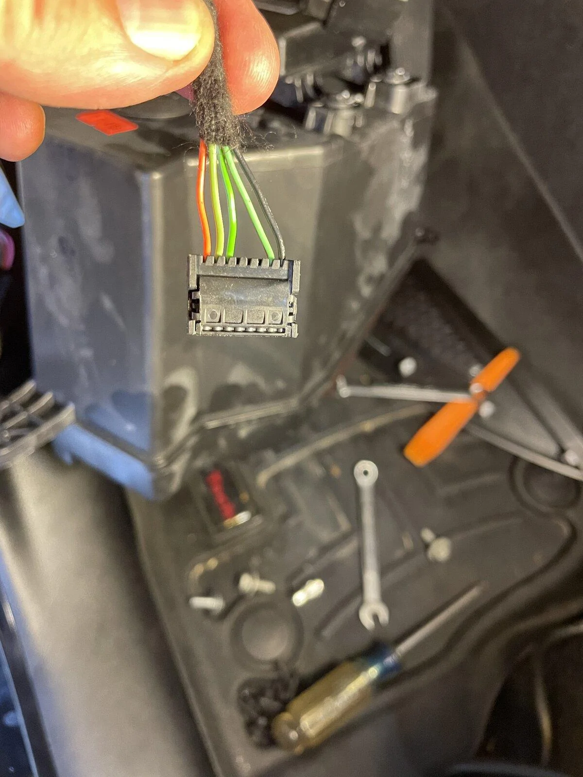

I had almost all of my drivers side dash taken apart, I removed my speaker pod and the only plug I located was this plug. Not sure what purpose This plug serves?

It's not in or under the dash. It's taped to a wire bundle along the left kick panel. No need to get into the dash to find it. There's a fat bundle of wires going up the left kick panel area and the connector is taped to that bundle.
It will be a square connector with 4 wires.

Thanks I appreciate it.
