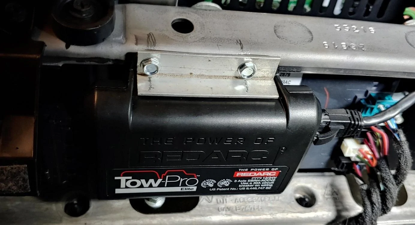

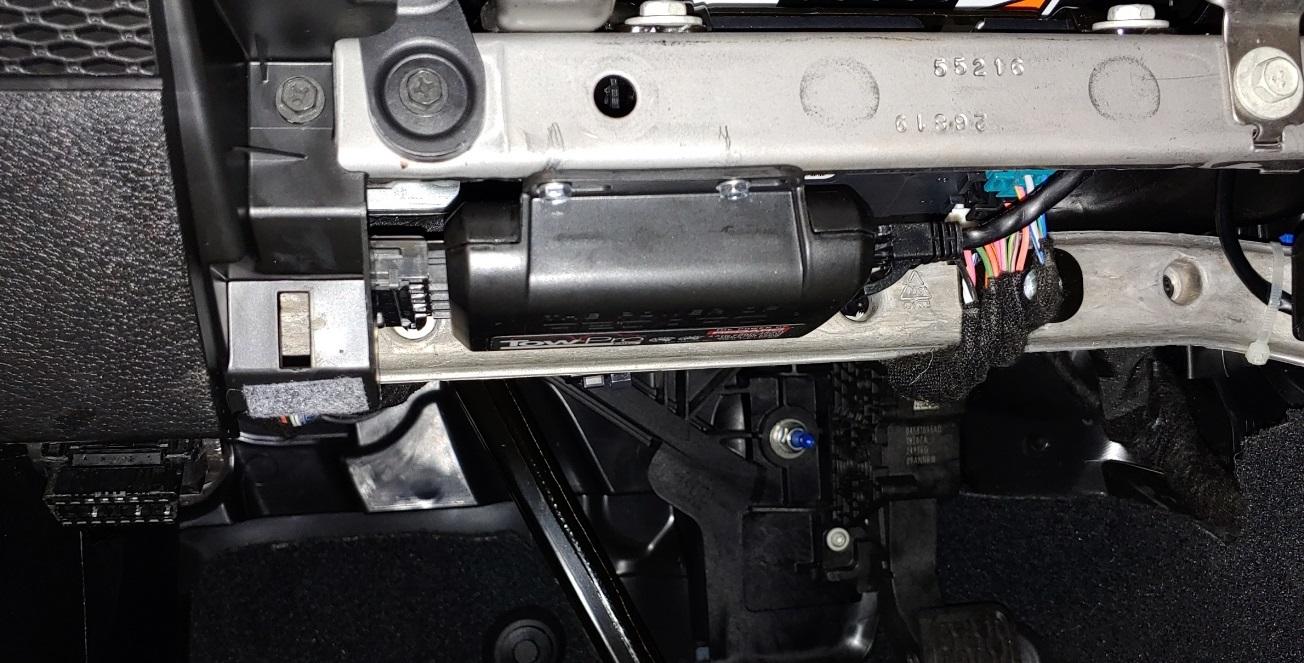

I did the same thing as here: https://www.jeepgladiatorforum.com/...ler-install-location.34519/page-3#post-654601
Or are you asking about the controller (not the knob)? My controller is just attached to a piece of 1/8" flat stock. It has to be mounted horizontally - when mounted vertically, the trim interferes with it.
No need to trim the back of the trim panel when mounted this way. The aluminum angle reinforces the mounting flange on the controller.
Jeep Gladiator "Perfect" Redarc Brake Controller knob install, almost. 13-20200915_114640_HDR
This was to get things lined up - before I added the aluminum piece to help support it and reinforce the screw holes in the controller mounting flange -
Jeep Gladiator "Perfect" Redarc Brake Controller knob install, almost. 11-20200915_111801

I got it all apart tonight and there seems to be a lot back there. I’m not sure how you managed to squeeze it in and what you had to cut but it seems like that whole area is a collection of snap points for the body panels in the area. I couldn’t figure out what could be minimally cut there without removing plastic that the trim clips into.
I just took a multitool and quick cut out a spot. I took a tab out but that was no big deal to me.
