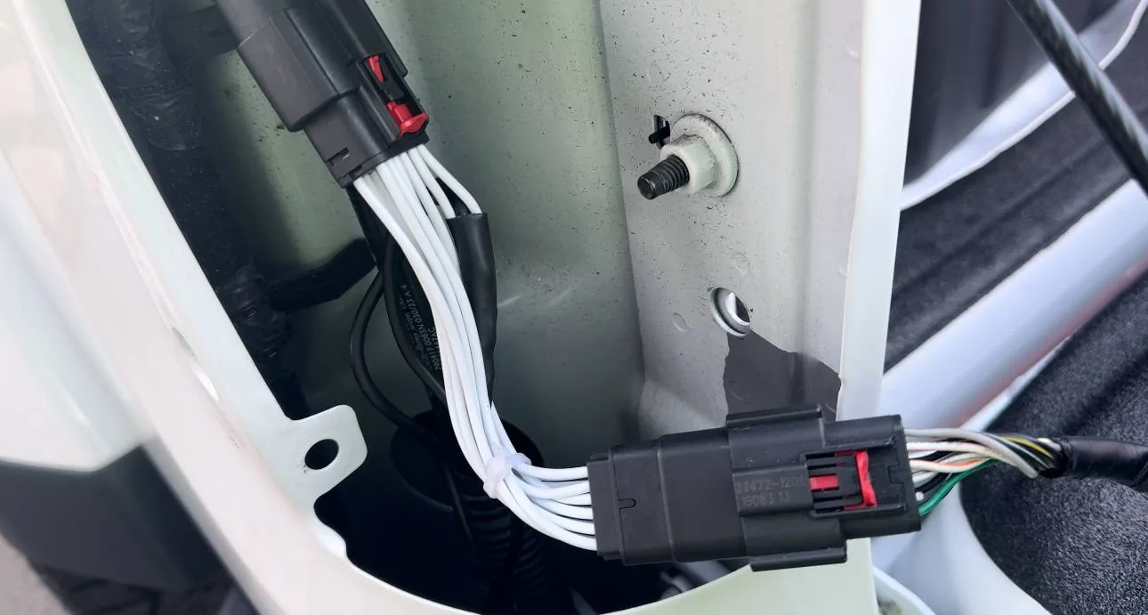

Return it to stock. Remove the Oracle lights and harness. Take it to the dealer and get it fixed. Purchase the Oracle harness that connects to the Tow Wiring and reinstall the lights.
It's possible that you have damaged the ground connection in the plug or harness on the side that doesn't work.
AG74683
Andrew
Mar 5, 2025
North Carolina
2021 Gladiator, 1999 Cherokee
Paramedic
I've replaced the harness already with no change. I find it hard to believe that somehow I damaged the ground all the way through the second harness (from the sway bar link to the bumper).

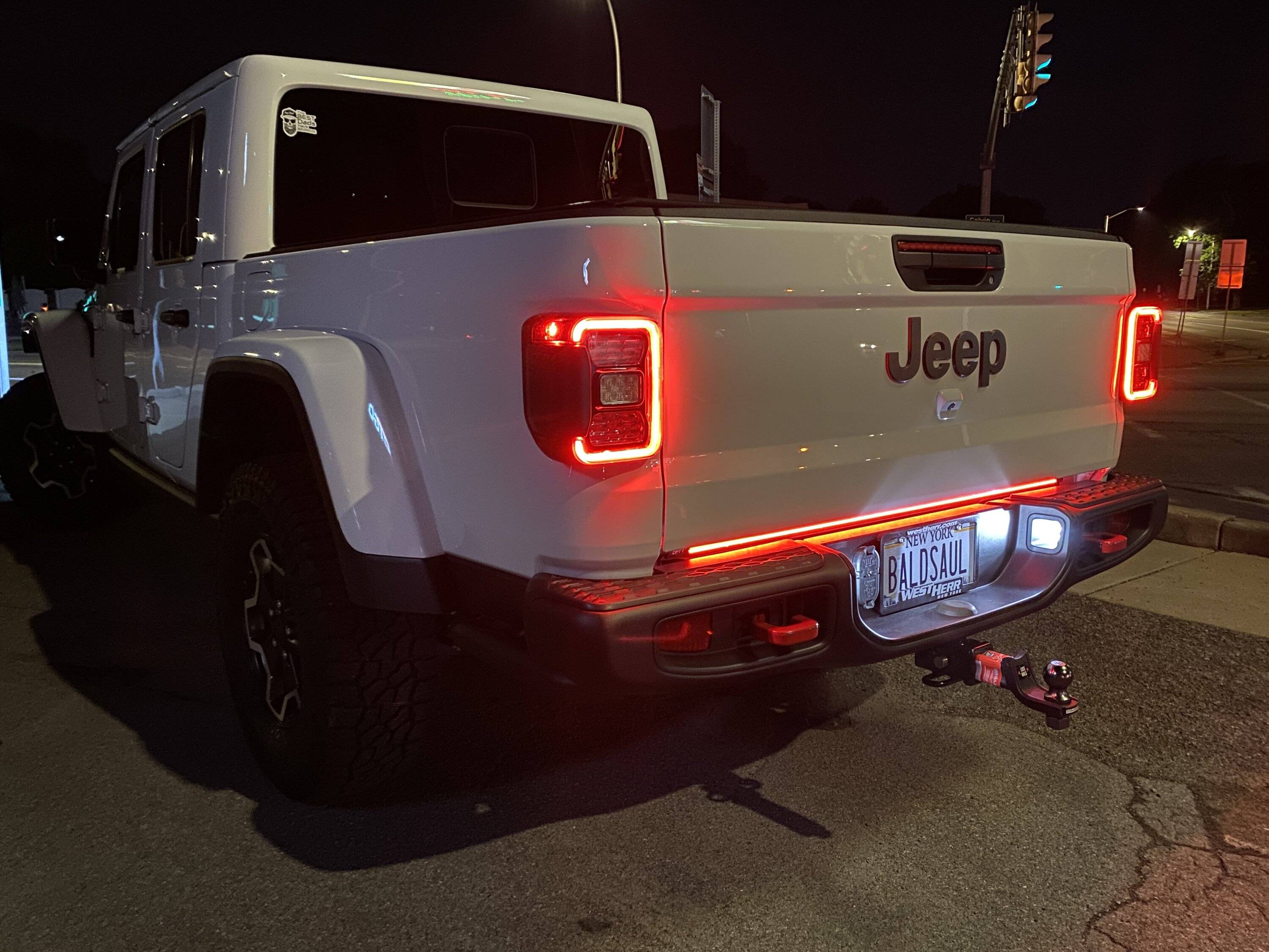

It has been a while, but I originally had them both hooked up to the one harness and it was nothing but problems. Since then, I had hooked them up to the Oracle plug-in play harness that plugs into the trailer harness. Zero issues seince and it looks awesome. Thank you for the input though. It seems as if everybody has a situation that’s different even though it’s the same car lol
I do have factory led tail lights, so maybe that had an effect. Glad they’re working.
