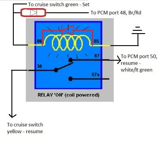

Be really sure the relay you use has a clamping diode across the coil - or add your own, otherwise the coil de-energizing that impact same sensitive electronics. Some already have that built into the relay's case - some cheapies don't.

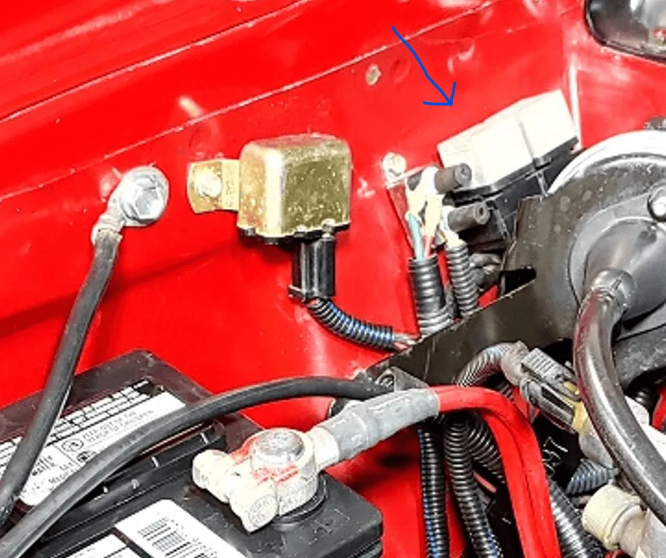

You can get sockets for them as well - here's a pair I rigged up to put my car's headlights on relays, dropping the voltage drop to all but zip and increasing voltage to the lamps by well over 1 volt.
The sockets screw to the inner fender so if a relay has a problem, I unplug it and put another one in, leaving the wire intact and the relays don't "bang around".

This shows the clamping diode (in red across the relay coil) - this is a diagram I made of a way, using diodes and relay combination to adapt the AMC cruise control switch to be able to control the cruise control built into the PCM of 1990s Jeeps.
