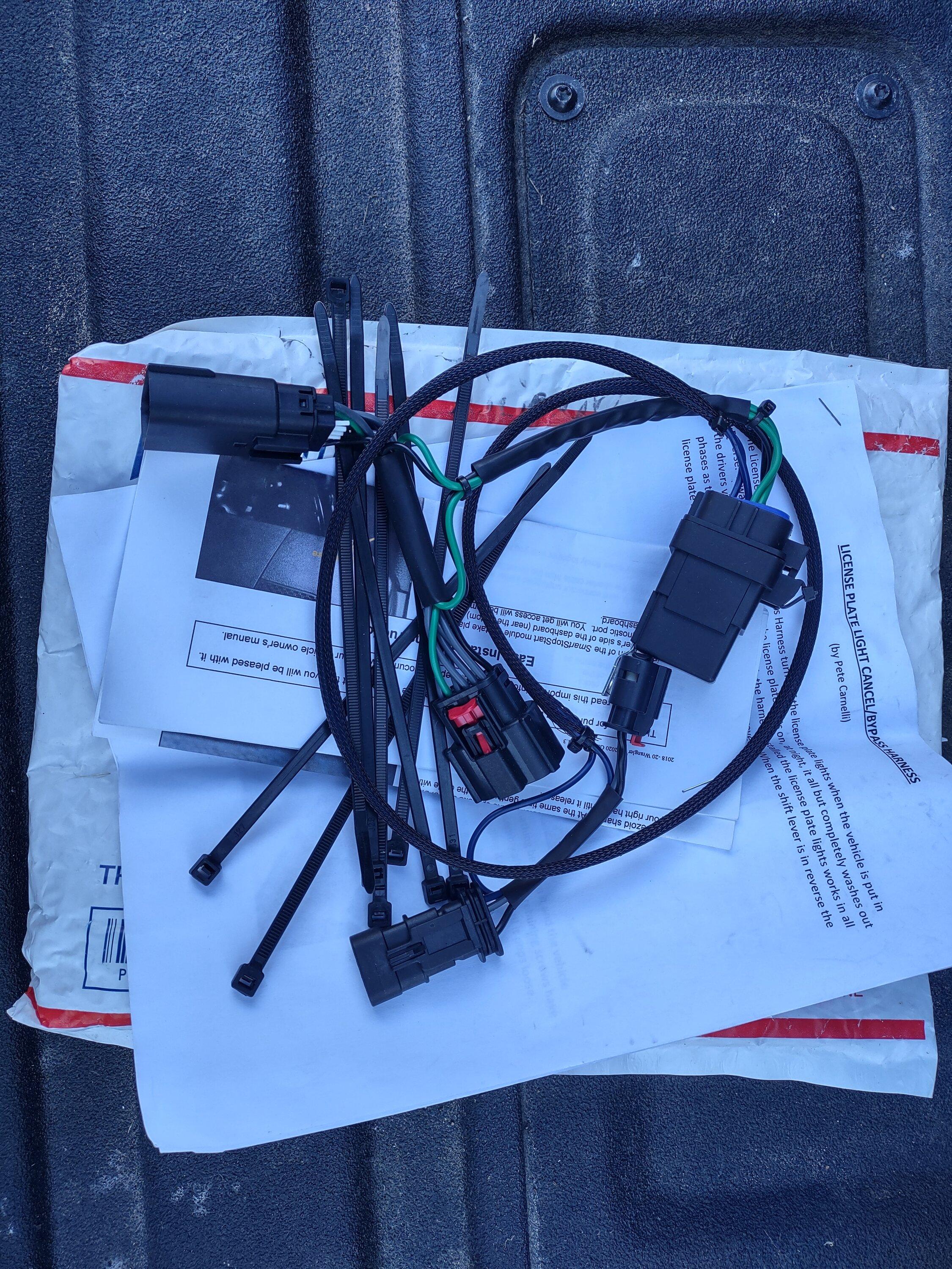

I have one of the harnesses I'm not using, my bumper is in a different configuration now and I don't need it. Never installed it. $50 shipped Lower USA to first private message to me.

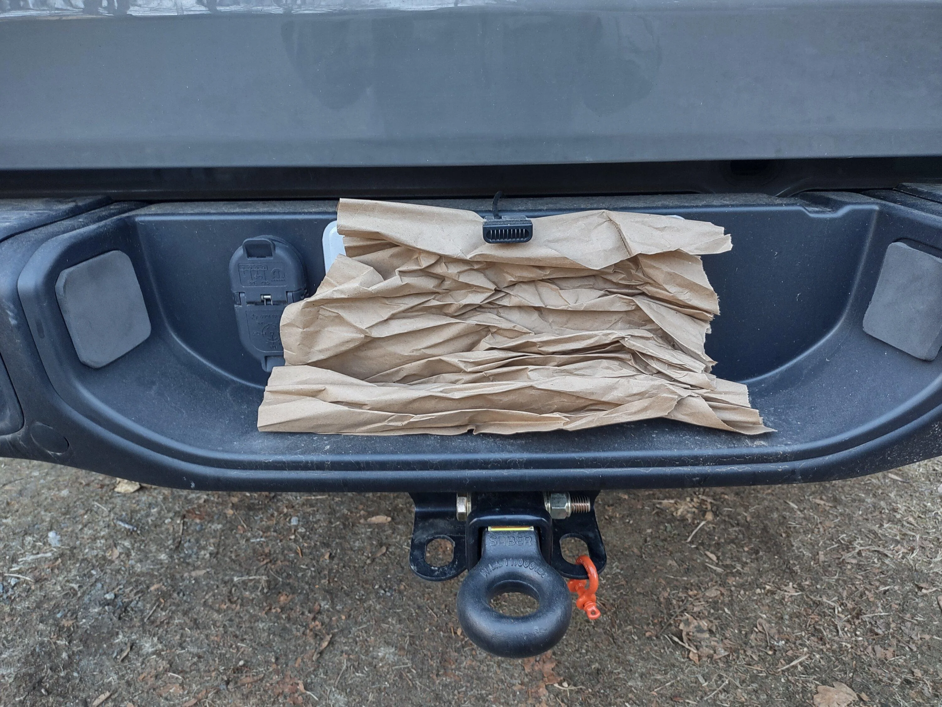

Jeep Gladiator Can the dealer disable license plate lights in reverse? IMG_20221120_132626517_HDR
This is my story and I'm sticking to it. I was rear-ended hit and run by a Wrangler. Picked up a take off steel Rubicon bumper for repair. It didn't have the license plate lights with it and my plastic bumper lights didn't fit. Tried to order the lights and couldn't find anything in stock. I neck of red plugged the light holes with a hunk of neoprene and installed a aftermarket license plate light. The aftermarket light doesn't glare nearly as much as the original so I'm going to keep it, need to find something a little cleaner for the holes then I'll be good, at least I'm legal right now.
Jeep Gladiator Can the dealer disable license plate lights in reverse? IMG_20221120_132323775_HDR
The little black thing sticking out from top of the bumper is my led light.

Harness is sold.

Unplug your license plate light and wire in one like my above post. It's not as bright and points down. Really reduced the glare. Kinda down and dirty way to do it, easy and simple though.
