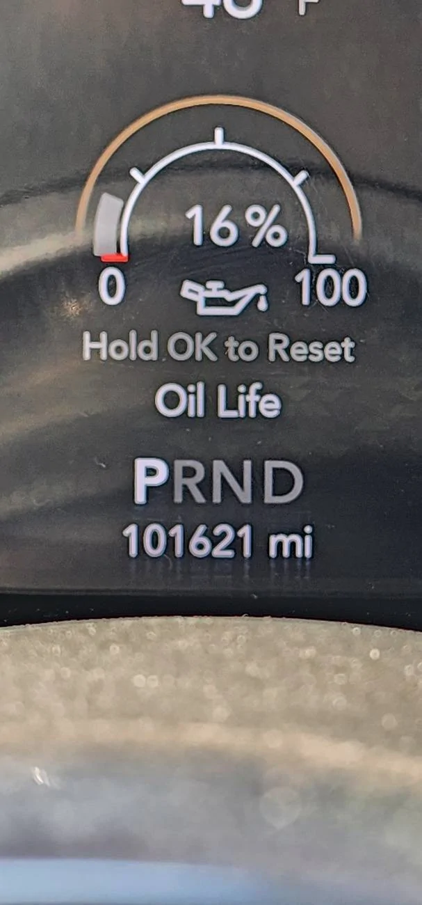

Honestly I credit 3 things to the longevity of the trucks drive train.
1. Engine oil is 0W-20 Amsoil Signature series .
Use the oil change interval
When it gets to 50% I slap in a fresh filter when it gets to around 10% I change oil.
2. My axles and transfer case have all been changed to amsoil.
3. Transmission is Chrysler 8&9 speed and it has been changed along with filter one time.
That's the first part I ever had to put one this beast !!!!!!

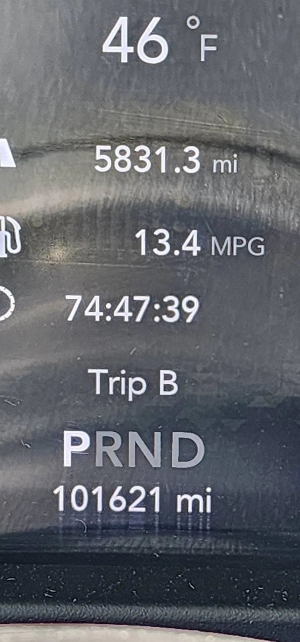

2 pics...
first is miles on this oil change .
Second is percentage left.
I am picking up new oil in the morning from my local Amsoil guy.
I swear by that stuff.
