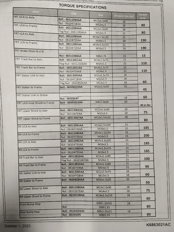

The rear is 190? I got them loose with a breaker bar my neighbor gave me. But the AEV instructions called for 111ft-lbs and 60-95 degrees for the rear. The front is 190 I saw.
Those have got to be wrong... This is from the MOPAR kit:

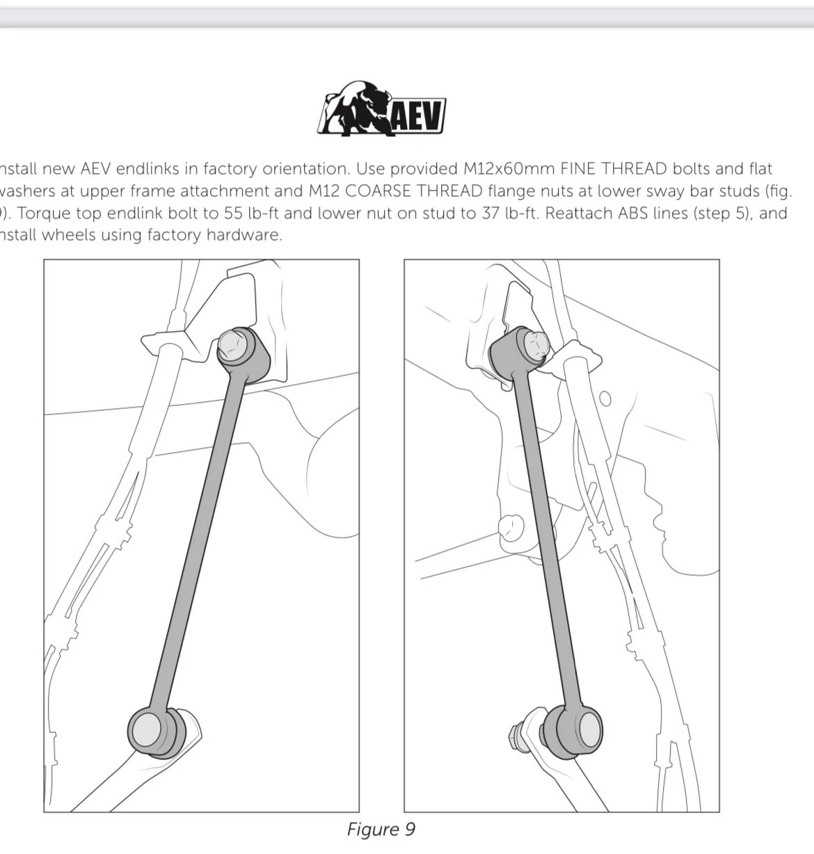

Well after raising it, lowering it and putting it back together me neighbor gave me the bar and that worked. Got everything torn apart and had a hell of a time putting the springs in by myself. I couldn’t get the end links loose, it was spinning and I was getting nowhere. I cut the first one but cut in the wrong place.. Hacked at it forever until I got it loose enough that I could hacksaw the bolt, gigantic waste of time. Neighbor had smaller vice grips than I did so I was able to hold the second one in the middle and get the not loose. Got one end link back in and the other didn’t want to go, at all. The instructions made no sense because the orientation doesn’t seem correct either. The instructions show this
Jeep Gladiator Jack points front and rear 751E652C-0D6C-4E44-AB71-43897BF191CE
But that’s backwards of how the OEM were installed. The bolt went through on the inside and this photos on the outside. But it’s not even close to going together like that. I really question this now. I had to force one sway bar to get the top bolt started and it just didn’t feel like it should have been that hard and made me nervous. Drilled everything and got the bracket put on. I tightened best I could with my torque wrench and Allen wrench socket but it’s it’s slightly too small. So I have metric or they are metric, but I have to go back and make sure it’s torqued correctly. They’re tight but not to spec, likewise with the bump stop spacers. They’re in and have the nuts on them but I need the correct Allen wrench to crank on them. I had to have my wife help me tighten the control arms because holding the nut and torquing 111ft-lbs from your back is not fun. 10 hours and all I did was get the rear done, I’m tired and sore AF.
Now I’m questioning if I messed up the control arms too.. I was just thinking about how I had the axle being held up by the jack and I didn’t let off the pressure or lift of it once I got the end end links and shocks installed. I was wondering if you could torque it down at an incorrect angle?
Jeep Gladiator Jack points front and rear 6FE62409-2304-4FE2-98A1-A4283D5972C5
111 plus 60-95 degrees of additional rotation will put you at approx 190 ft lbs. Looks like even the mopar specs call for similar numbers at 185 ft lbs. Actually says 200 for uca to frame. Lol thats tough. Need a nice long torque wrench for that lol.
End links use an allen key in the center of the stud. Hold in place with the allen key and use an open end wrench, ideally a ratcheting one to remove the bolt.
Well if that’s the case why not just set the wrench to 200? ??ā€ā™‚ Are they assuming people don’t have torque wrench’s that go that high?
