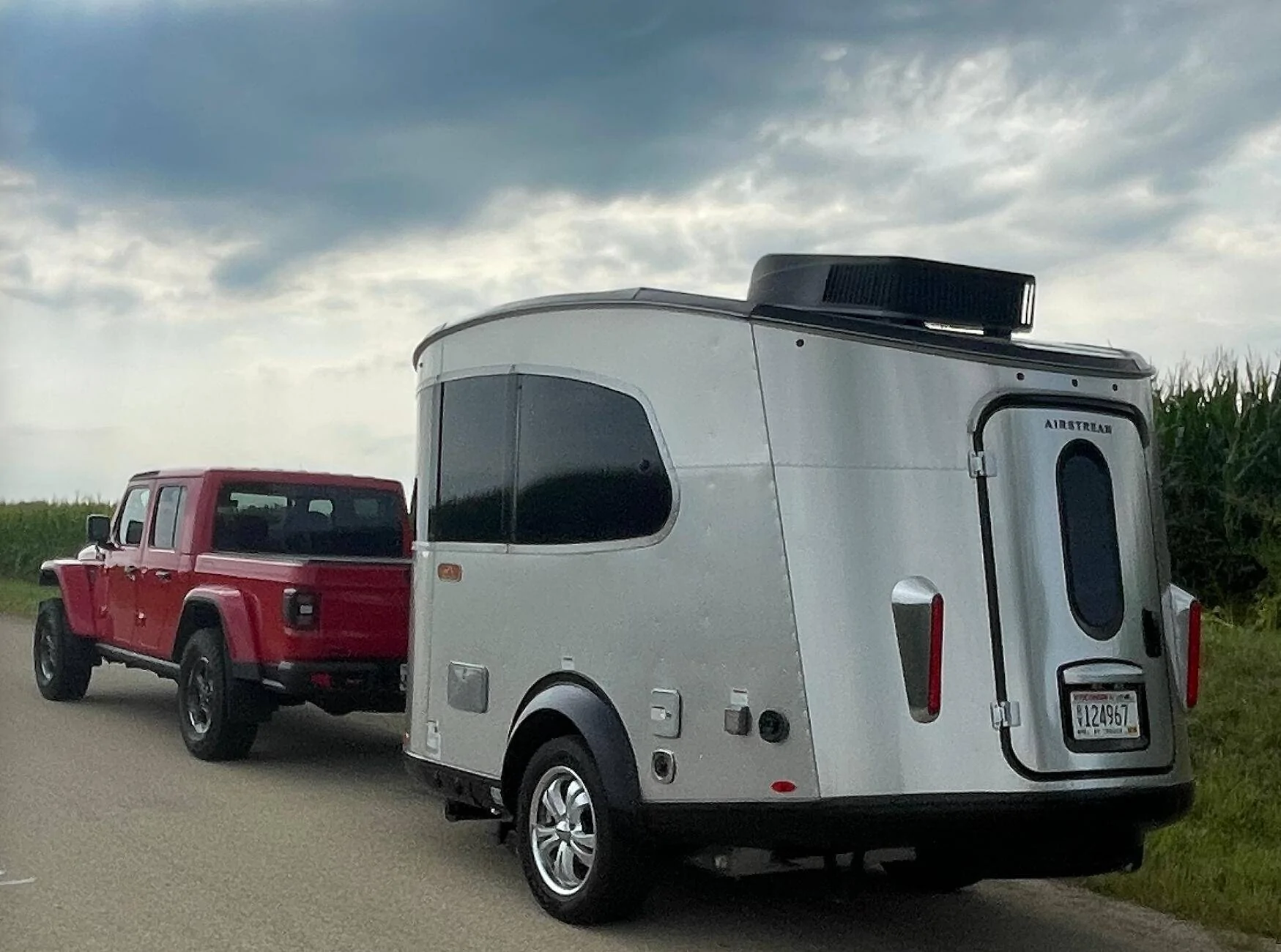

I have a '23 JTRD pulling a 16' Airstream. I had yellow Super springs installed on the back--kind of a bumpstop. Dealing with the airbags on my previous 3.6 JT wasn't for me. I currently use a Mopar trailer brake controller with a Curt sway bar. It works ok for local trips, but I don't want to be pushed by semis on the interstate, so I picked up an Equalizer WDH with 600 lb bars on FB marketplace last year. I did a ton of research and this brand kept coming up over and over. I had it powder coated and will break it out this year. Doing a lithium conversion on the trailer now.....Can't wait until summer!
Jeep Gladiator Jeep Mojave with out max Tow, Airstream 16ft trailer
