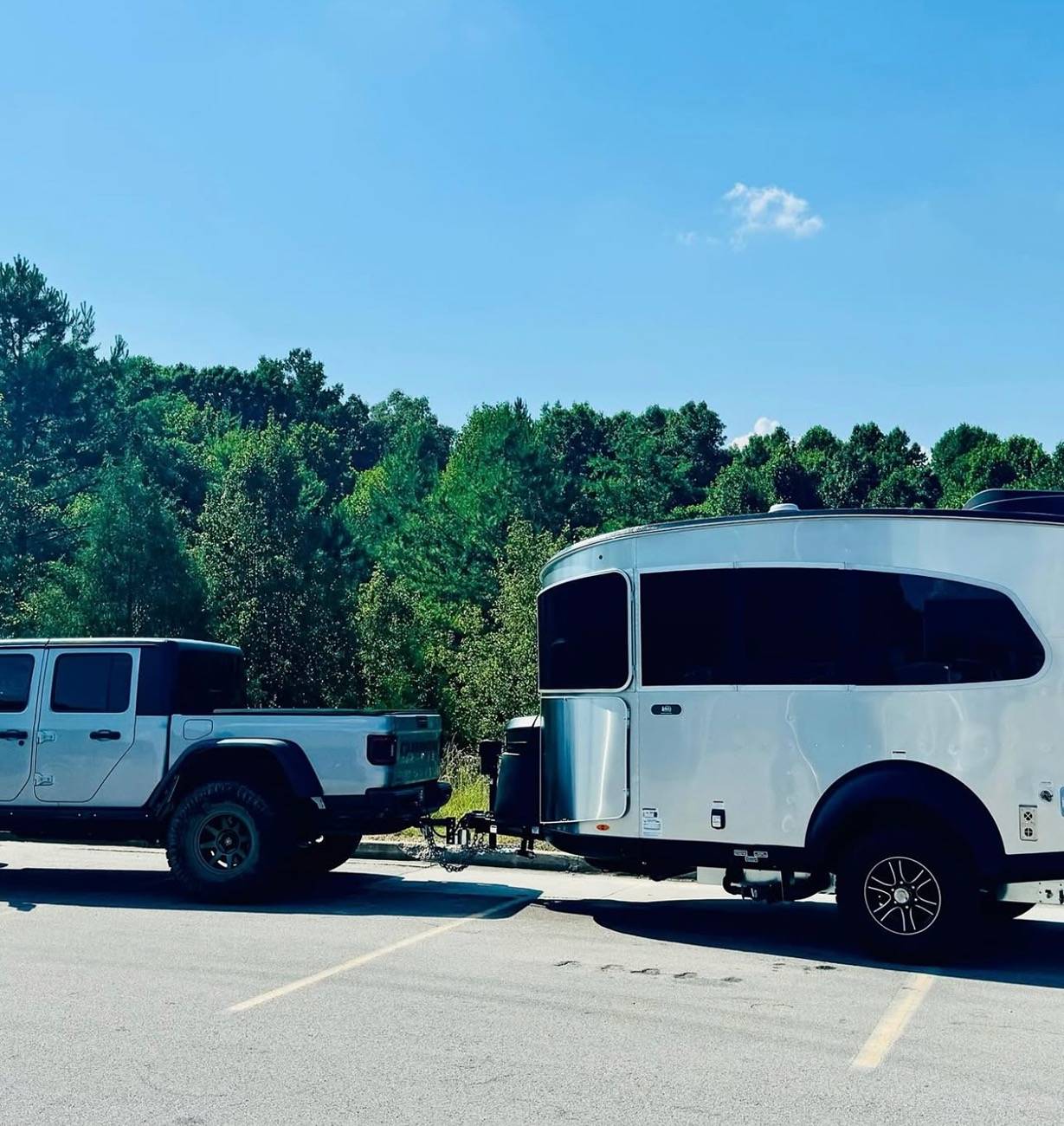

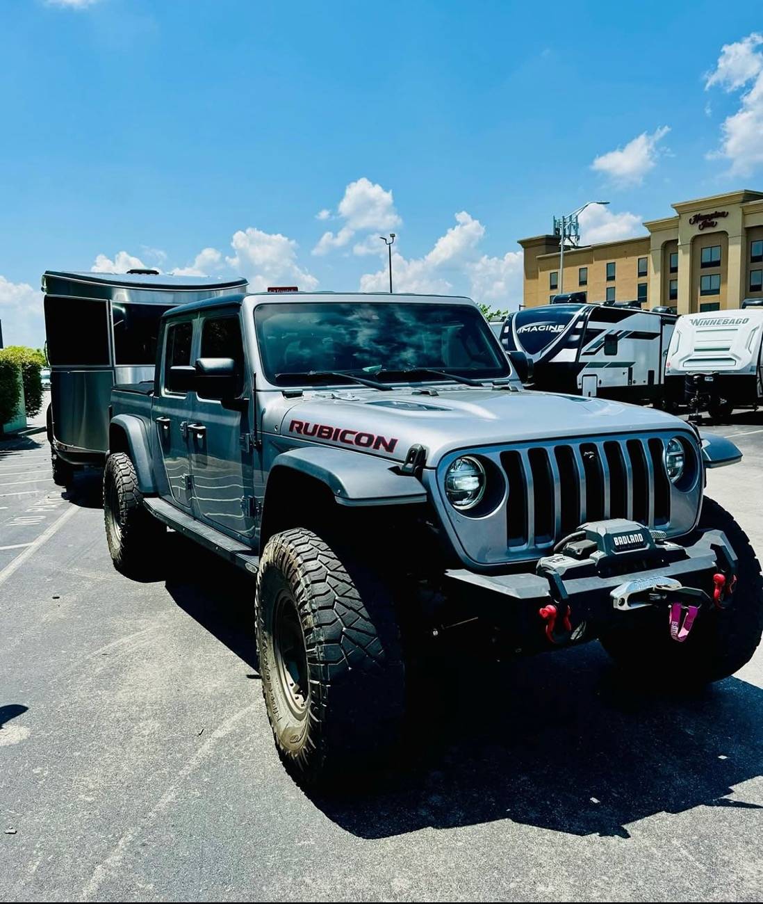

I’ve got a Airstream Basecamp 20x I pull with my JTRD with and Andersen Weight Distribution Hitch. It’s the best WDH I’ve ever used and the easiest to hitch & go. Takes less than 2 minutes as the weight distribution chains don’t have to be removed.
Jeep Gladiator Jeep Mojave with out max Tow, Airstream 16ft IMG_3410
Jeep Gladiator Jeep Mojave with out max Tow, Airstream 16ft IMG_3411
