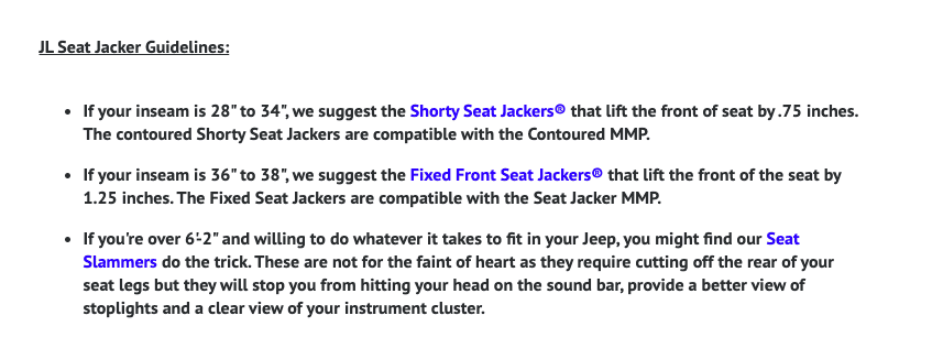

Ditto on the seat jackers. After I installed a pair of the fixed 1.25" on my side, my wife sat on my seat and said to install some for her on her side immediately hehe. We've got 50k on the truck and they help tremendously. It went from having to walk around every few hundred miles on cross-country trips purely for the sake of relieving strain to stopping for bathroom & food breaks only. I can't remember the last time we stopped purely because we needed a break from the seats like before.
A little tweak goes a long way though, I'm a 34" inseam but decided I knew better and opted for the taller fixed versions despite them recommending the shorties for 34". I really like mine but after installing her shorty .75" versions on her side, I regret not getting the smaller ones. If you're in the middle of the inseam recommendations (below), I'd suggest trying the shorties first.
Jeep Gladiator JEEP SEATS - UGG! Screenshot 2023-06-05 at 11.07.39 AM

The seat jackers match the full mating surfaces perfectly and are solid units. They move the new bolt location to keep the geometry correct. They also come with longer bolts to insure full thread engagement.
A "stack of washers" simply isn't going to be as strong and will alter the geometry. Might be strong enough. Might not be.
I actually tried washers and other things that I already had lying around. They didn't leave me feeling good about it, so I ordered the jackers.

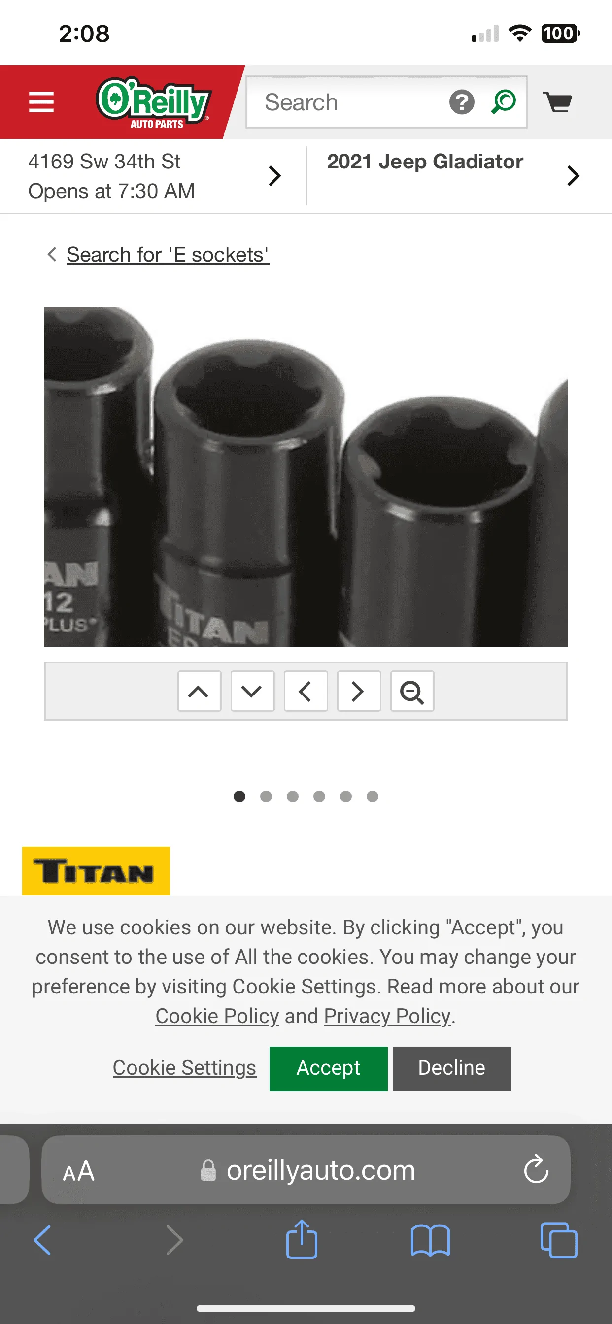

To be ready, the JT’s have a reverse torq head screw. You’ll need an appropriately sized “E-star” socket. You can pick up a rail of them at O’Reilly auto parts on the cheap. I can’t remember for sure but it’s something like a number 13 or 12. The photo below is for illustrative purposes if you are unfamiliar with them. JL’s have a torq bit. Odd that it was different on the JT’s. Check what you have before going to pick them up. When you order, you might as well give them a call to ensure you get the correct size.
Jeep Gladiator JEEP SEATS - UGG! 8C64E62D-5715-486C-96FD-F9012942D8DD
