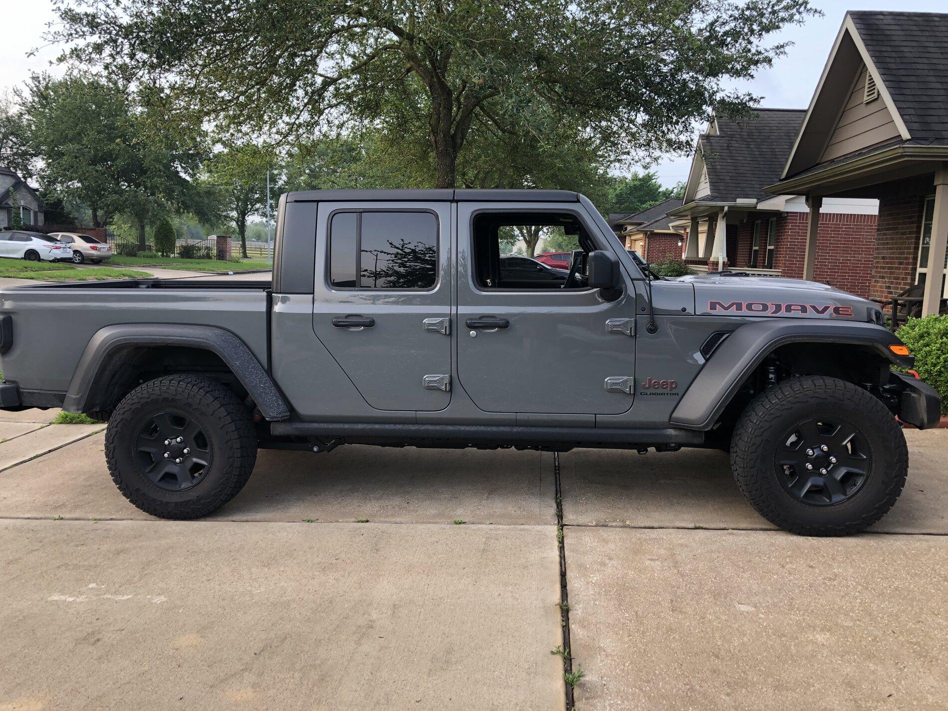

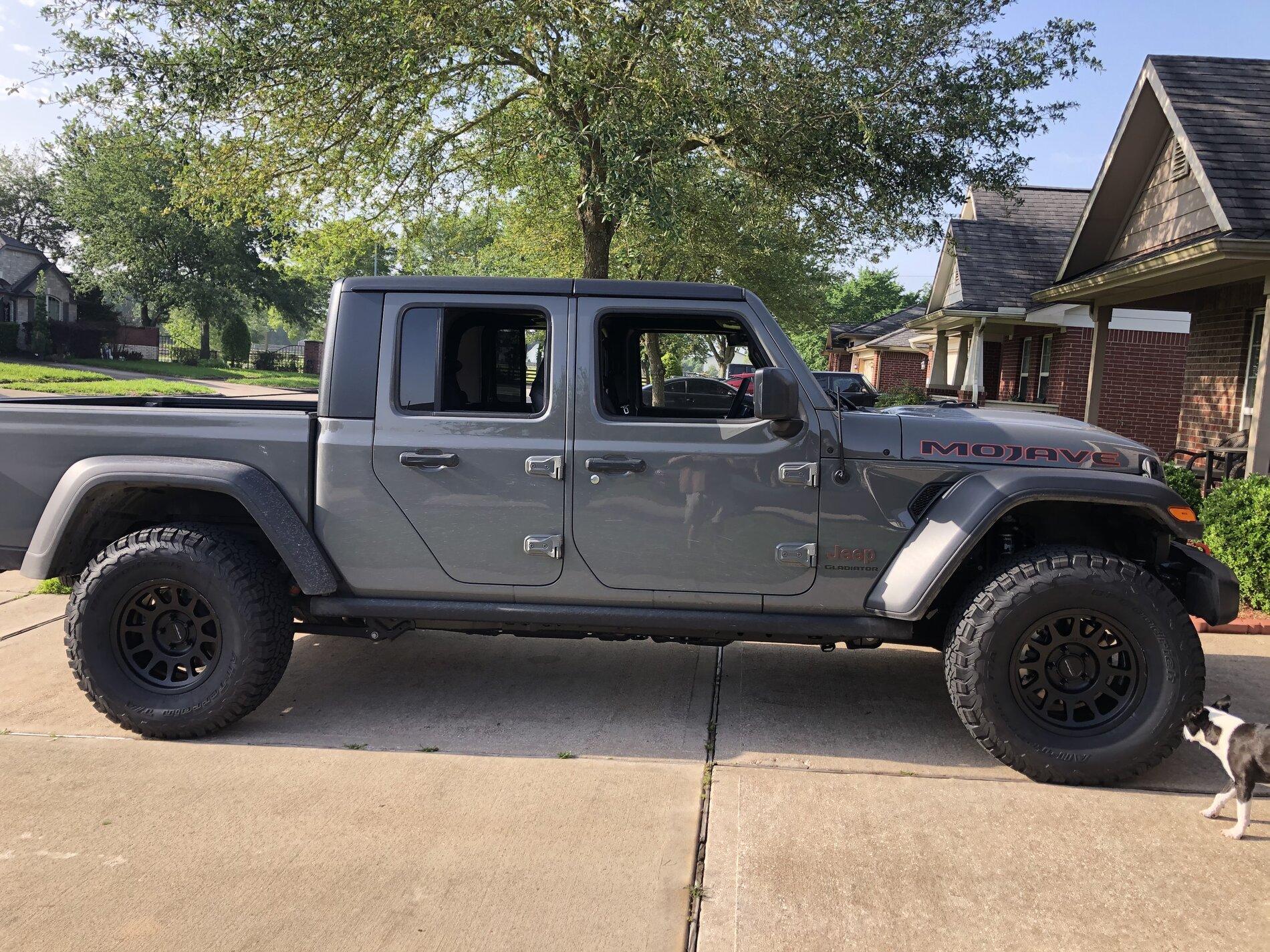

same here.. had a good noise, wear and traction ratings.. I have previously religiously used toyo MT's 35's and 37's..
The wheel and tire combo looks great, exactly the look i have been after for my JTM, what make and size are they?

Thanks @kooltoys! Are you running spacers as well as it looks like there is a nice bit of poke as well - or just the wheels and tires standard?
no spacers, no poke, 1/2 or so maybe... just not my style.. factory 20's are 8" wide, most other stock jeep wheels are 7-7.5"

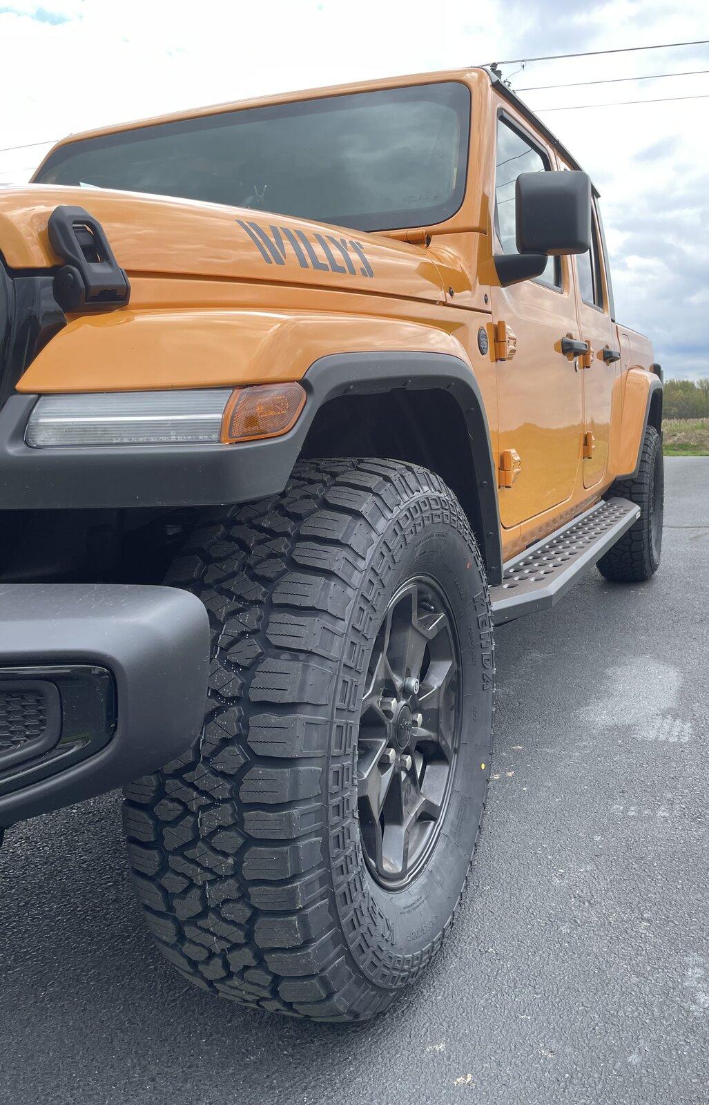

35/12.50/17 Grabber ATX's. Love them
