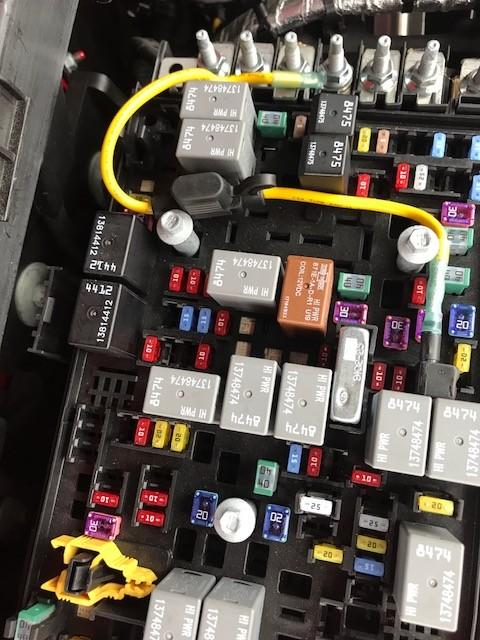

Just a heads-up... I have the aux switch group and tried using the battery wire that is included at the passenger foot board and the unit generally worked until I used the remote to simultaneously close 4 windows ... this repeatably blew the 10a fuse for this circuit ... for those not wanting to go through the firewall, here is an alternative that turns the lighter from acc to battery and then taps that (I just placed my order so I haven't installed it yet
https://www.cooltechllc.com/wrangler-parts-accessories/111-jl-powerport-kit.html
and then use
https://www.amazon.com/dp/B087T2W99F/ref=cm_sw_r_cp_apa_fabc_Z.BZFb38KKVH1?_encoding=UTF8&psc=1
To tap into the lighter
I found this when looking at what people have done to power their cb radios ... and this changes the lighter to always on which I have been wanting anyway
Although the 12V cigarette lighter has a 20 Amp fuse in the Jeep fuse box, the wiring harness from Amazon only has an inline 10 Amp fuse. So this seems to be the same as tying into the 12V input on the Aux switches (also rated for 10 Amps).
So as it stands, this solution would not work either unless you replace the 10 Amp fuse with a higher rated fuse. This got me thinking...
The 3Wliners wire running to the battery isn't labeled but appears to be 18 AWG stranded wire. I determined this by measuring the diameter of an individual wire using calipers then counting the strands to calculate the circular mil area (0.008^2 * 27 = 0.001728). This means this wire can only carry ~ 6 Amps of continuous current, which is odd because they have a 25 Amp inline fuse on this line. So the reason the 10 Amp Aux fuses were being blown is likely the momentary inrush current that occurs when the motor is started or when it encounters a load (window fully closed).
Something else to add is the Amazon wire harness also uses 18 AWG wire, although it visually looks thicker, it's just thicker insulation. The wire is clearly marked.
The 3Wliners instructions say to connect the power to the main battery, hence the 25 Amp fuse. If we connect this instead to the 12V cigarette lighter, the voltage will go from the battery, through a 20 Amp fuse (in the fuse box), through a 10 Amp fuse (in the Amazon wire harness), then through a 25 Amp fuse (3Wliners inline fuse), and ultimately to the window motors.
If you decide to connect this way, it's probably safe to replace the 10 Amp fuse with a 20 Amp fuse, even though the Amazon wiring harness instructions explicitly say do not replace the fuse with a larger value. Just don't run anything else off this Amazon wire harness connection. Also be aware an issue could arise if you have something plugged into the cigarette lighter that pulls additional current. In that case, (depending on what's connected) the 20 Amp fuse in the fuse box could blow when you go to raise/lower your windows.
The bottom line is the wire they're using can't even support 10 Amps continuous current (much less 25 Amps), so the fuses are intended simply to guard against transient currents.
If anyone sees something that looks off, please let me know.
Of course, all this could be avoided if you just run the 3Wliners power wire directly to the battery as instructed. ?‍♂
*** As with anything: if you do decide to go with a higher fuse rating, do so at your own risk. ***
A few quick points to expand on your observations
1)3Wliners and the Amazon harness are the same gauge (but the 3wliner is significantly longer if you run it to the battery so will have higher resistance and a lower current rating) ... thus the amazon harness should be the lower resistance option
2) I completely agree that the risk is a high draw from the lighter at the same time as the windows are actuated ... for a single data point, I have yet to blow mine since using this install with a dual high rate phone charger continually connected with 2 phones often being there
3) I completely agree with using caution when adjusting fuse ratings. One other point to consider is that a well designed automotive circuit should have its fuse as near to the battery as possible
