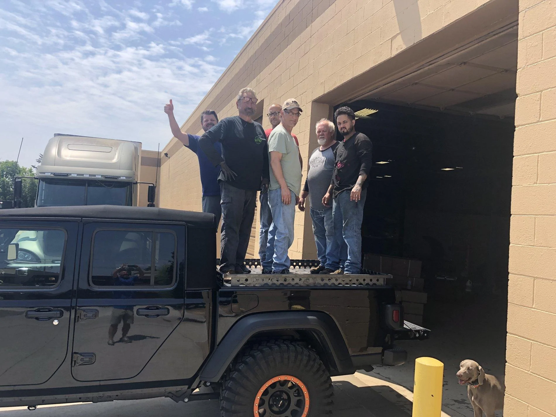

@ACE Engineering, I noticed in the some of the videos that when lifting up from one side, the deck likes to sag to the other. How solid is the centre of the deck? Have you thought about adding structural support to the underside of the deck? U-channel ribs comes to mind.

It's very solid, we don't see any need to add center supports or ribs. Here's over 1,200 lbs without it budging at all.
Jeep Gladiator JT Gladiator Upper Decker Hinged Cargo Basket Now Available! Standing on

I agree with the guys from Ace...when I first unpackaged it, I noticed the flex and it does flex when lifting it, but when it is sitting on the bed rails, it is very solid, no flex or noticeable bounce anywhere on the deck.

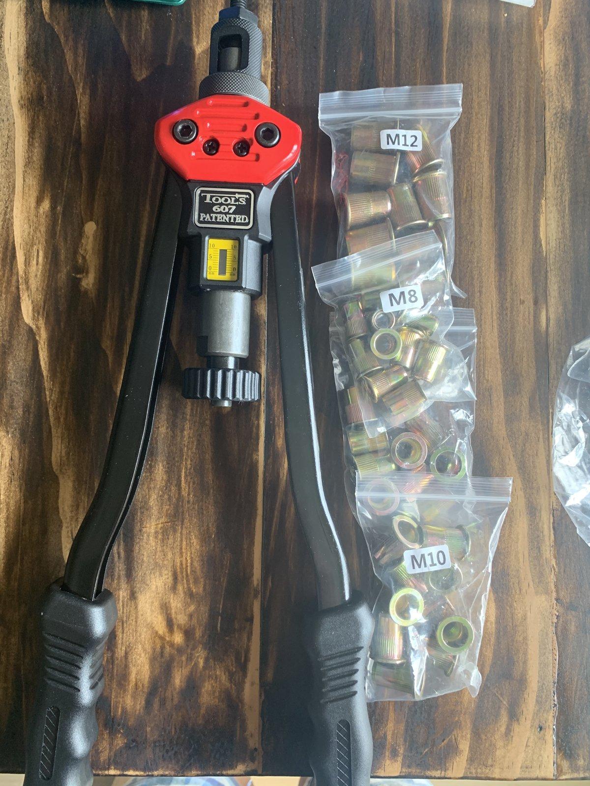

Nutsert tool arrived. Now just waiting on the Upper Decker. Hopefully it’s shipping soon.
My tool worked great...wish I had it 5 years ago when I put Metal Cloak fenders on my JK!! The whole "stroke" calculation is a bit hard to figure out. I don't know if I was setting my took right, but I just left the setting pretty much centered for the first crimp and then like the video says, turned the knob a few twists and crimped again. It worked fine for both the M5 and M4 nut rivets until I busted my M4 mandrel. It's good you have the extra rivets...if you bust your M4 mandrel, you can always open the holes and go M5 which is waht I will be doing soon for my cam latches which I only have held in place now with self tapping screws.

yeah I've heard a few people saying the m4 mandrels don't really last
