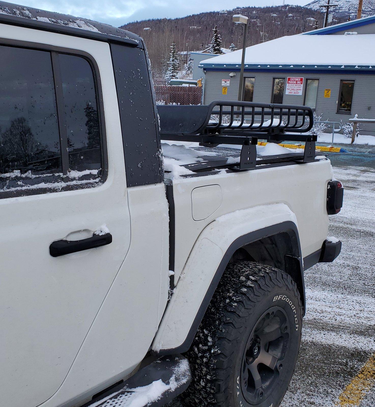

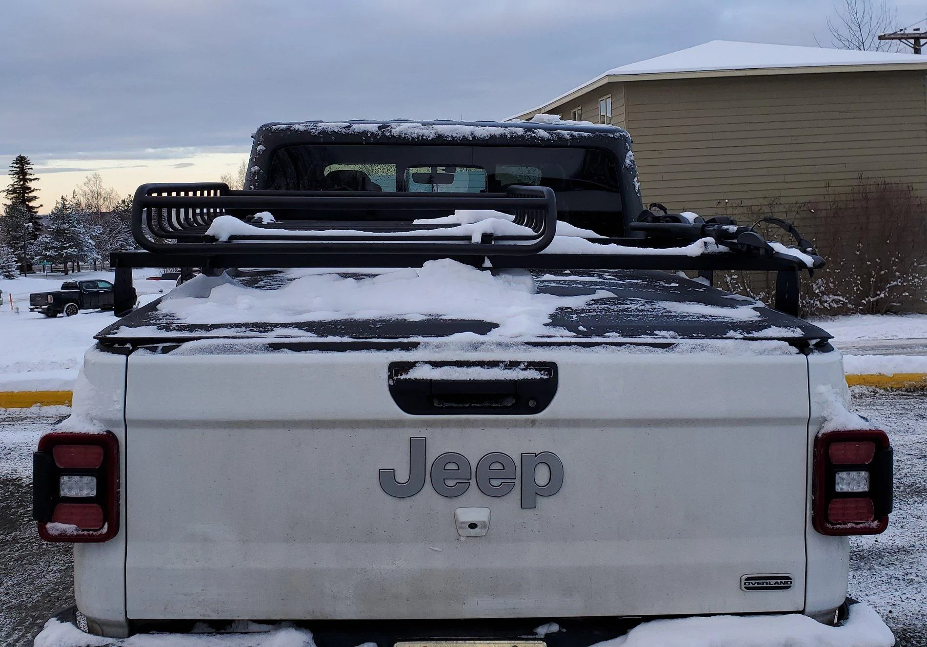

Ok... here are the final shots after getting my Yakima cargo basket installed. I didn't have to modify the attachment hardware using the brackets that came with it. I did have to slide the rear crossbar further back to accommodate the rear basket brackets. It did extend further down making it a little more difficult to roll up the cover, but still doable. I kinda had to rush it though the install since it started dumping snow, but i think I like it close to the left side to make it accessible as well as allows me to step up to the front when in the bed for loading/unloading.

Looks great!
Yeah Thanks. I'm glad I was able to find a system to let me use my old hardware. What's nice about this set up in my gladiator vs my old g.cherokee is I don't need a ladder anymore to be able to load and unload my bikes and other camping gear.

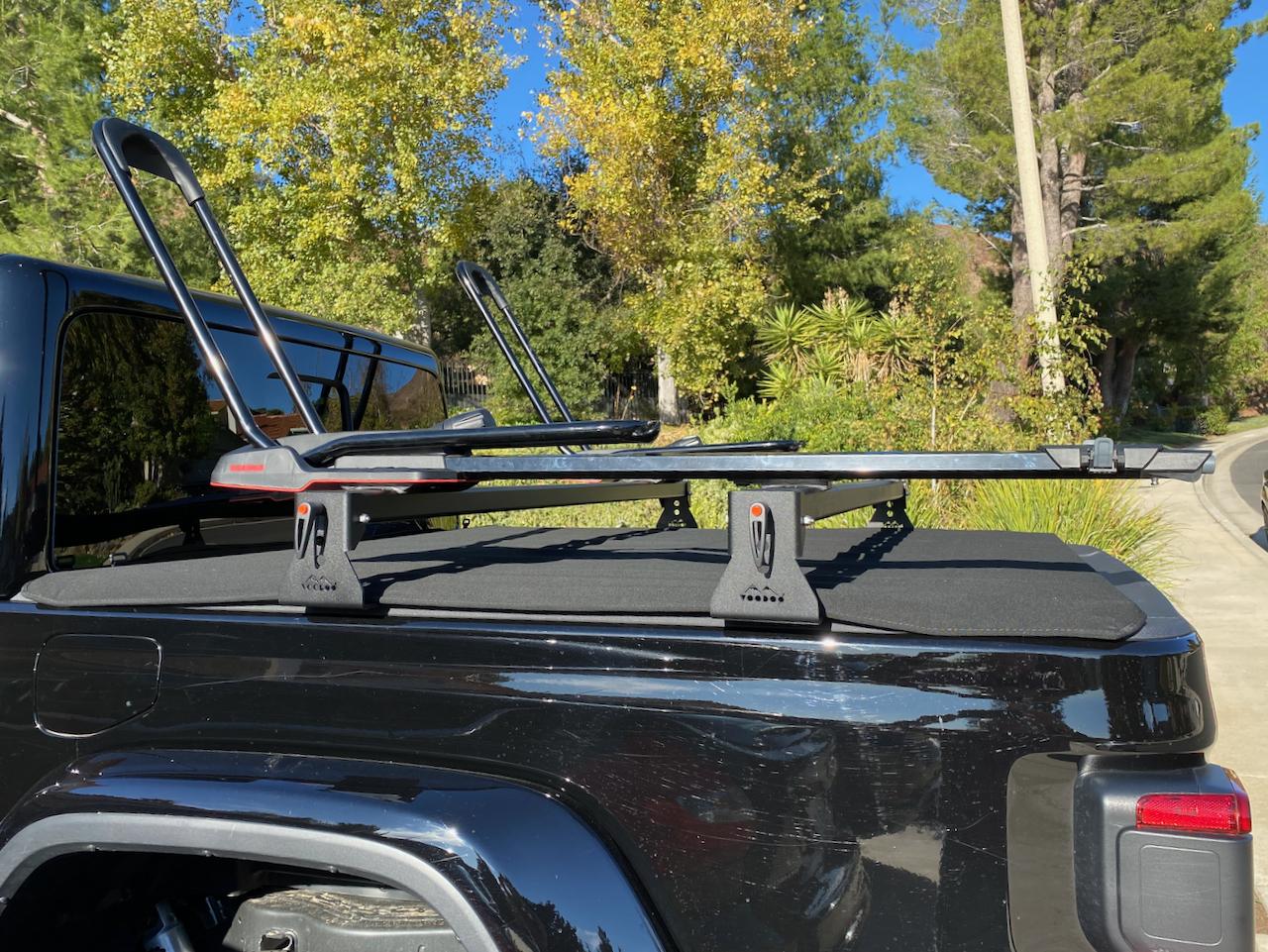

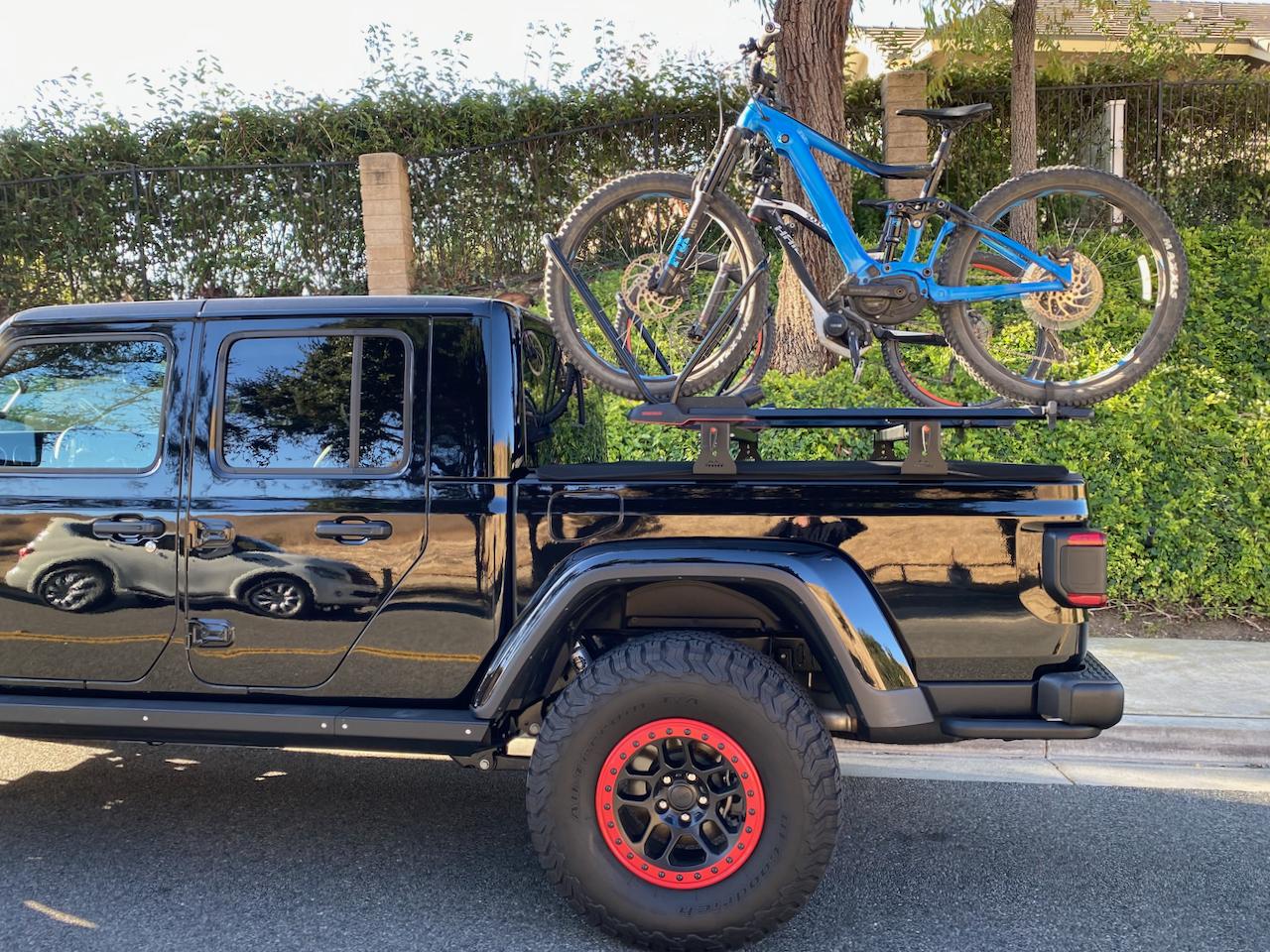

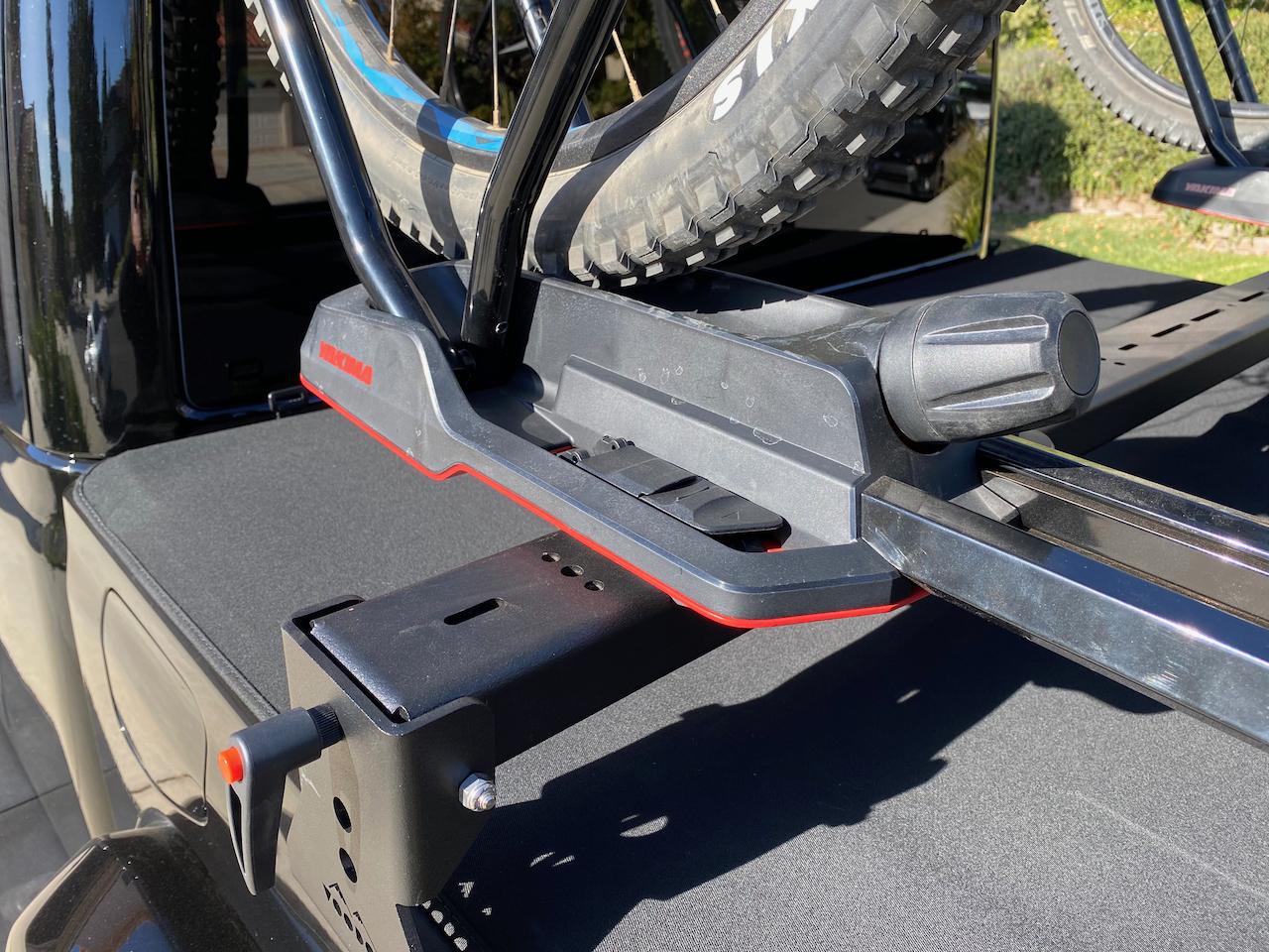

i was just gonna ask the same looks great .... anyone have an idea of what bike rack would attach those these rails ?

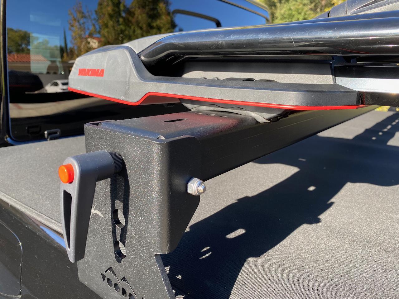

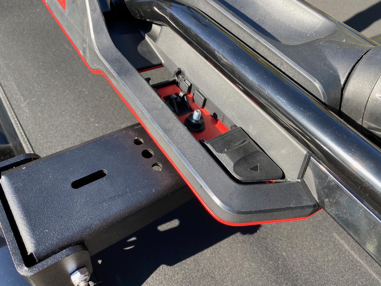

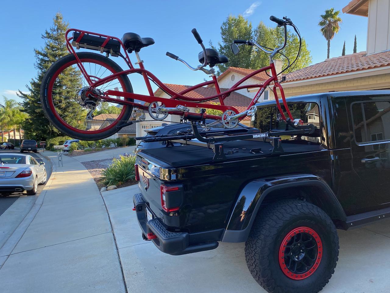

This is the Yakima HighRoad Bike Mount. The straps aren't long enough to use with the Voodoo crossbars, so I ordered the Yakima SmarT-Slot Kit 1. I replaced the t-bolts with regular bolts and inserted into the crossbar slots from the bottom and attached with the supplied nuts. The kit includes a handy install tool that makes it easy to tighten/loosen the nuts. The Yakima SideWinder Tandem Fork Mount also works, but I need to drill two holes in the crossbar to line up the second hole for the Yakima u-bolt and a second back bolt.

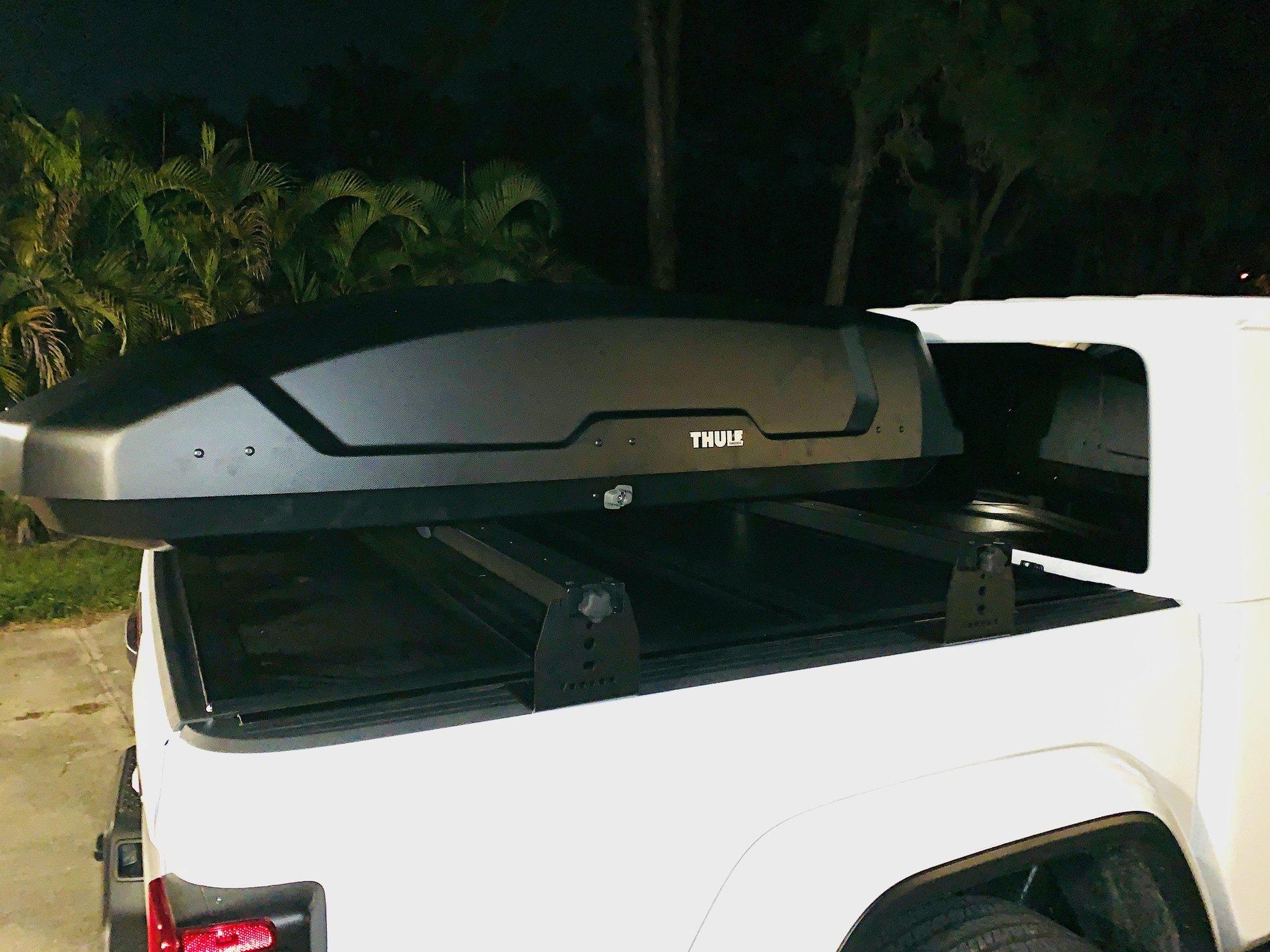

Took a 2000 mile trip with a Thule Force XT (large) mounted on the cross bars. Everything worked perfectly. The bed stayed dry despite near constant rain on the second half of the trip.

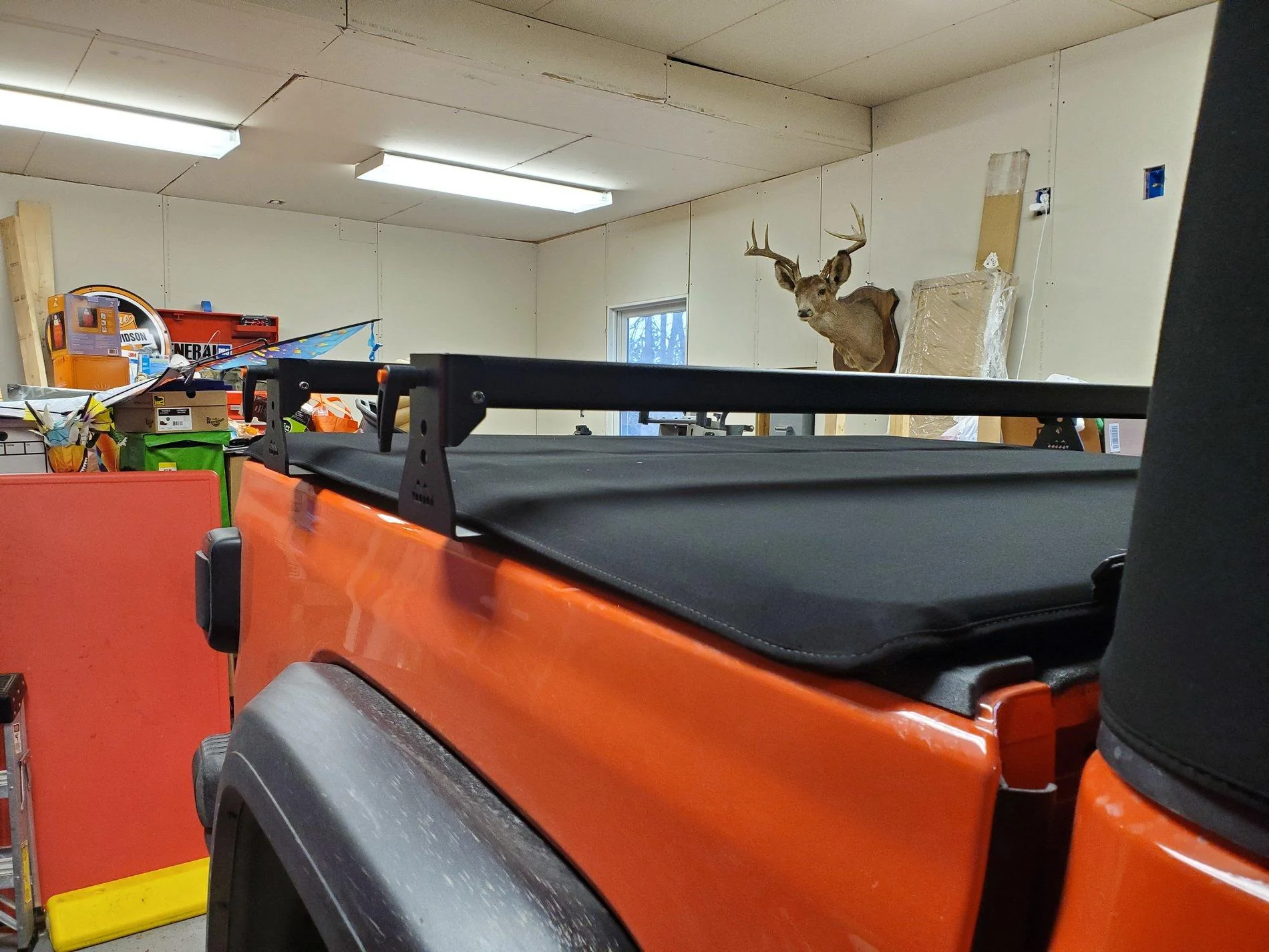

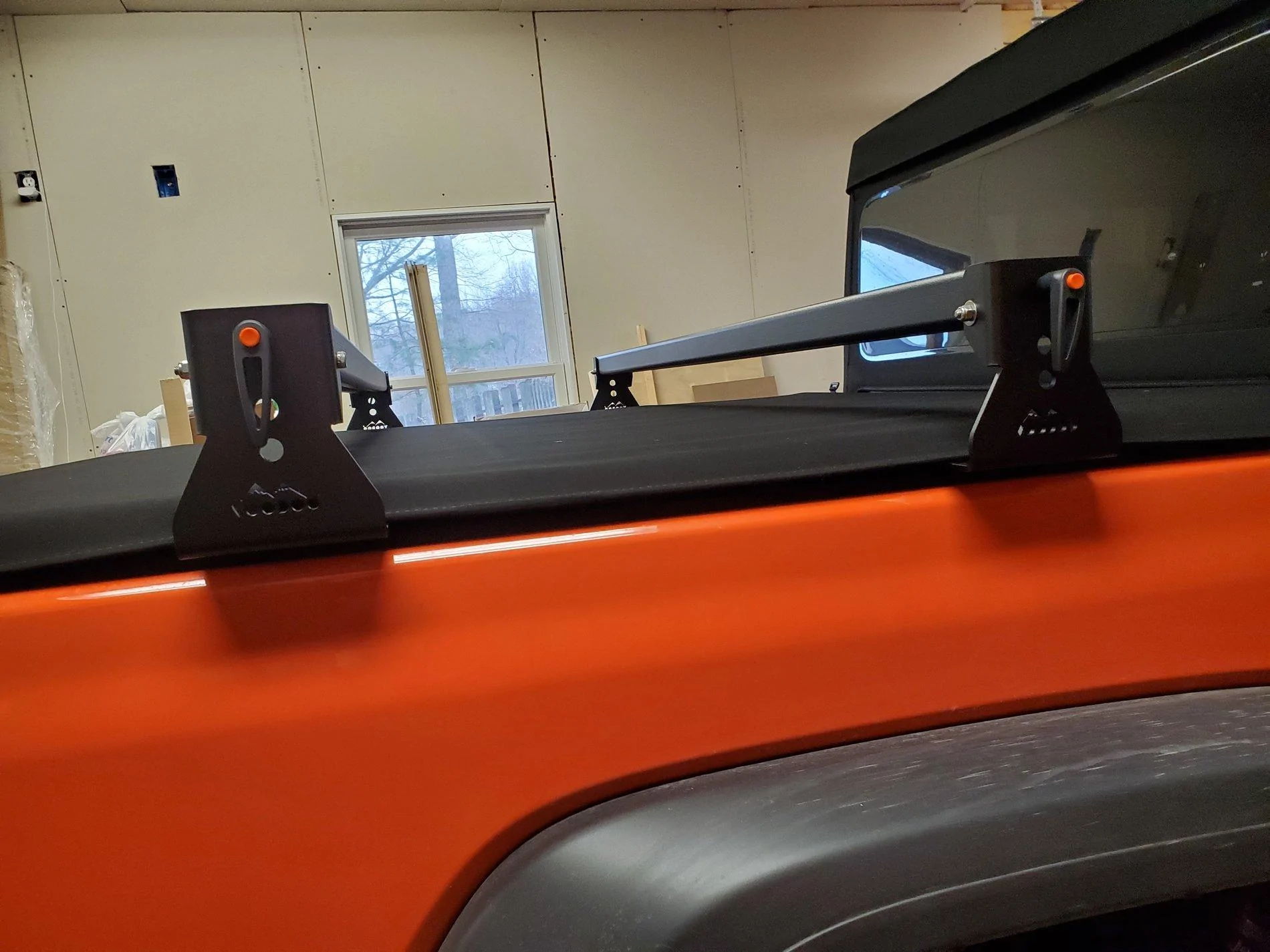

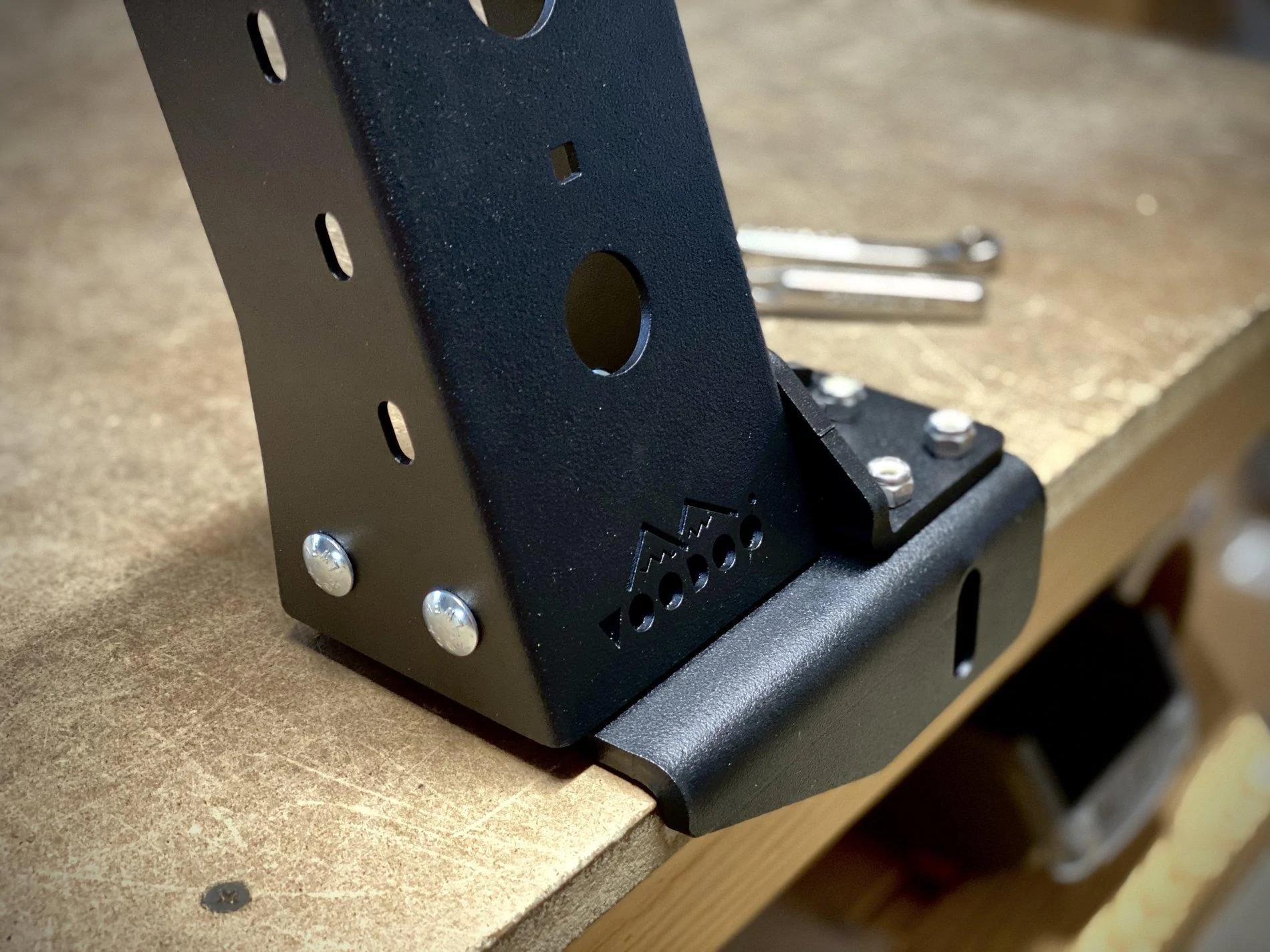

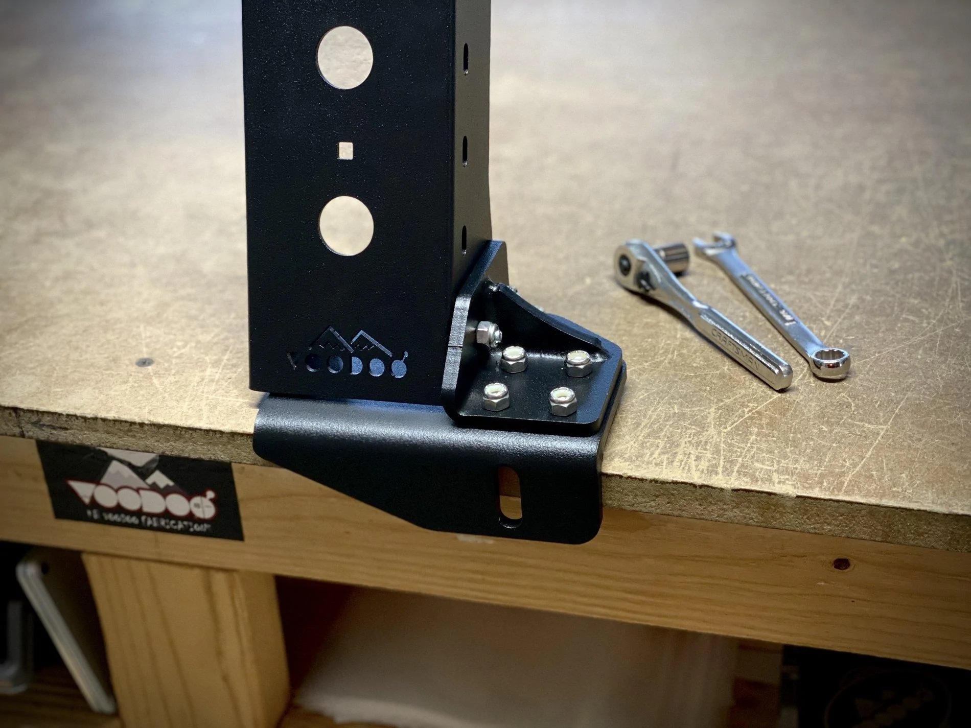

We fit up the brackets for the factory tonneau covers (with temporary hardware, not the nice stainless stuff that we ship with them).
These things are BEEF!!
Ready to order now: https://www.max-modular.com/shop-max-modular

Product looks great! Close to pulling the trigger. Could you possible post a pic of how it looks mounted to the Gladiator with the new "factory tonneau" brackets? I'm having trouble visualizing how the rack will sit. Thanks!

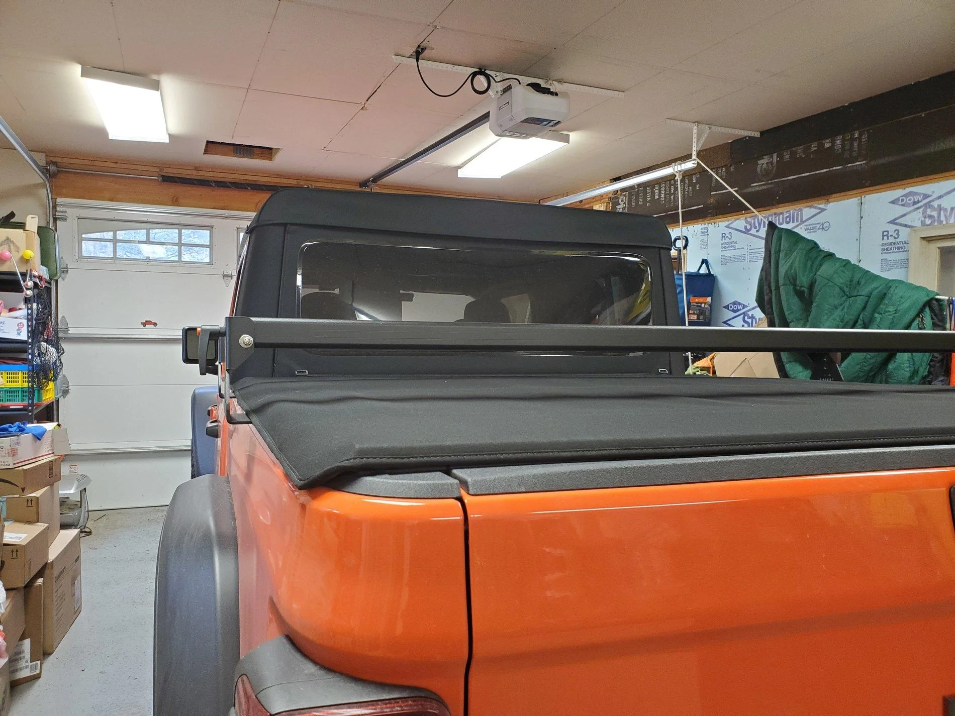

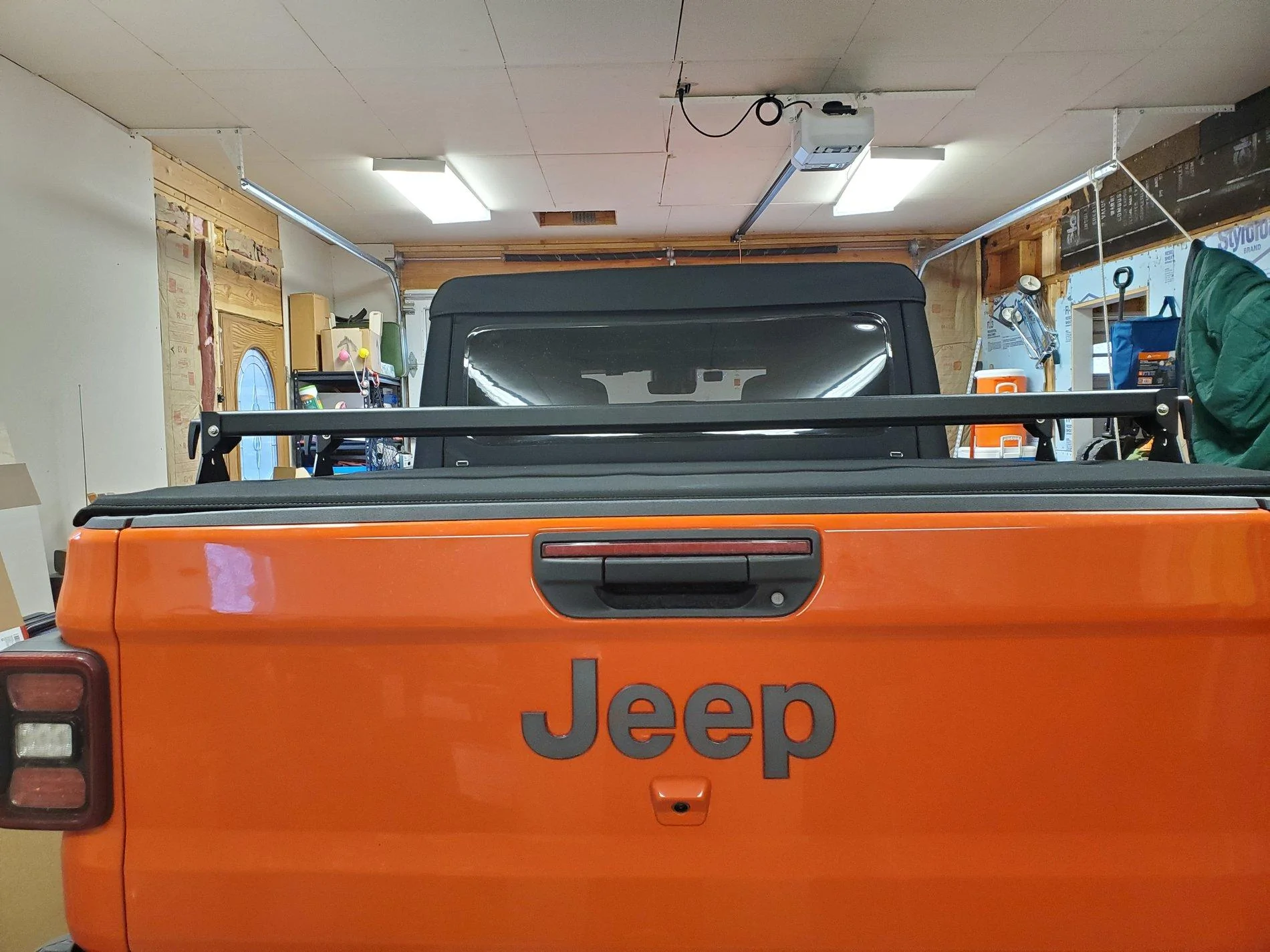

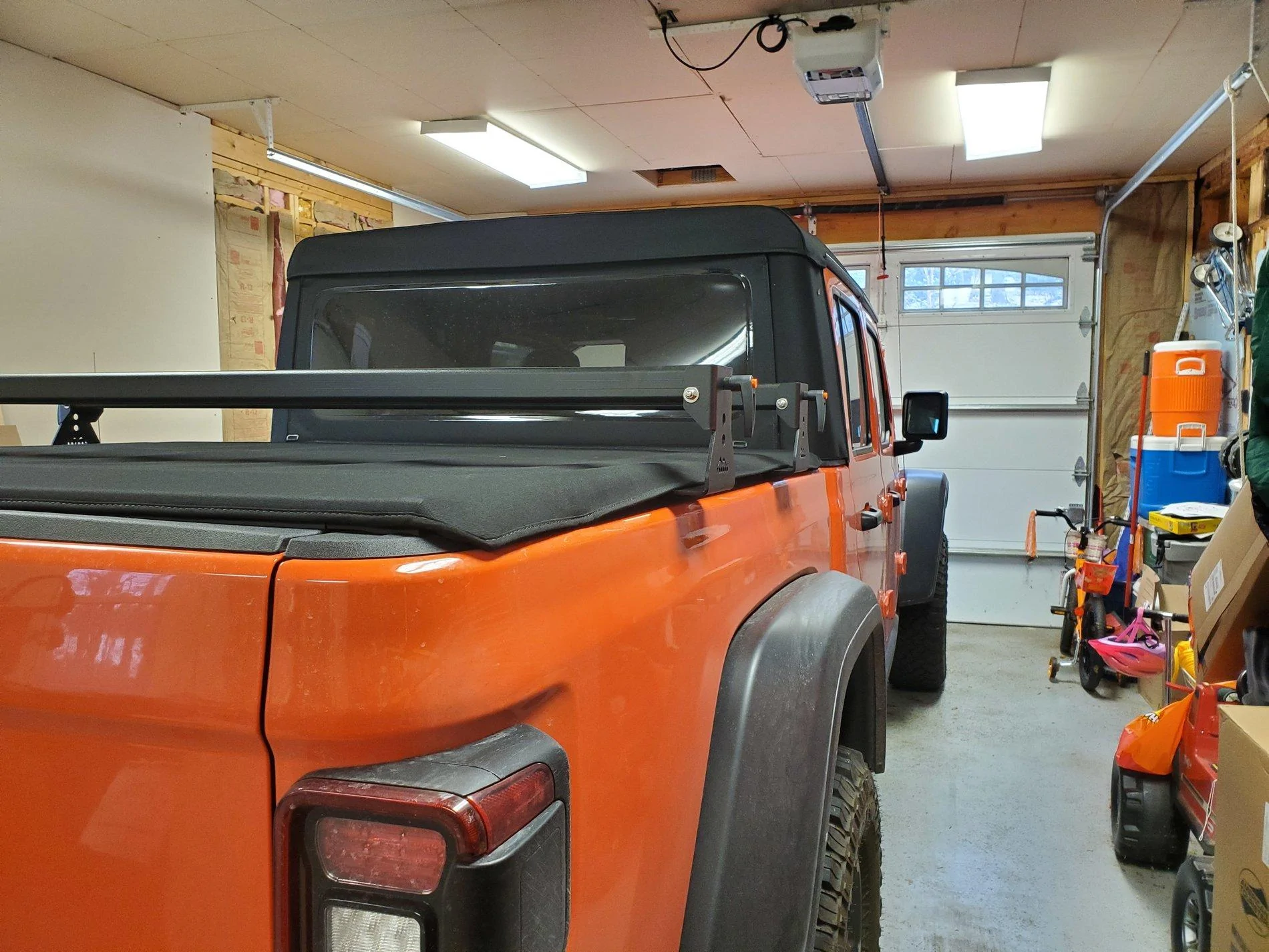

I installed a set of the cross bars this weekend. There were no instructions. If you are use to putting things together and how bolts, washers, and nuts should work then it is still easy to do. If you need step-by-step instructions there were none.
The raisers or brackets are hefty and well built. They fit well and all the mounting hardware fits and works well. I got the aluminum crossbars with the quick release handles. The are also sturdy and well made and fit well. Over all, I am very pleased.
We have a cargo box that we used on my wife's SUV. It fit on the JT with these. I also have a basket on order.
Suggestions from what I have seen so far.
1) Add a tool less handle or knob to the bracket hardware so you can loosen and adjust the position or remove them easily.
2) if the brackets were just a bit taller, an inch or 2 at most, the rolling tonneau cover will roll up or unroll under it.
It is a nice product and I think it will work well.
