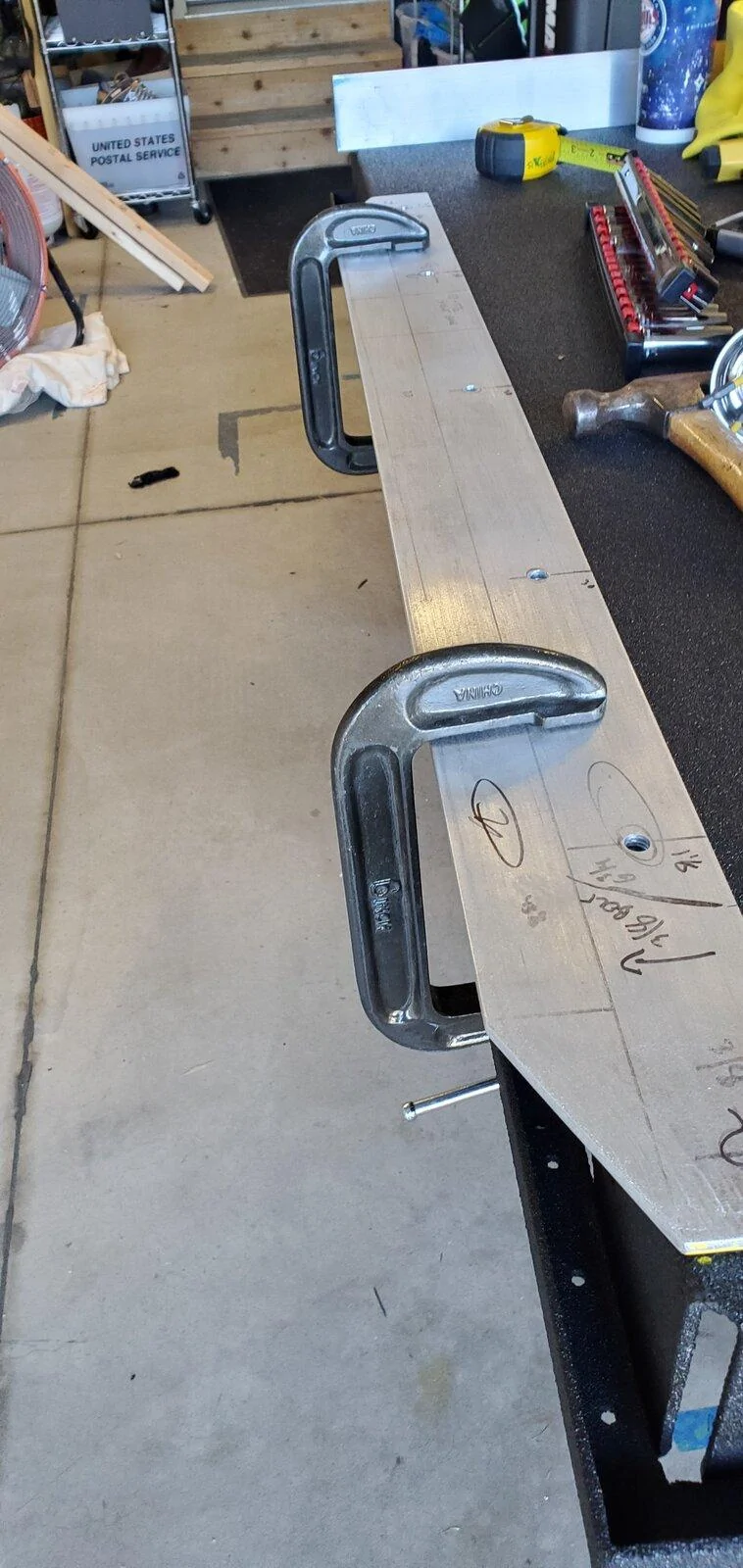

This is the 1/4 x 4 inch x 48 inch aluminum sheet I am using to spread the weight onto my bedrails. Upper decker is upside down in the photo and bedlined - in case you are confused about orientation. This photo is taken from the back looking to the front. I wil by using 3/8 stainless machine bolts with nylock nuts to bolt the plate to the upper decker. I drilled holes in the AL plate first then marked locations and drilled through the steel UD using a small drill bit and then a high speed metal drill bit (conical shape - not sure what they are called but they go through the UD like butter and don't heat up the metal too much)

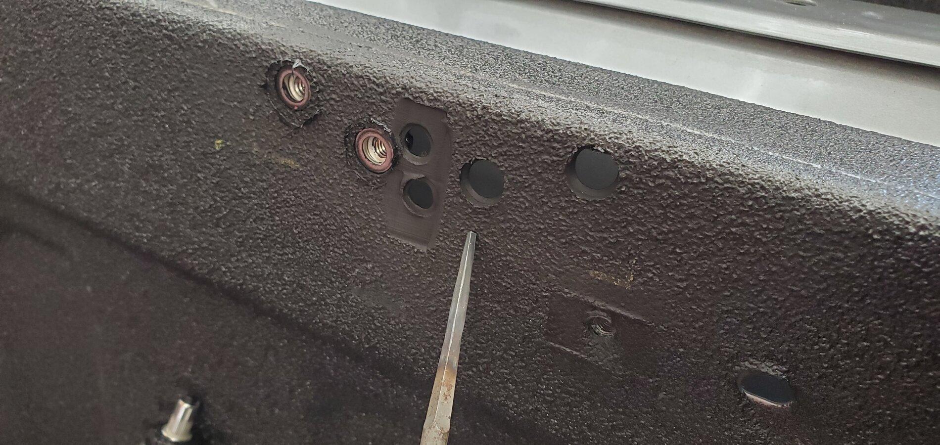

This picture is after I have drilled through the back of my bed for the hinge bolts. Old bolt holes are in the middle (I drilled out the two original nutserts, primed all the bare metal in flat black and am using black silicone adhesive on the NEW 1/4inch stainless nutserts to limit any rust at the holes. Pro tip if you are using nutserts on a bedlined surface. You don;t have to scrape away ALL the bedliner around the holes. Just use the next step on a conical high speed stepped metal drill bit to carve out some of the bedliner - the nutsert will get forced into the vacated space and make a nice tight looking join. I used Permatex black silicone adhesive on the nutsert and you can see some of it surrounding the freshly installed nutsert. I wiped it smooth after taking the photo. The rectangular indentation in the bedliner to the lower right is the factory hole for the Trail Rail - man that was a PITA to peel off.

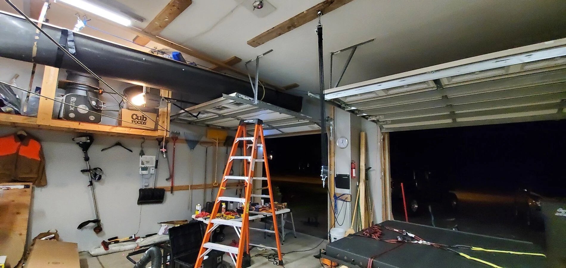

Last photo is the manual hoist - $20 on amazon. Interesting product but it doesn't work for me. My son (12) isn't strong enough to lift the upper decker with it and I can't maneuver and hoist at the same time because you have to pull sideways thus moving the load while lifting. SO - I am getting a cheap harbor freight style electric overhead hoist with a wireless controller. I bought an 880lb version with a wireless controller on Amazon for about $250 delivered. We'll see how that goes.
And yes - my garage is a bit of a disaster - 3 different projects going on at the same time and too damn hot to work in the afternoon now... My Rockhard 4x4 angled down rails are in the box and underneath that table in the background are 4 tents that I need to repair for my scout troop before this weekend. Sigh...
