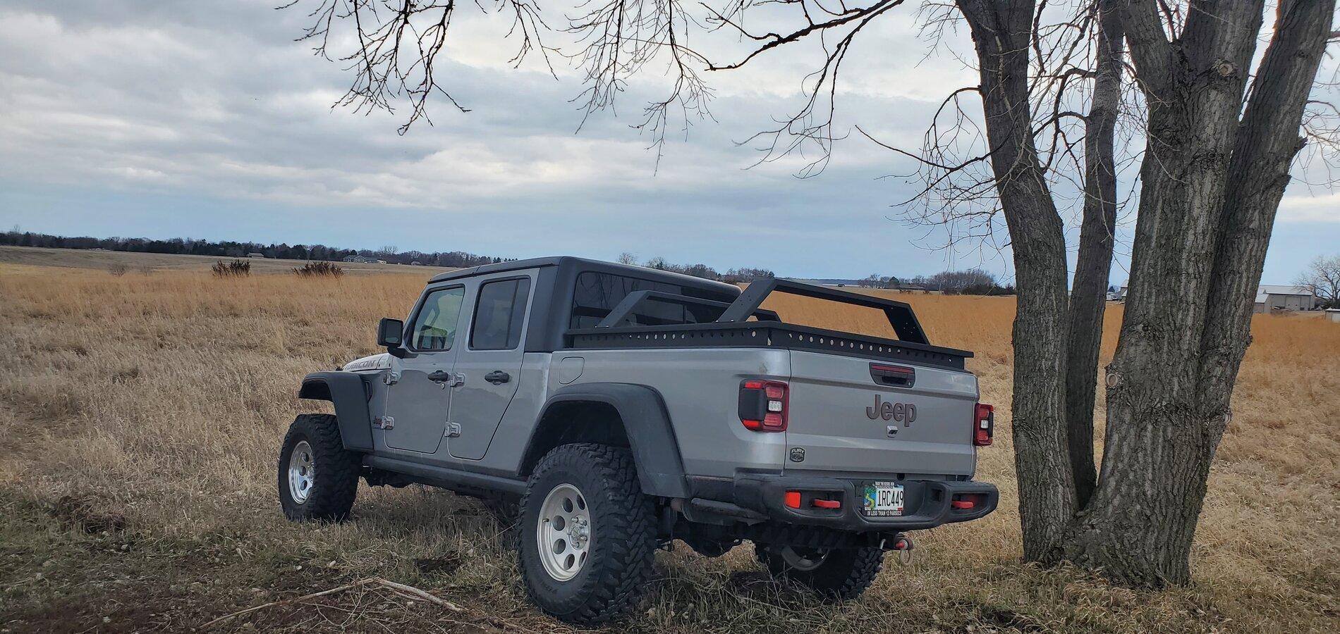

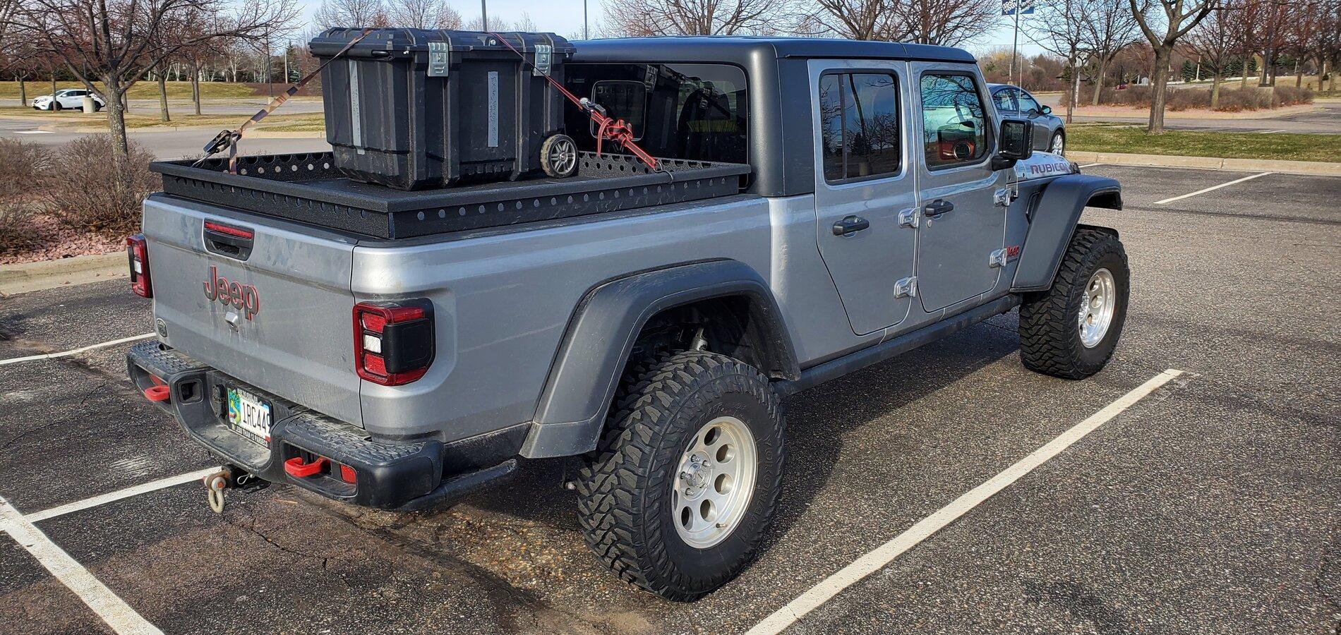

No fancy photos yet but here is what I have so far. @Pat2Alaska is the MAN and such a nice and knowledgeable guy! Plus he was so cool to my son and had him helping out and everything. Thanks PAT!!!
PS for size reference the middle picture has 2 65L backpacks (training with my daughter for Philmont) and the bottom picture has the largest size Husky mobile tool box (37 inch model).
The single best benefit (for some of you) about getting an upper decker will be that if you are the kind of jeeper that adds front spacers to even out your stance the upper decker will do that for you without the spacers.

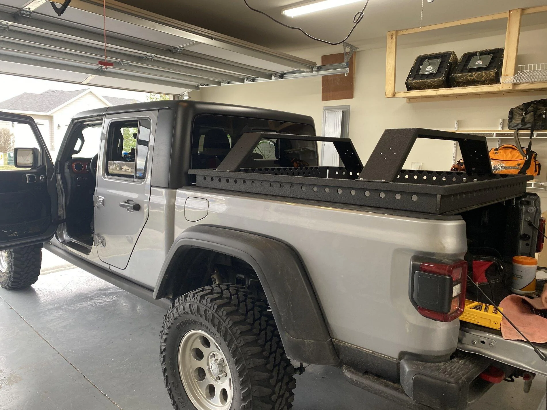

I really enjoyed working with you and your son to install it on your rig! Thanks for coming down! Even though we were pretty busy, I captured this after photo!

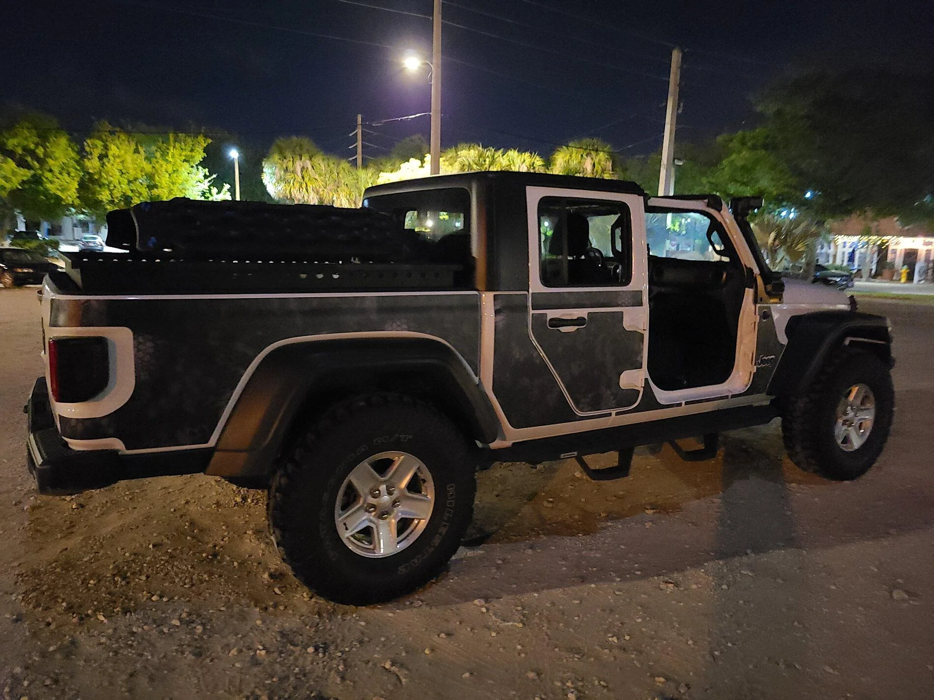

Like I said before, despite the few small drawbacks, I think this is one of the best bed solutions for our trucks. Been very versatile on my end. Still have a few thing I wish to attach and finish the look I have going. If @ACE Engineering follows through with just some of the suggestions, it would be a top product in my book. Still turn heads and get compliments on my end. I think I need that 3/4" rear daystar spacer tho...
Thanks Pat - your garage was awesome!
I agree - for those who can live with an inflexible tonneau cover the upper decker is awesome. Everything about the way they designed the basket is perfect - I just wish I had understood the need for much beefier hinges and latches before drilling a bunch of holes in my bed. If you install using the supplier hardware you quickly realize that the upper decker is not held by much and any significant sideways loads are likely shift the upper decker while on the road. Granted you are putting hinges into the thin sheet steel of the bedside up next to the cab. I'm thinking about a 3/16 inch think strip of mild steel 1 to 1.5 inches wide and held on by clamping force with thru bolts will anchor the bed and the hinge in a much stronger way... no welding. Plus stronger latches.
