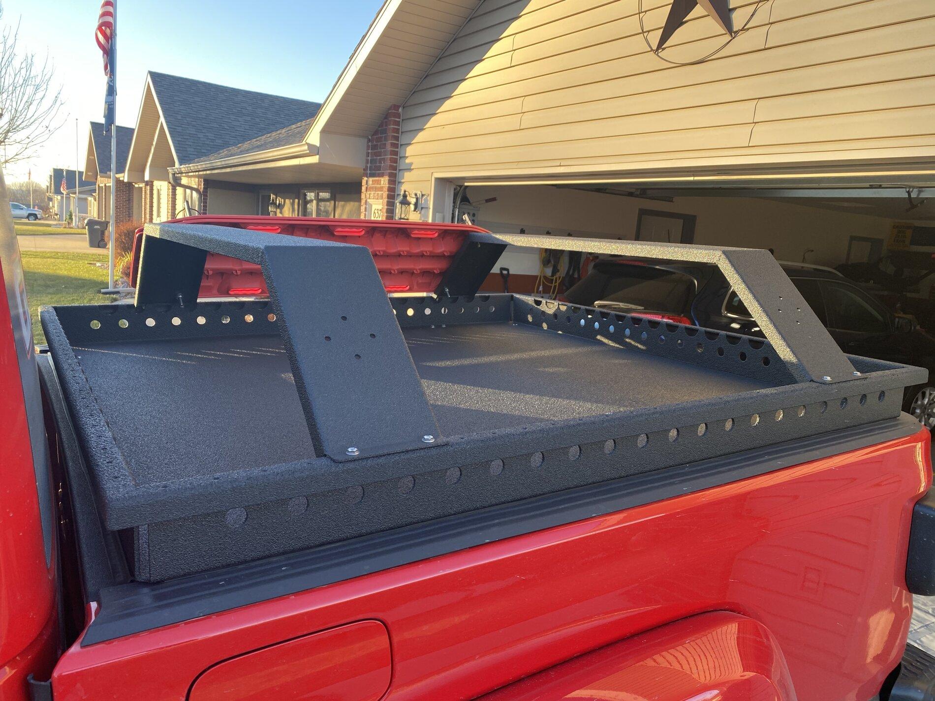

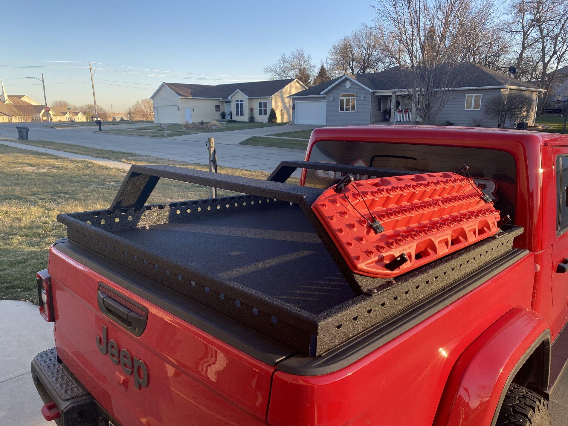

Have decided to sell my Upper Decker with Tent Brackets. I’ve really liked this but need easier access to the entire bed now. This has been fully Rhino-lined and is better than new. Pickup only in NW Iowa. I will help you mount it. $999.

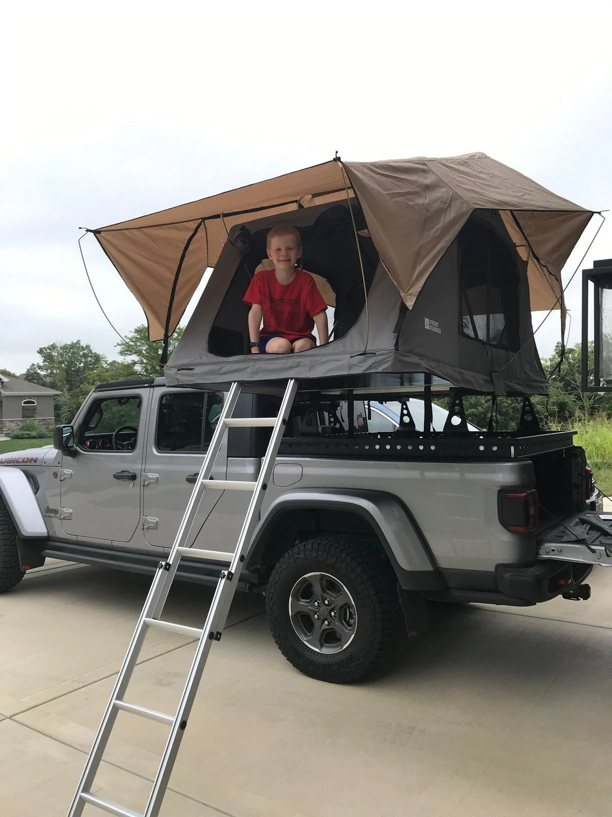

Does anyone have photos of their UD and RTT mounts supporting a roof top tent?

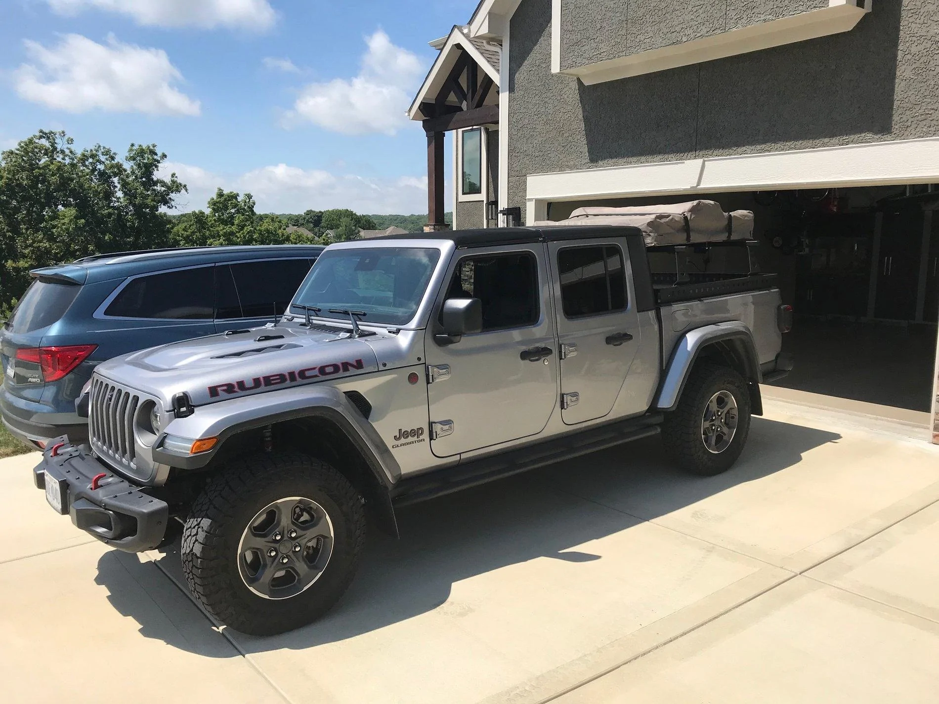

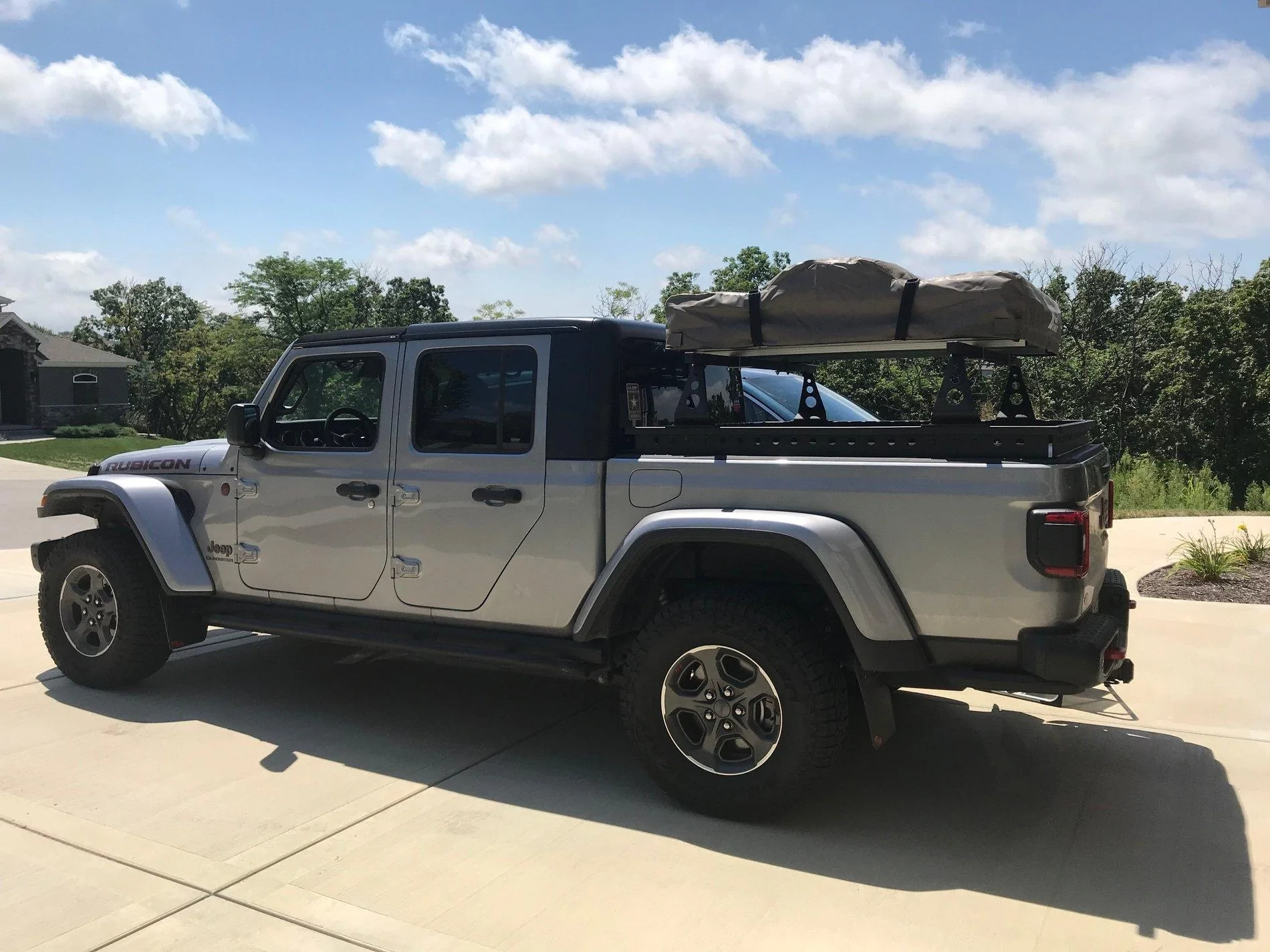

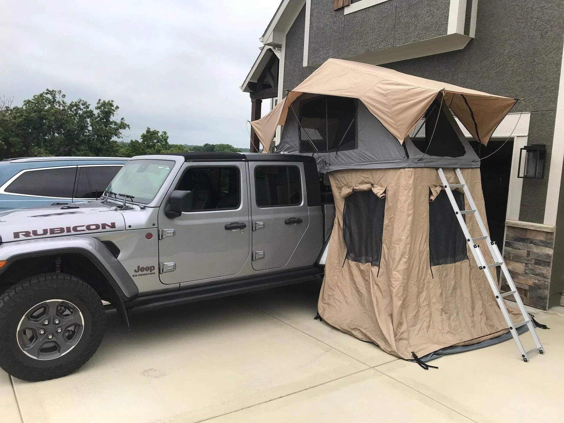

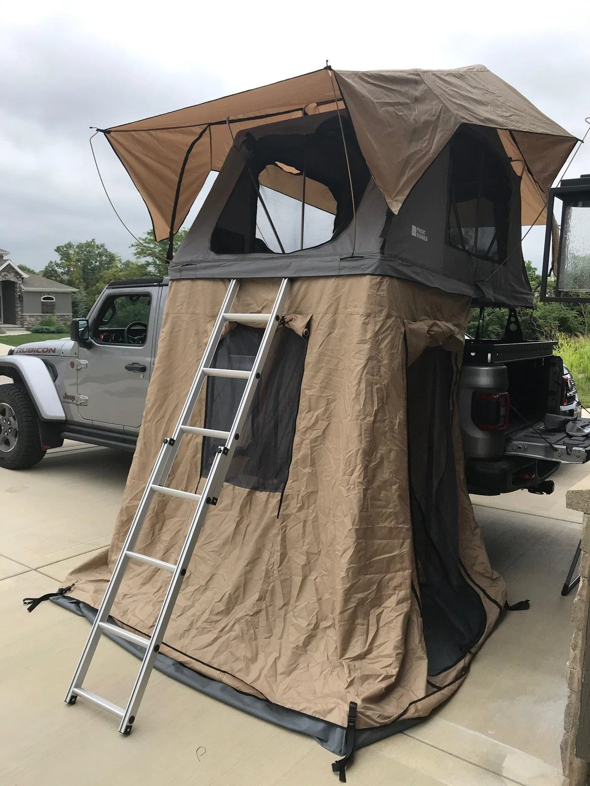

I have the Upper Decker and I made my own mounts, so that I could hold a RTT or anything else I wanted (roof basket, bike racks, kayak rack, etc...)
Jeep Gladiator JT Gladiator Upper Decker Hinged Cargo Basket Now Available! Jeep Tent (Packed 1)
Jeep Gladiator JT Gladiator Upper Decker Hinged Cargo Basket Now Available! Jeep Tent (Packed 2)
Jeep Gladiator JT Gladiator Upper Decker Hinged Cargo Basket Now Available! Jeep Tent Annex 1)
Jeep Gladiator JT Gladiator Upper Decker Hinged Cargo Basket Now Available! Jeep Tent Annex 2)
Jeep Gladiator JT Gladiator Upper Decker Hinged Cargo Basket Now Available! Jeep Tent Opened

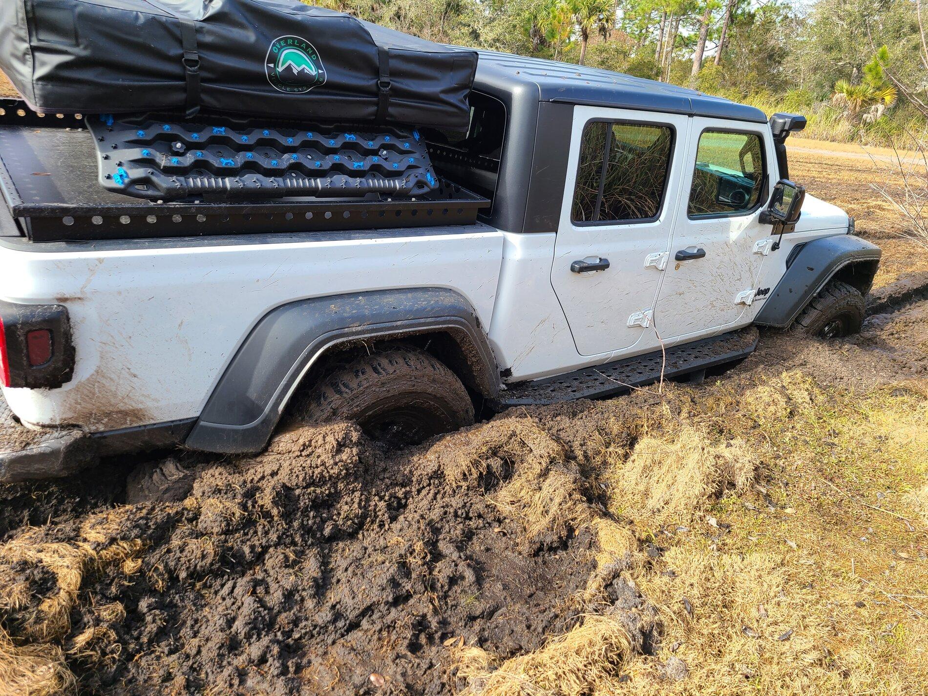

Here is UD basket and mount with rtt. My rtt is a 2 person tent. Bigger ones may hang over the rear a lil. Rtt was not the reason for getting stuck, that was my doing and on purpose lol.
