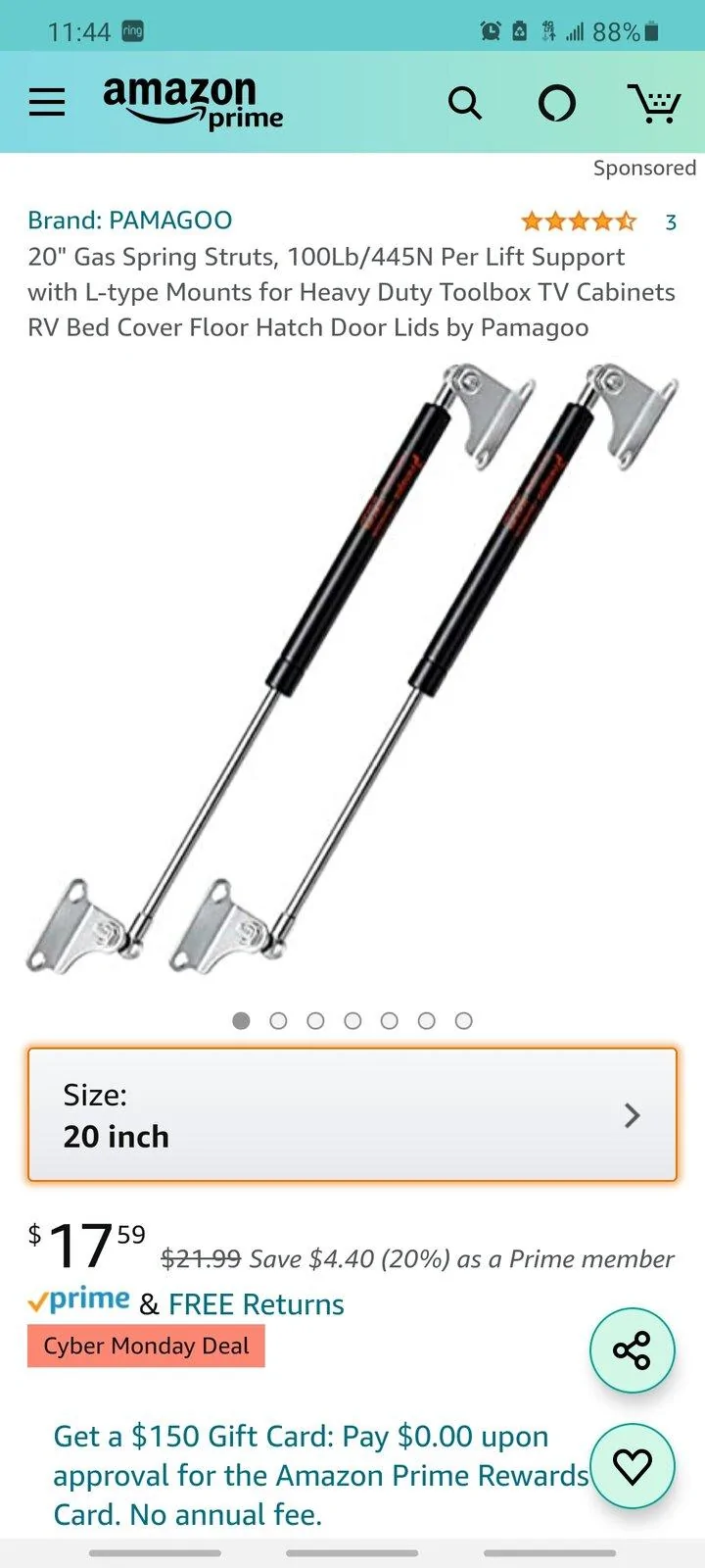

Definitely need something stronger. Wish I could still use that launch code for Free shipping. All their Black Friday sales really did was cover shipping

Looks like they're based on total length, ball to ball. If someone can verify, then it should answer the question on length.

Depending on what you have on your UD, those might not be strong enough. The ones that come with the UD are rated at 85lbs, so these only offer about 30lbs over the stockers for the pair. I'm going to look for some 125lbs struts. I don't mind having to sit on the end of the UD to get it to close. lol
