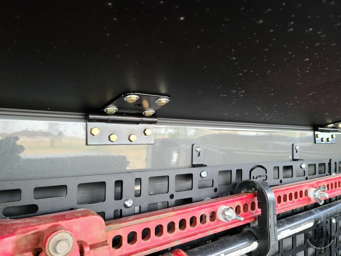

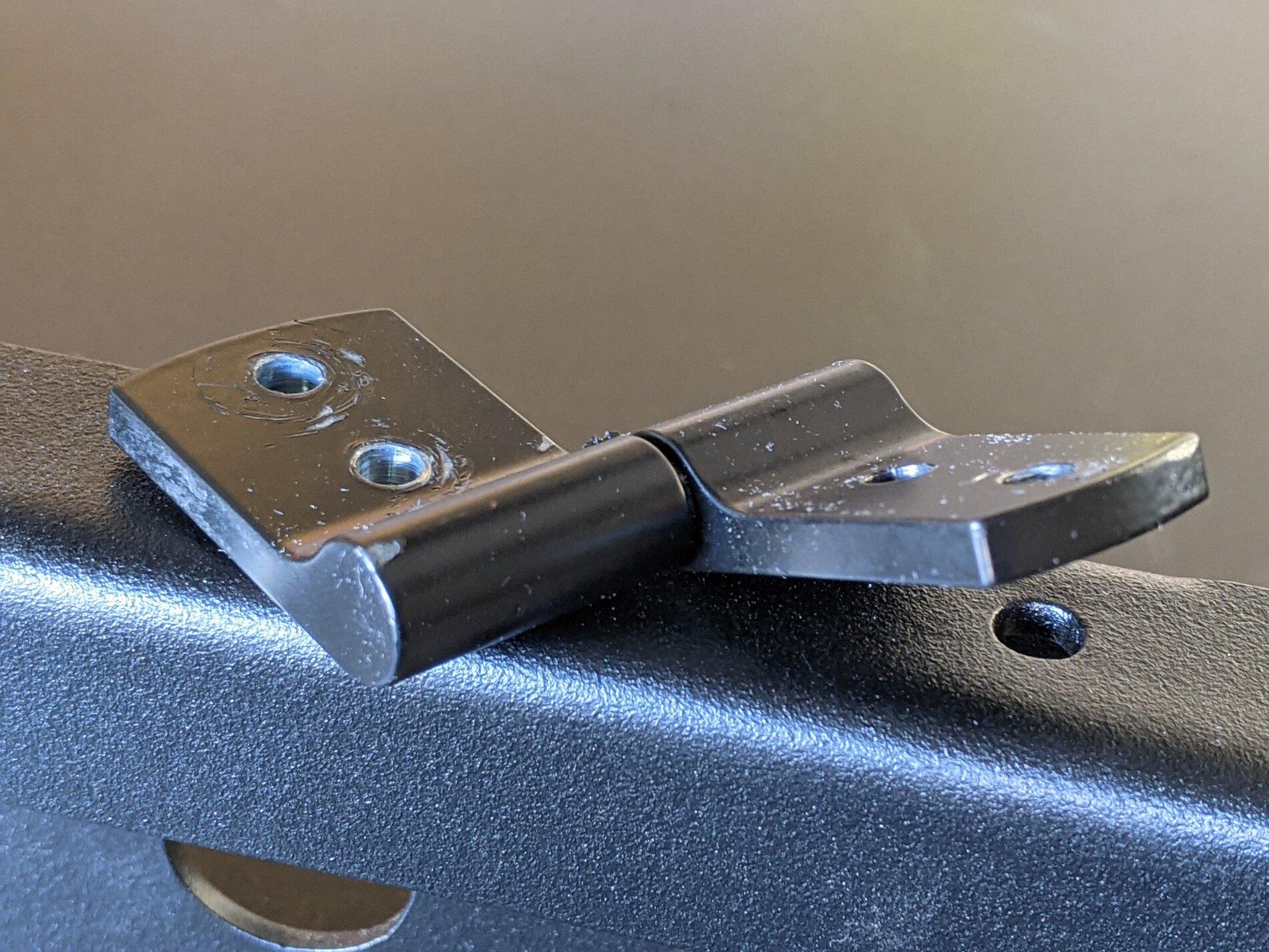

Today, I began installation of my Upper Decker. What slowed me down were the hinges. Does anyone have any tips for how they installed their hinges?
I attached the hinges to the Upper Decker, then used a white thin tipped marker to crawl in and mark the holes on the front of the bed. Note if you have the factory sprayed liner, you might need to cut some extra liner away to get the nutzerts in correctly. Also you might look at my build page as I ended up having mine Rhino-Lined because of finish coming off and rusting issues. It turned out very nice!
Thank you, @Pat2Alaska . Here in Southern California I don't have issues with my Jeeps rusting, but I will likely plan for its eventual rust as I also look at lining the bed going forward.

During installation today, I separated the hinge on the drivers side. I will use some channel lock pliers to fix the hinge tomorrow and see if that works.

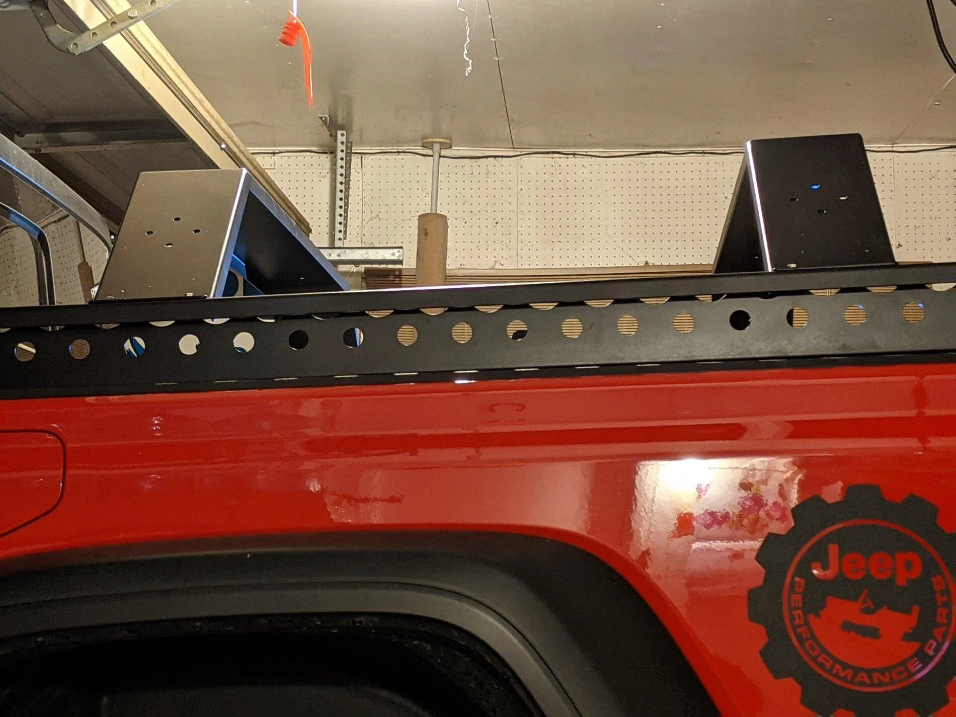

Today, I took the truck for a small shakedown drive out to Joshua Tree National Park. I love this Upper Decker unit. I was able to finally store my items in the bed with everything locked in place. Everything was free of dust and the truck now has a finished appearance. I am very happy.

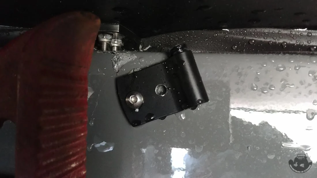

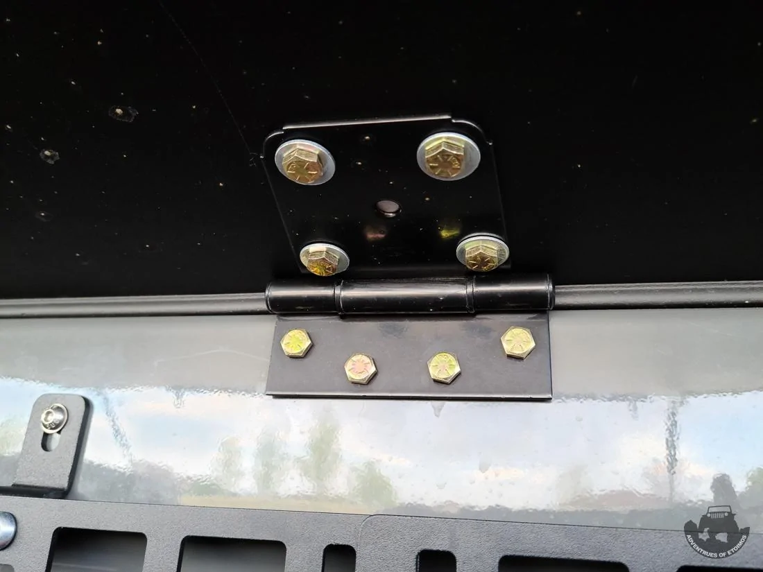

My tip is to replace them with some real hinges.

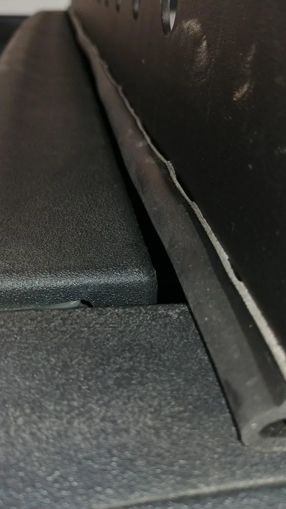

ACE did send my new hardware and seals when I asked for them.
Those hinges do look ALOT better. I rarely open mine, so no issues here, knock on wood. But I'm sure my offroading adventures will catch up to me with tent on top all time

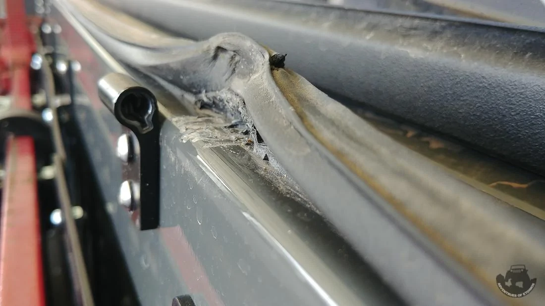

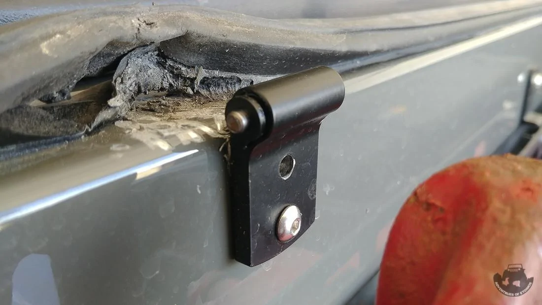

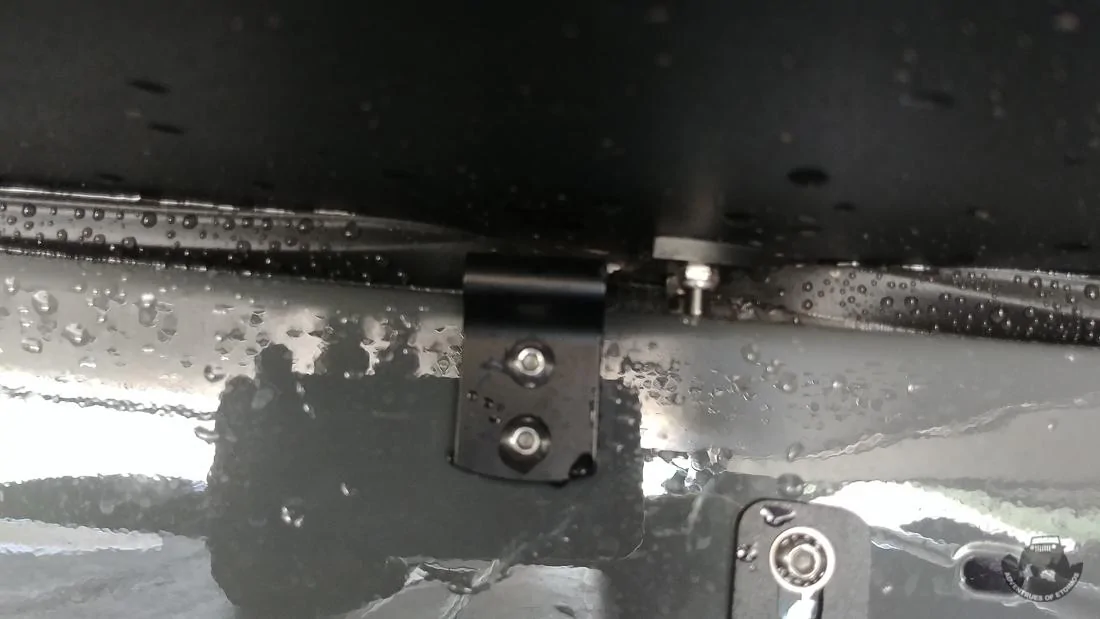

How did the hinge damage occur? @Etoimos
I hit a large pot hole in a dirt road doing 20-25mph after about 45 minutes of driving down washboard roads at about the same speed. The only thing on the UD was some traction boards and some plastic ramps that I use to level my Off Grid Trailer, so no weight on it at all. You can see more photos of the incident and how I got it off my back glass in the field in my trip report.

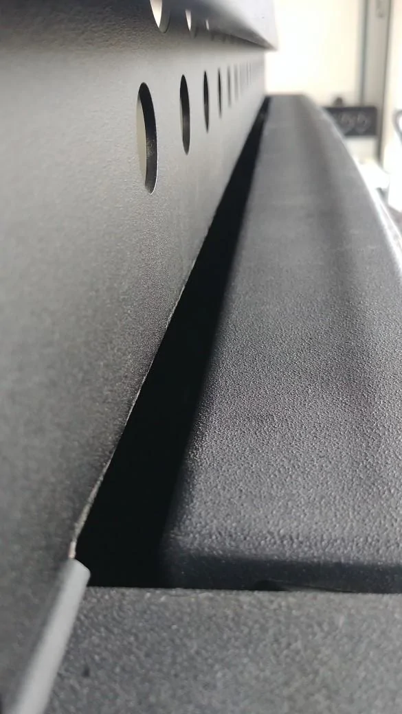

I do really like the UD, but there are a few things they could have done better on it. The hinges are the main thing, but it could have also been about 1/2 to 3/4 inch wider so that it rests on the bed rails the entire length of the bed. Mine was also about 1/4 inch too short.

I hit a large pot hole in a dirt road doing 20-25mph after about 45 minutes of driving down washboard roads.

It is in the post right above yours... but here it is again for quick access. I did not fix the hinges in the field, I simply used a tree to pull the UD back in place (the struts were pushing it forward) and then used ratchet straps to secure it back in place until I got home and could remover it and repair it as needed.
U, myself, and several others agree on the overall dimensions. That and the use of m4 hardware.
Total interior height is a bit of an issue, but this is no fault of the basket. As a tip: stop at a love's/pilot/flying j gas station and pick up an aluminum j hook in the truck section (~$8). This will help grab anything at the front of the bed, so long theres something to hook to.
